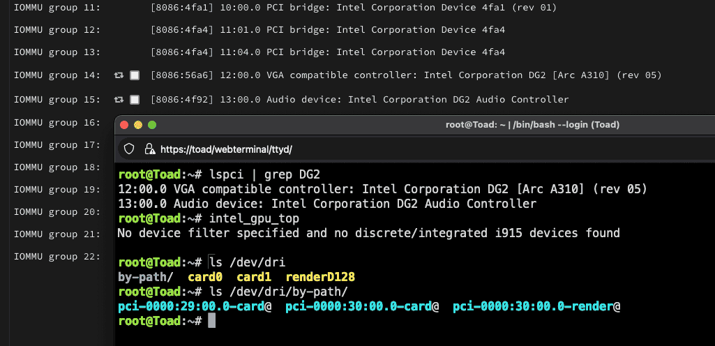

  4. Well, Unraid 7, Beta3 is Alright, but Arc is not fully there yet for me it seems. Card: Arc 310 DG2 Revision 5 - Upon first install, Unraid does not visibly see the card. - Install the Plugin 'Intel Top' for system analysis and it can then see the PCI address, but cannot pull analytics. "Vendor command returned no data." - Swap out Intel card for Nvidia Pascal, Install NVDrivers, and system can see it alright, no issue. - Swap back to Arc310 card and Render 129 is absent from /dev/dri But atleast the card is seen under lspci. - IOMMU group 14:[8086:56a6] 12:00.0 VGA compatible controller: Intel Corporation DG2 [Arc A310] (rev 05) - IOMMU group 15:[8086:4f92] 13:00.0 Audio device: Intel Corporation DG2 Audio Controller (and no, These are not marked for VFIO) - IOMMU group 30:[1a03:1150] 28:00.0 PCI bridge: ASPEED Technology, Inc. AST1150 PCI-to-PCI Bridge (rev 04) - [1a03:2000] 29:00.0 VGA compatible controller: ASPEED Technology, Inc. ASPEED Graphics Family (rev 41) - IOMMU group 33:[1002:1638] 30:00.0 VGA compatible controller: Advanced Micro Devices, Inc. [AMD/ATI] Cezanne [Radeon Vega Series / Radeon Vega Mobile Series] (rev d8) - IOMMU group 34:[1002:1637] 30:00.1 Audio device: Advanced Micro Devices, Inc. [AMD/ATI] Renoir Radeon High Definition Audio Controller So, while it is Beta ATM, progress is being made, but still not 'FULLY' supporting INTEL ARC just yet. -- Edit: No, there is no function/Ability in the BIOS to disable the IMPI/BMC on this mainboard. (Asrock Rack x5704DU-2L2T) https://www.asrockrack.com/general/productdetail.asp?Model=X570D4U-2L2T
