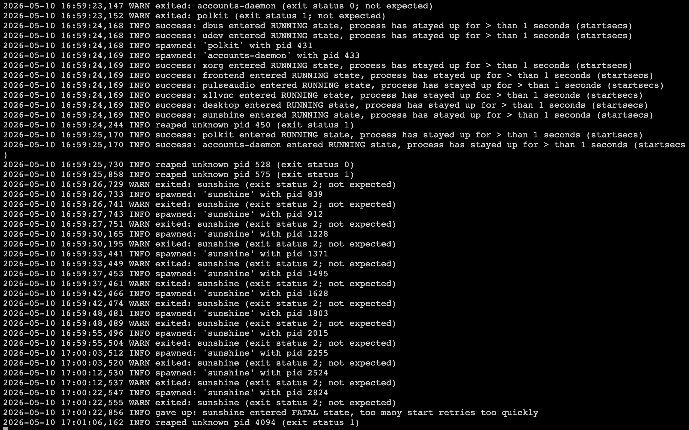

  2. I can use Steam Link to play the game with Steam Headless. I think the issue is that Sunshine can’t open. When I open Sunshine, org and Desktop, X11vnc exits. I try restarting Steam Headless but the log shows Sunshine exiting multiple times.

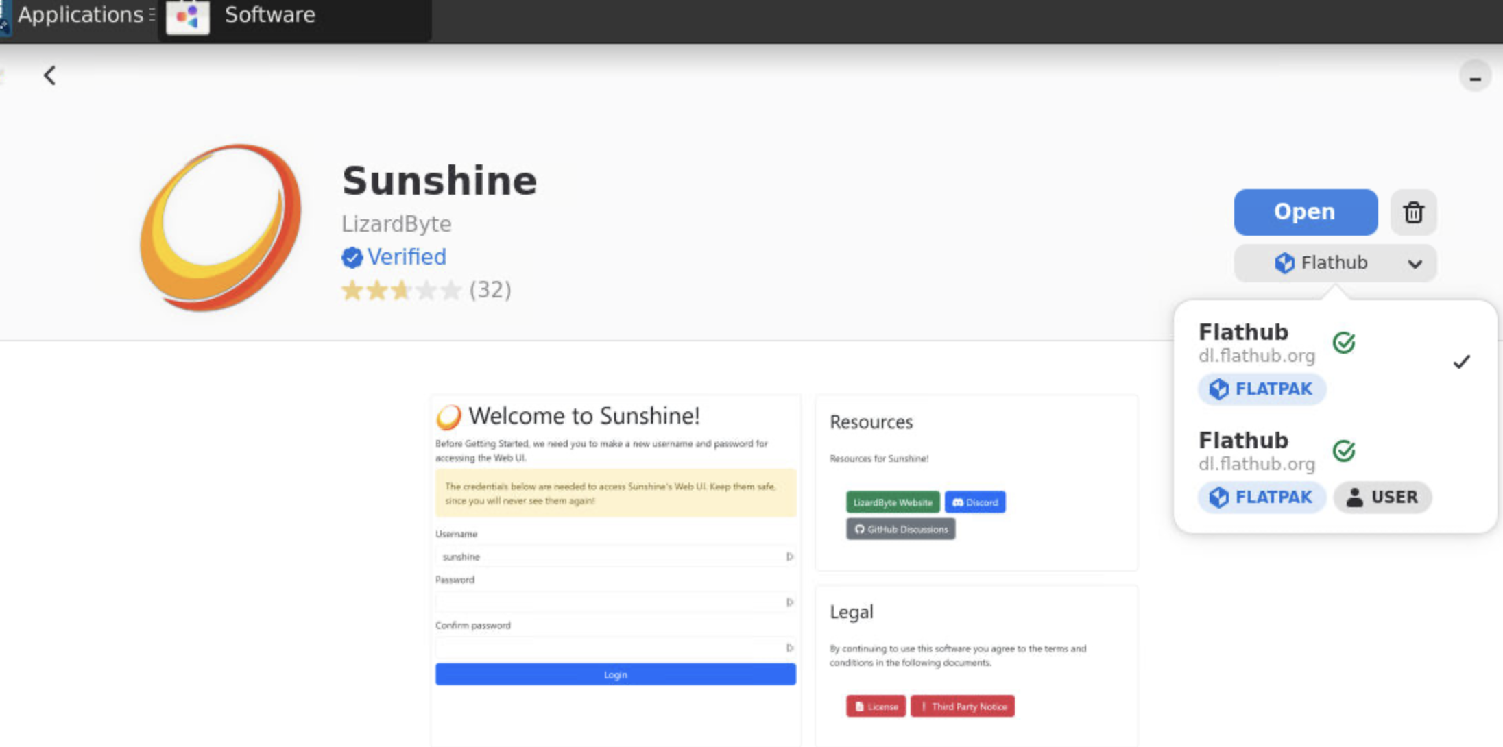

  3. Hi, I tried your method, but after installing Sunshine from the App Store when I open it. the log will show up org and desktop, x11vnc exit, but sunshine didn't open it. after x11vnc will come back I can vnc in to my steam headless.

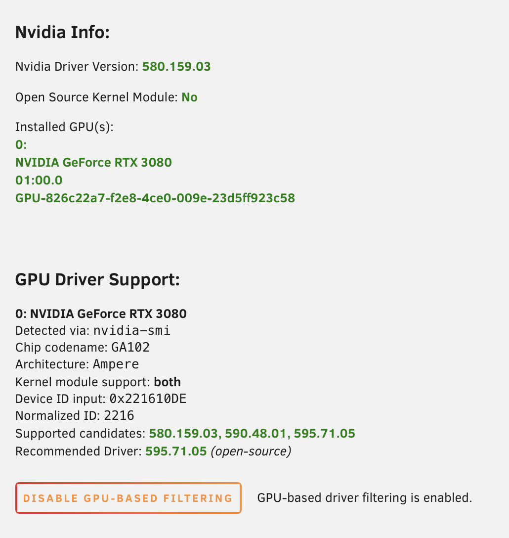

  4. Could you please share how to do it? Right now, I’m having trouble VNC in to the Steam headless. How do I install it? I did have the NVIDIA driver installed. I checked in the unraid command line and nvidia-smi shows it’s working. My Steam headless was working perfectly before but now it’s not. I can’t figure out what happened; I haven’t updated or restarted Unraid.
  5. After playing for two hours, my game froze. I restarted the stream headless and log show, showing x11vnc xorg and sunshine exit and restarted the loop and couldn’t play anymore. 🥲

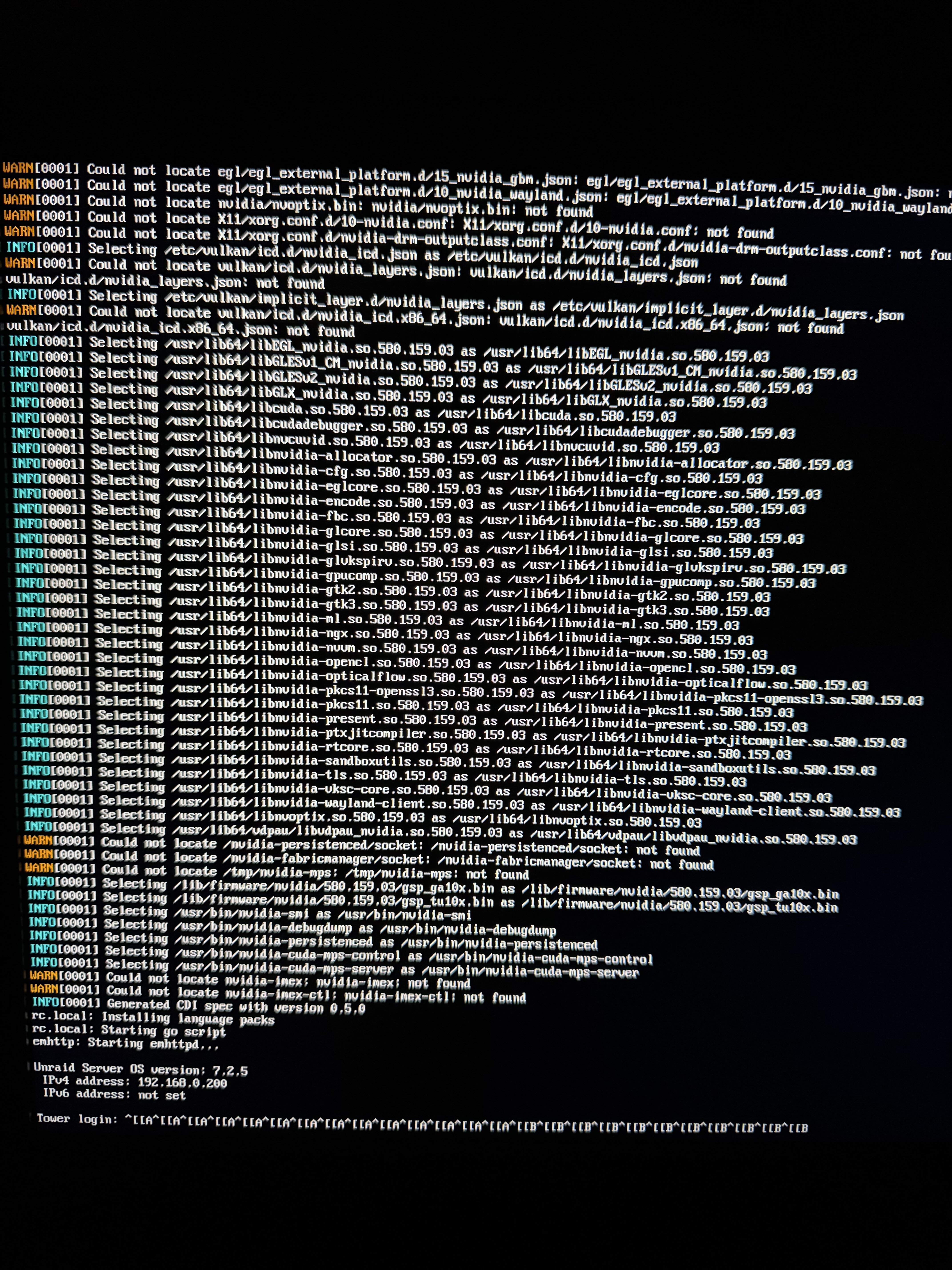

  7. also I just noticed my Unraid restart showing nVidia driver could not locate?
  8. Hi everyone, if anyone could help me🥲. I’m trying to understand why Steam Headless isn’t running anymore. It was working perfectly before but I can’t start it now. I’ve reinstalled all my Steam Headless and downgraded the Nvidia driver restart in Unraid. The first time I tried starting Steam Headless it worked normally and I could connect to VNC after a few seconds but then it disconnected. I’ve checked the logs and they always show a result of 11 indicating an error opening the X file. thanks. [ /etc/cont-init.d/70-configure_xorg.sh: executing... ] **** Generate NVIDIA xorg.conf **** - Configure Xwrapper.config - Configure container as primary the X server - Enabling evdev input class on pointers, keyboards, touchpads, touch screens, etc. - Configuring X11 with GPU ID: 'GPU-826c22a7-f2e8-4ce0-009e-23d5ff923c58' - Configuring X11 with PCI bus ID: 'PCI:1:0:0' - Writing X11 config with Modeline "1600x900R" 201.00 1600 1648 1680 1760 900 903 908 953 +hsync -vsync ERROR: driverInitFileInfo 578 result=11ERROR: init 664 result=11ERROR: init 250 result=11 WARNING: Unable to locate/open X configuration file. Option "ProbeAllGpus" "False" added to Screen "Screen0". Option "BaseMosaic" "False" added to Screen "Screen0". Option "AllowEmptyInitialConfiguration" "True" added to Screen "Screen0". New X configuration file written to '/etc/X11/xorg.conf' After that, I’ll see X11vnc and Sunshine exit and restart in a loop. 026-05-05 11:17:41,656 INFO reaped unknown pid 44355 (exit status 1) 2026-05-05 11:17:41,663 INFO reaped unknown pid 44371 (exit status 1) 2026-05-05 11:17:41,664 INFO reaped unknown pid 44388 (exit status 1) 2026-05-05 11:17:41,664 INFO reaped unknown pid 44452 (exit status 1) 2026-05-05 11:17:41,664 INFO reaped unknown pid 44550 (exit status 1) 2026-05-05 11:17:41,664 INFO reaped unknown pid 44460 (exit status 1) 2026-05-05 11:17:41,733 WARN exited: sunshine (exit status 134; not expected) 2026-05-05 11:17:41,765 INFO spawned: 'sunshine' with pid 44759 2026-05-05 11:17:41,784 WARN exited: x11vnc (exit status 3; not expected) 2026-05-05 11:17:41,787 INFO spawned: 'x11vnc' with pid 44764 2026-05-05 11:17:41,794 INFO reaped unknown pid 44278 (exit status 0) 2026-05-05 11:17:41,794 INFO reaped unknown pid 44769 (exit status 0) 2026-05-05 11:17:42,805 INFO spawned: 'xorg' with pid 44816 2026-05-05 11:17:42,806 INFO success: x11vnc entered RUNNING state, process has stayed up for > than 1 seconds (startsecs) 2026-05-05 11:17:42,806 INFO success: desktop entered RUNNING state, process has stayed up for > than 1 seconds (startsecs) 2026-05-05 11:17:42,806 INFO success: sunshine entered RUNNING state, process has stayed up for > than 1 seconds (startsecs) 2026-05-05 11:17:43,842 INFO success: xorg entered RUNNING state, process has stayed up for > than 1 seconds (startsecs) 2026-05-05 11:17:43,942 INFO reaped unknown pid 44350 (exit status 0) 2026-05-05 11:17:44,009 INFO reaped unknown pid 44907 (exit status 1)
