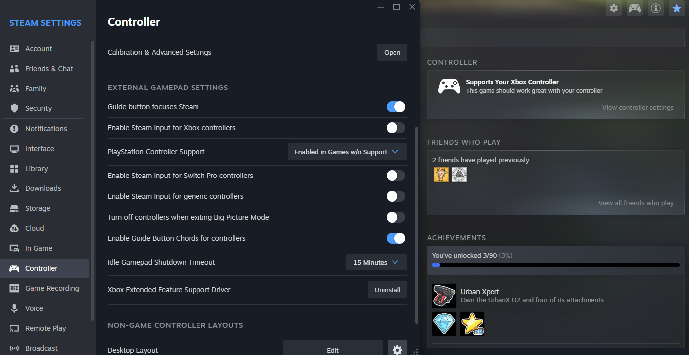

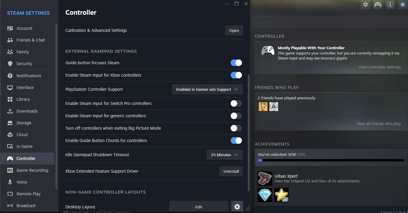

  2. Thanks for the reply. Here are my steam client "Controller" settings: When I select "Enable Steam Input for Xbox controllers" the "CONTROLLER" dialog box for the game switches to "Mostly Playable...": Regardless of these settings, the controller is recognized in Steam and passes calibration perfectly. The controller stops functioning when starting a game, but the mouse and keyboard continue to work. This experience is the same on a Windows PC using Steam Remote Play (STREAM) and Steam Link on the nvidia shield. I've tried a bluetooth Xbox S controller and the nvidia shield controller, both behave the same. I even tried the "Xbox Extended Featured Support Driver" without success. I contrast, I tried streaming from a Windows PC and it worked perfectly. I suppose I can try streaming from a Linux PC to see if the controller works. Maybe the issue isn't the steam-headless container, but a Linux issue in general. I've found stuff like this which sounds similar, but to no avail. Any help is appreciated. This is such a cool idea--being able to run GPU compute workloads next to gaming is a fantastic idea. UPDATE: I've been testing with Windows/Proton games. I just tried with a native Linux game, Valheim, and the controller worked perfectly! Any idea why Proton games don't work with controllers?
