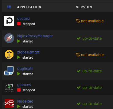

I'm wondering if someone can help with a published Unraid+Docker app problem.  I've built 2 containers and published them to CA.
One of the containers (phvalheim-server) show updates "not available". The other (intel-gpu-telegraf) works fine.  The .xml templates are very similar and I can't seem to figure out how to fix this.  I'm getting complaints from people using Unraid that this new container (phvalheim-server) is showing "not available" on everyone's installation.  Including mine and two of my test systems.
The only search results I find are related to all containers having this issue which is DNS related or a bug prior to 6.9.  I'm on 6.11.5 and all versions since creating this container have had this issue.

Here is a screenshot showing the issue.
My other container works fine.

I figured it out. This isn't a CA or unRAID issue. It's OCI compatibility with DockerHub.
Hopefully this can help someone else.
My debugging process:
I grepped through the entire directory /usr/local/emhttp/plugins/dynamix.docker.manager/include for "not available" which is the HTML label shown in the Unraid Docker UI
To prove to myself that I found the right label, I added the "!" you see in the screenshot above.  This label is inside a case/switch condition. I.e., 0="up-to-date", 1="update ready", 2="rebuild ready" else, "not available" within the DockerContainers.php file. My containers were returning a NULL value which results in the "default/else" (not available message). This condition evaluates the variable "$updateStatus". This variable is set by an array read of the $info['updated'] array element.  This variable is set by DockerClient.php and where most of my debugging occurred.
/usr/local/emhttp/plugins/dynamix.docker.manager/include/DockerClient.php: I added the following to the "getRemoteVersionV2" function to assist in debugging.
$file = '/tmp/foo.txt';
file_put_contents($file, PHP_EOL . $image . '(' . $manifestURL . ')' . '   ', FILE_APPEND);
This sent me on a reverse engineering journey and helped me create a little test script:
#!/bin/bash
repo="theoriginalbrian/phvalheim-server"
TOKEN=$(curl --silent "https://auth.docker.io/token?scope=repository:$repo:pull&service=registry.docker.io" | jq -r '.token')
curl --header "Accept: application/vnd.docker.distribution.manifest.v2+json" --header "Authorization: Bearer $TOKEN" "https://registry-1.docker.io/v2/$repo/manifests/latest"
The output of this little test script:
{"errors":[{"code":"MANIFEST_UNKNOWN","message":"OCI manifest found, but accept header does not support OCI manifests"}]}
A bit of research landed me in DockerHub API documentation...in short, OCI images do not contain the SHA256 image digest (at least in the location DockerHub expects).
This led me to look at how I'm building my images. My dev system is just a simple Rocky 8.6 (EL) VM, which runs podman. By default, podman builds in the OCI format.  Simply passing "--format=docker" to my podman build command solved the issue.
Results:
After clicking "check for updates":
After clicking "apply update":
After clicking "apply update" and "check for updates:"
TL;DR: add "--format=docker" to your docker/podman build command.

Just to note that I'm having the same issue on a few dockers. At first I thought it was because I had an issue with my DNS (pihole) but changing unraid DNS to use 1.1.1.1 and 8.8.8.8 didn't fix.
To add assault to injury, when I try to add --format=docker as an extra parameter as suggested above, the docker don't compile anymore :( I receive the following error message:

I don''t think we can change this for running containers:
see here
I have not yet tried the solution offered by @m33ts4k0z
He changes this line:
$header = ['Accept:application/vnd.docker.distribution.manifest.list.v2+json,application/vnd.docker.distribution.manifest.v2+json'];
to
$header = ['Accept:application/vnd.docker.distribution.manifest.list.v2+json,application/vnd.docker.distribution.manifest.v2+json,application/vnd.oci.image.index.v1+json'];
But I cannot oversee the possible implications for changing a main docker file, as other systems might be depending on it?

This wont affect anything else. I suppose it will also be integrated by the Unraid team.

My issue persisted until I forced an update on glances and PlexTraktSync but when I click "Check for updates" it goes back to "not available".

Forcing update on my Komga docker fixed it for about a day. Not Available returned the next day when checking Docker menu.
Install the Docker Update Patch plugin.

@m33ts4k0z work around does work though until you reboot.
The Docker Update Patch does seem to fix it properly.
