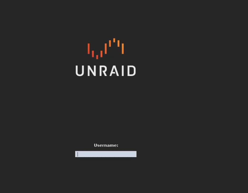

  1. It ended up being my go file from when i was messing around with tailscale for automated backups and plex failover.
  2. I booted into Safe mode: no plugins I was watching the bootup sequence, but it went over to this before i could see if emhttp started I can get into the webui just fine in safe mode. Server seems responsive, array is stopped. I previously had a cold spare drive installed and sitting in Unassigned Devices. On the hardware/case swap i didn't install the cold spare. Just thought id mention it. edit: i threw the cold spare in and nothing changed.
  3. On 7.2.2 I just swapped cases and motherboard/cpu and on my bootup it never makes it to Tower Login, it just sticks on emhttp: Starting emhttpd... all hardware was moved over, but i had a cold spare that was sitting on unassigned devices that i didn't install, just fyi. But, i can still get into the webui just normal and everything appears to have booted just fine. Attached are diagnostics. Any ideas? Unraid diagnostic 121625.zip

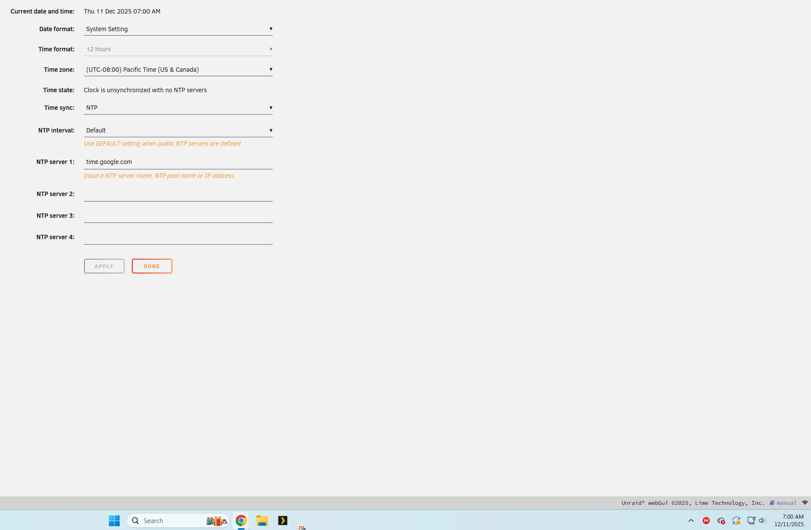

  4. I checked the bios and within the unraid ui and its correct. I'll fire it back up and check again. Edit: Confirmed to be correct on the unraid ui Also, now when i try to start my 30 day trial, and it opens the web site and click start Trial, it says "Trial Start Failed"
  5. i tried shutting down and did a quick format of the flash drive and recreated the boot drive. Same thing.
  6. I'm trying to verify if a new system is going to work for my needs before i move my main server over. I finally found a flash drive that hasn't had unraid installed on it and when i go to start trial i get this I went into bios and made sure that my clock was correct and did the same within unraid. I did get the email from unraid with the trial key info. I probably have another key linked to this email if it matters. Attached are diagnostics bigbitch-diagnostics-20251210-1526.zip

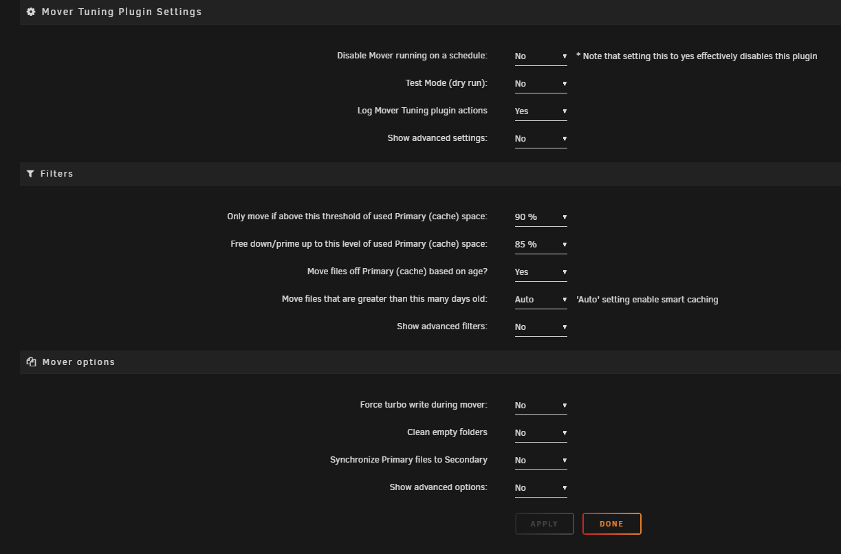

  13. Glad you got it figured out. It's working well for me to keep current media on the cache.
