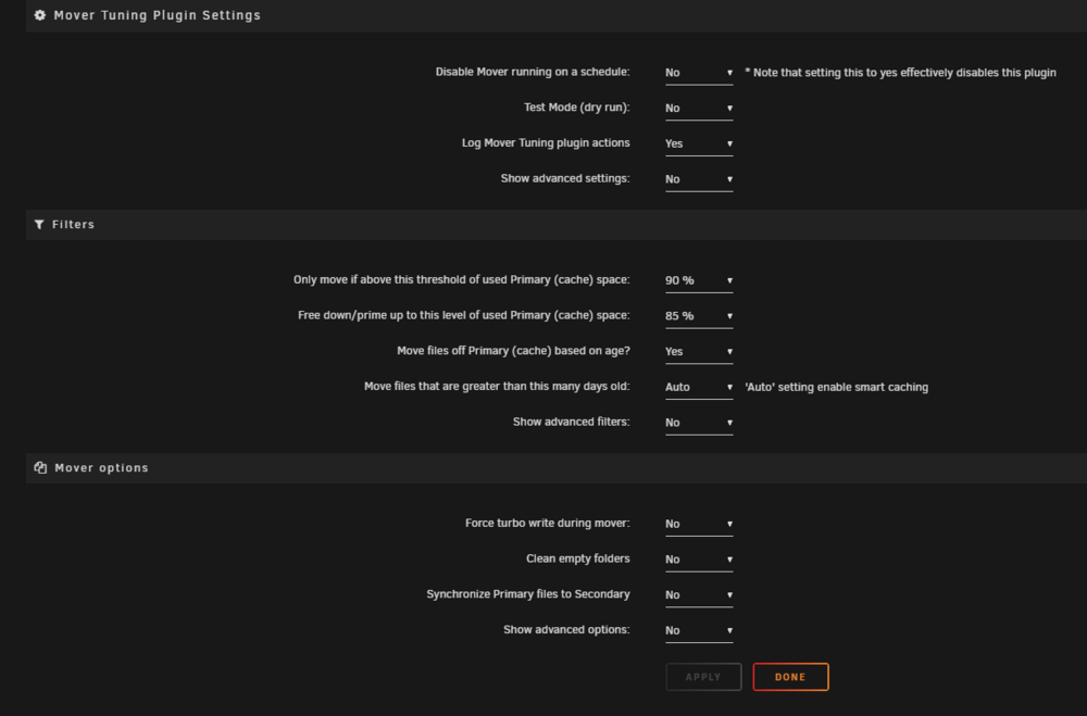

Add the script to mover tuner to run before moves.
image.png.a1860024430baf5cb0f22071b42b4a
Set mover tuner to ignore files contained in the output filename :
image.png.85709674756918a9aecc0387c6cee6

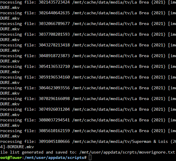

If you run the script by hand (bash moverignore.sh) you can see the files that it will keep on the cache.
You can then run the following command to test if mover will not move the files in question (any files in the ignore file, should not appear in the output of this command)
find "/mnt/cache/data" -depth | grep -vFf '/mnt/user/appdata/moverignore.txt'
You can also run mover in the commandline, and verify that it does not move any of the listed files (but should continue to move unlisted files)

  • Thanks! I'm in the process of implementing similar functionality in the plugin and also fix some bugs. It might be some time though so for the time being I think this is an excellent solution for thos

Thanks! I'm in the process of implementing similar functionality in the plugin and also fix some bugs. It might be some time though so for the time being I think this is an excellent solution for those that want it :)

Thanks for linking to this from the movertuning page.  Looks exactly what i am looking for.
So for the simple minded like me:
Copy the scrpt to notepad++, change the "MAX_SIZE" to 3.5tb (in bytes, i have a 4tb cache), save as "moverignore.sv" and place it \appdata\scripts.  Do i need to change anything in TARGET_DIR or OUTPUT_DIR?  I created moverignore.txt and placed it in \appdata\scripts
In mover tuning path to moverignore.sv in "Script to run before mover (No checks, always runs):"  and moverignore.txt for the "Ignore files listed inside of a text file:"
