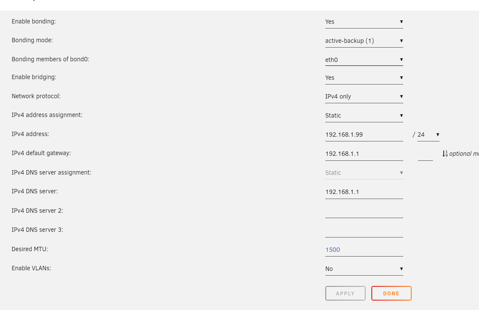

July 23, 20224 yr Try changing your DNS server to 208.67.222.222 and 208.67.220.220 instead of using your router. Settings - Network Settings

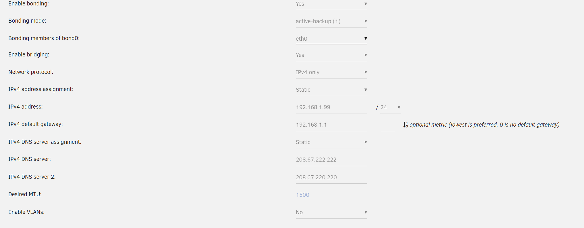

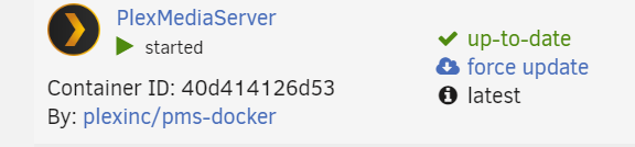

July 23, 20224 yr Author 5 hours ago, AndrewZ said: Try changing your DNS server to 208.67.222.222 and 208.67.220.220 instead of using your router. Settings - Network Settings The IPv4 DNS Server? how do i change it to two different ones? Edit: This did the trick! I stopped my docker engine, and i came up with a spot to add multiple dns servers. I changed it to this : I checked for updates on the dockers and were back in business I'd still like to know why this happened if anyone knows. Edited July 23, 20224 yr by danimal86
