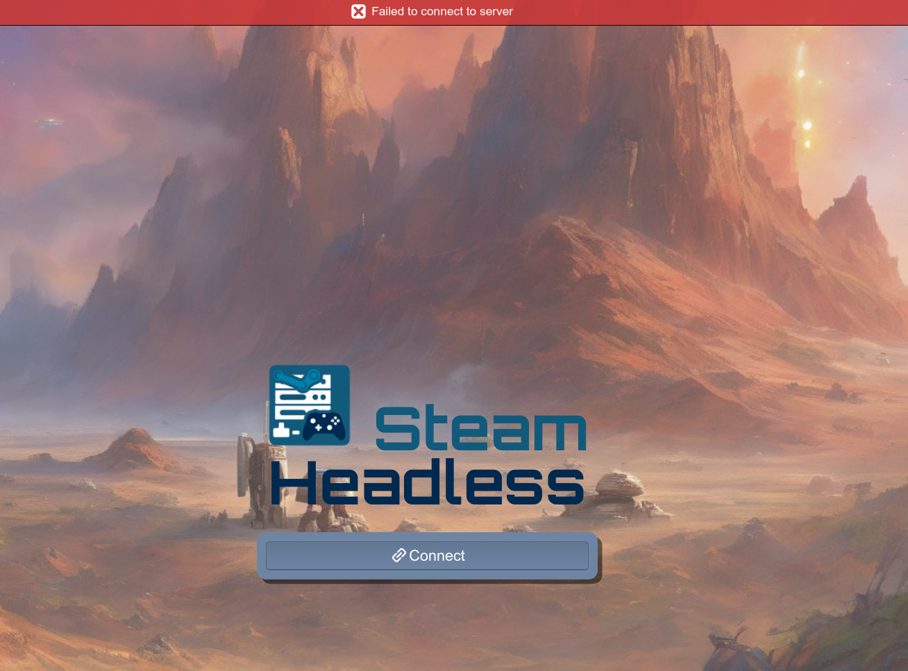

Hello, @Josh.5 I buy new Nvidia GPU and add to my server. I have also intel integrated GPU with i5-12600K. I install steam-headless one more time and add extra parameter:
--runtime='nvidia'
at the beginning.
I go to webgui and click connect but have error at top of site.
Logs shows me:

10 minutes ago, Josh.5 said:
@MarianKoniuszkopost your docker run command. Looks symptomatic of you mounting /run/udev or /dev/input
Hi, I forget to mention I connect new nvidia card to my tv with hdmi-DisplayPort cable. I don't have any dumy plug for my igpu (meybe I should try? Because my VAAPI transcoding is gone in Emby now).
docker run
  -d
  --name='steam-headless'
  --net='host'
  -e TZ="Europe/Warsaw"
  -e HOST_OS="Unraid"
  -e HOST_HOSTNAME="unRAID"
  -e HOST_CONTAINERNAME="steam-headless"
  -e 'USER_PASSWORD'='mypassword'
  -e 'TZ'='Europe/Warsaw'
  -e 'USER_LOCALES'='en_US.UTF-8 UTF-8'
  -e 'WEB_UI_MODE'='vnc'
  -e 'NVIDIA_VISIBLE_DEVICES'='all'
  -e 'NVIDIA_DRIVER_CAPABILITIES'='all'
  -e 'DISPLAY'=':55'
  -e 'MODE'='primary'
  -e 'PORT_NOVNC_WEB'='8083'
  -e 'ENABLE_VNC_AUDIO'='false'
  -e 'ENABLE_EVDEV_INPUTS'='false'
  -l net.unraid.docker.webui='http://[IP]:[PORT:8083]/'
  -l net.unraid.docker.icon='https://raw.githubusercontent.com/Josh5/docker-steam-headless/master/images/steam-icon.png'
  -v '/mnt/user/appdata/steam-headless':'/home/default':'rw'
  -v '/mnt/user/GRY/':'/mnt/games':'rw'
  --runtime='nvidia'
  --hostname='SteamHeadless'
  --add-host='SteamHeadless:127.0.0.1'
  --restart='unless-stopped'
  --shm-size='2G'
  --ipc='host'
  -v '/tmp/.X11-unix/':'/tmp/.X11-unix/':'rw'
  -v '/tmp/tmp/pulse/':'/tmp/tmp/pulse/':'rw'
  -v '/dev/input/':'/dev/input/':'ro'
  -v '/run/udev/data/':'/run/udev/data/':'ro'
  -v 'steam-headless-var-lib-flatpak':'/var/lib/flatpak/':'rw'
  --ulimit='nofile=1024:524288'
  --device='/dev/fuse'
  --device='/dev/uinput'
  --device-cgroup-rule='c 13:* rmw'
  --cap-add='NET_ADMIN'
  --cap-add='SYS_ADMIN'
  --cap-add='SYS_NICE'
  --security-opt='seccomp=unconfined' 'josh5/steam-headless:latest'
ed9521f2d2....
The command finished successfully!
@Josh.5 do I have to enable VM in unRAID?

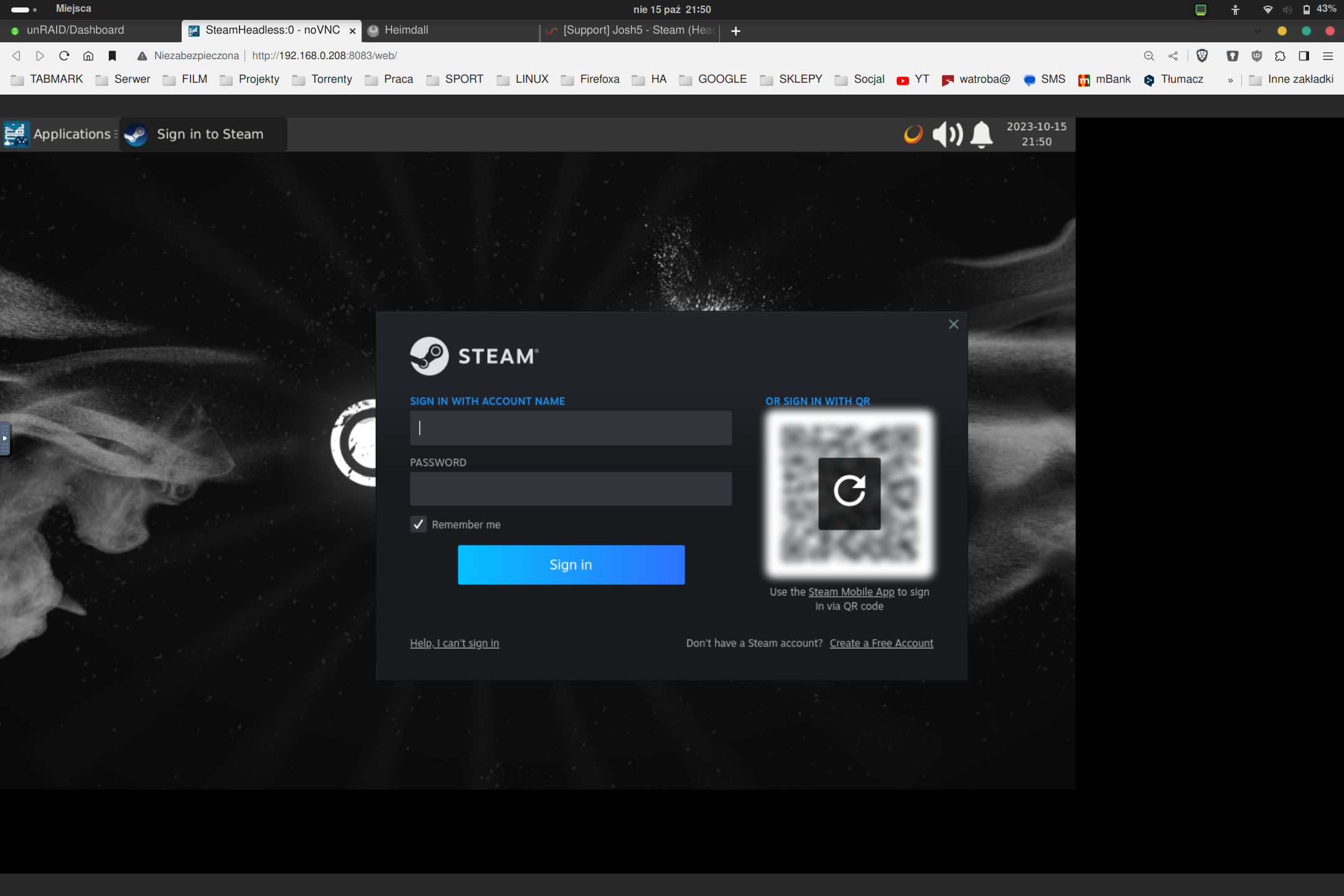

Or meybe `Display ID: :55` option should be changed? I have my nvidia GPU connected to TV with hdmi-displayport cable.
OK, I change to `:0` and now works.

It is failing because you have.
-v '/dev/input/':'/dev/input/':'ro'   -v '/run/udev/data/':'/run/udev/data/':'ro'
You have not updated your container template.
Have you also booted unraid in gui mode? This would also be wrong.
No I don't boot in steamos GUI.
