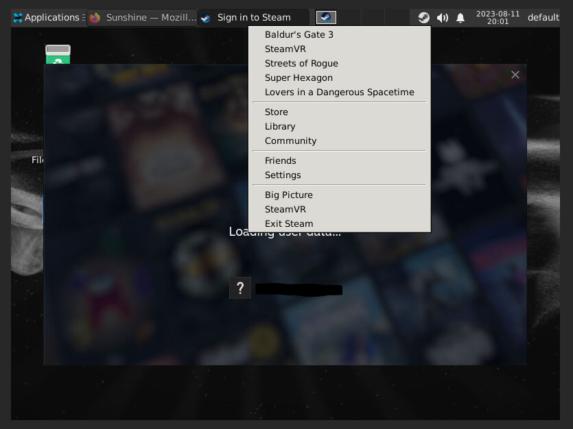

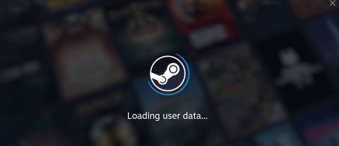

Hey All,
I'm was able to get this installed with no issue, I can see it on my steam link, but the steam app itself never loads completely. I was able to get logged in but it just hangs on "loading user data" so I can never input the code my steam link wants me to put in. Any idea what's causing this?
Thanks

Hey, I have a very similar issue. I tried almost all the troubleshooting advice from the previous pages, but they didn't help. The main loading freezes directly after it says "Loading user data...". The loading animation freezes completely. Sometimes I can click on on the steam icon and it shows me the context menu, but selecting anything does nothing.
I have installed the suggested older nvidia driver, reinstalled the container, deleted the .steam folder and rebooted. Nothing helped. Might try to rollback the Unraid Version as this is just a test before I decide to migrate completely.
Are there any relevant logs or other infos that might help narrowing it down?
//edit:
Turn it I'm dumb. As this was a test system I hadn't the advanced settings view enabled and therefore didn't set the extra parameter to enable the GPU. It works now as expected... Leaving this in case someone else was on autopilot while setting this up...
Edited by marvelous-marv
