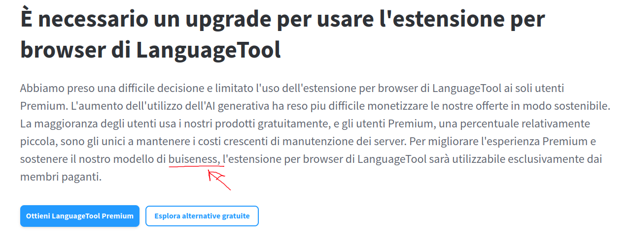

Well the self hosted version isn't usable also, because it has no login protection at all, everyone can use it unlimited.... PS: I find hilarious that they don't use their tool to proofread their stuff...
