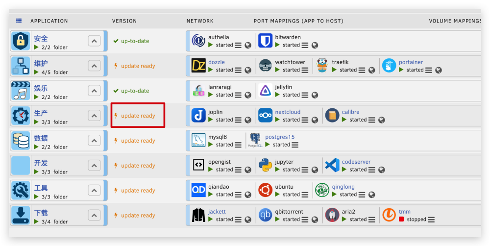

Is there any way to disable Docker container 'update ready' sign?
I use docker compose to deploy my containers,so unraid's buildin container update function dosen't work my containers.

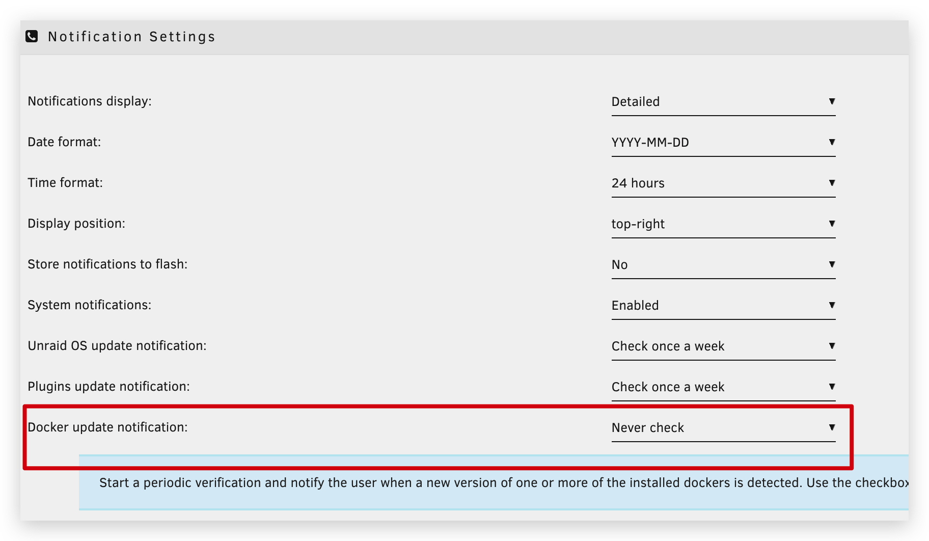

And I already disabled 'Docker update notification' as below

Im a software developer,I know I can use stable tag instead of  THE DEFAULT LATEST TAG to avoid upgrade check.
I chose to use the latest tag on purpose(not on all service/containers,just some of them), to keep the service up to date , and let watchtower upgrade those containers for me quietly.
Just want to know if there is a way to disable unraid's container upgrade check which in my case , is unusable since I use docker compose instead of unraid's templates.

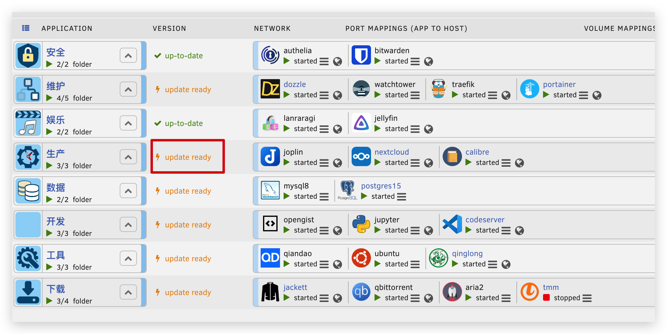

When using docker compose in unraid , the update button dosent work ,it just simply fail during process.Therefore the 「⚡️ update ready」hint is useless and annoying.And even if I manually upgrade by 「docker compose pull && docker compose up -d」or  watchtower already upgrade those  「update ready」containers , the 「⚡️ update ready」sign wouldnt disappear!
Please dont argue with me about what tag I should use anymore.
我是一名程序员,说不上精通,但是平常经常使用docker,我也知道默认情况下docker会使用latest作为镜像的tag。
我是特意使用latest作为tag的,因为我需要一部分服务永远保持最新,为此我也部署了watchtower来静默更新容器。
我只是想知道有没有办法屏蔽unraid的容器更新检查。
我在unraid里安装了docker compose 插件(我工作中还有以前使用其他系统的时候,我更习惯用docker compose ),在unraid中使用docker compose来部署的容器,虽然在webui中能够提示容器更新,但是点击更新按钮会报错,容器也不会被正确更新,所以「⚡️ update ready」这个提示对我来说并没有用处,毫无意义还多少有点碍眼。
