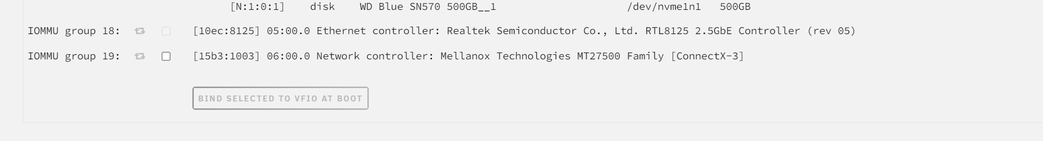

  10. I cannot install new firmware with windows because when i type smt status , i got " no mst device " However i did upgrade to latest firmware troug mellanox plug in on unraid instead of use the link othe plug in i use the link of the firmware belong to my card. Even after upgrade on unraid and move the card to windwos still i got " no mst device' I also tried with ubuntu on 2 different machine and still i got no mst device found , i also use mlxconfig and i got unable to open the device i also just i case disable secure boot and enable SR-iov as reported on same post around
  11. No, i already tryed all, i tried with both card, i installed both card on two different machine , using linux and windows and in all case when i try mst status , i got device not found . The card are perfectly working in infiniband , but i cannot converth to eterneth Its a shame the card are new, i have to buy another 2 card but this time i will purchase the ethernet one Is this card will be good ? Mellanox MCX311A-XCAT CX311A ConnectX-3 EN 10G Ethernet 10GbE SFP Network Card. What if i buy only one card and connect the infiniband on windows and this MCX311A on unraid with a cable QSFP to SFP+ will work ?
  12. Guys please i just purchased 2 Mcx354A -FCBT card but i am not able to get working on unraid , in network configuration is not showing , is present in system device. i belive is because is set to infiniband but i am not able to change , i also tried on windows to do taht but installying all the software and driver but the option is not showing . Can you please help me
