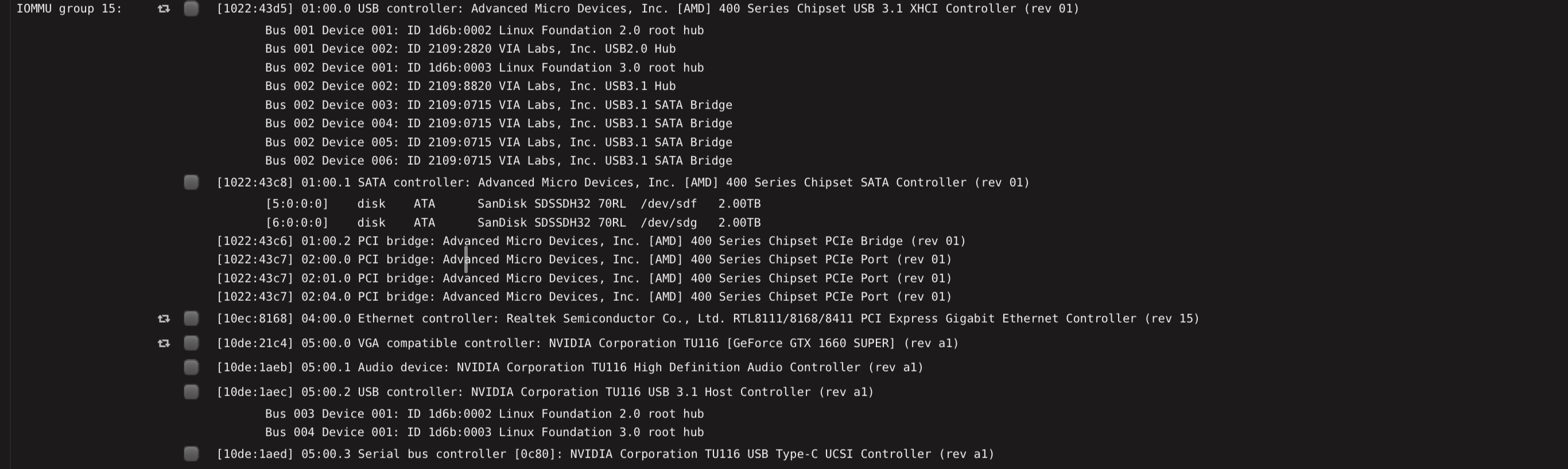

Is it possible to use the VM also while have this plugin installed? Can`t split the IOMMU Group while this plugin is installed or? Any other way to forward my 1660 Super to my Win 10 VM?
I don't understand...
What do you want to do? Do you want to use it in a VM or in a Docker container?

Bind the two cards that you use in the VMs to VFIO and the error should be gone.
11 minutes ago, Caennanu said:
however it will show the 1050ti, not any of the other gpu's
If you started the other VMs the plugin can't see the other cards because they are used in the VMs.
Do you want to use the GT710 for Docker containers if yes, for what?
@ich777 okay, can do that. Binding, Never really read up on that what its actually for. And good to know. But maybe its similar for Hellraiser?
No no, the GT710's are nothing more than offloading basic graphics for the VM's from the cpu, while having the option to hook up a monitoring monitor to them (CCTV montage in a room near where the server is). The 1050 is for Docker containers. And well, i tagged you on that one the other day. So that works ;)
You do that to "hide" them from unRAID to use it exclusively in VMs.
Go to your system devices and bind the two cards, including the audio device from the cards to VFIO and reboot so that the plugin only can "see" the 1050Ti.
Ahh ok gotcha.
Funny thing is, i knew how to, just not why to ;)
