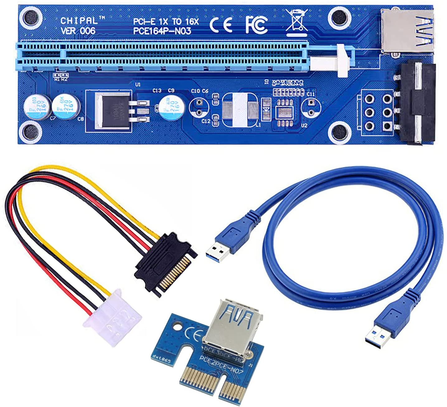

Can you eventually try to create another USB boot device for Unraid (on a spare USB Key) that you can plug in your PC that use for testing the card and boot of off it (don't start the Array or assign Disks) and register for a Trail Key, install the CA App and then try to install the Nvidia driver (this should work even if the Array isn't started and you can then go to the Plugin page and see if the card is recognized)?
If the above test is working eventually you can get a riser like that (it delivers power over to the card by the Molex connector on the board):

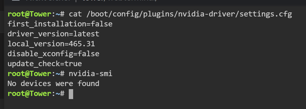

After updating to version 2021.05.19 I no longer have video out of my integrated graphics.  What would cause this?
Are you booting into GUI mode? What integrated graphics card do you own (eventually post your Diagnostics for further troubleshooting)?
Are you sure that the iGPU is set to the primary display output in your BIOS? Have you changed anything recently in your system or updated the BIOS?
The update is almost a month old now and nothing trivial changed that would prevent your iGPU from displaying any output.
Intel Integrated graphics is set to be the primary and no BIOS changes or updates. All I get after the flashing courser is a blank black screen.
tower-diagnostics-20210616-1718.zip
Do you know on what version you where previously and for how long you where on this version?
Can you open up a terminal from Unraid and execute this command:
sed -i '/disable_xconfig=/c\disable_xconfig=true' "/boot/config/plugins/nvidia-driver/settings.cfg"
after that please enter this command:
cat /boot/config/plugins/nvidia-driver/settings.cfg
and check if the line that starts with 'disable_xconfig' is set to 'true', should look something like that:
After that please reboot and see if it is working again and please let me know.

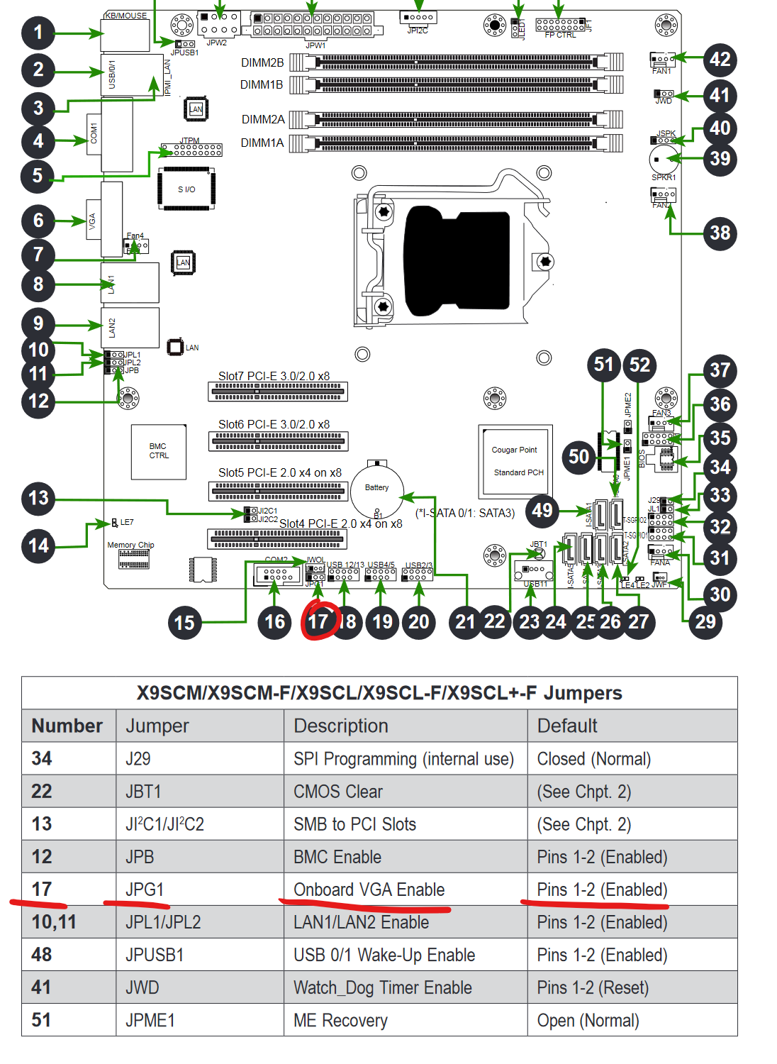

Hello everyone,
can i byepass the matrox card with this plugin so i can use hardware acceleration with my supermicroboard?
If yes which costeffective card can you recommend? Nothing special needed. Just one stream mkv Container 1080p Blueray rip 2D with true hd 7.1 audio.
Hope its not considered a double post. I just opend a post at the hardwaresection with more detail.
Edited by Roadini

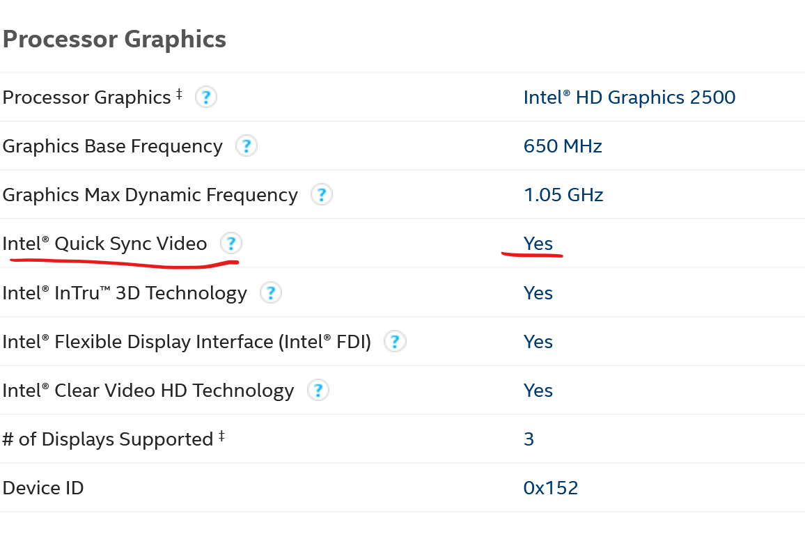

As what I've found in your motherboard manual you can disable the integrated graphics too with this jumper:
If it's a h.264 file that you are trying to transcode your Intel iGPU should be enough to do the job:
To enable your iGPU install the Intel-GPU-TOP plugin and pass through the device '/dev/dri' to your Docker and enable HW transcoding in your Plex settings and see if it uses the iGPU for transcoding.
The 3220T is pretty old now but it should be enough for h.264 streams, if you want to transcode HEVC (h.265) you need something newer.
Eventually a GTX1050 or GTX1050Ti should be enough for the job.
If that works you ll be my personal hero of the day!

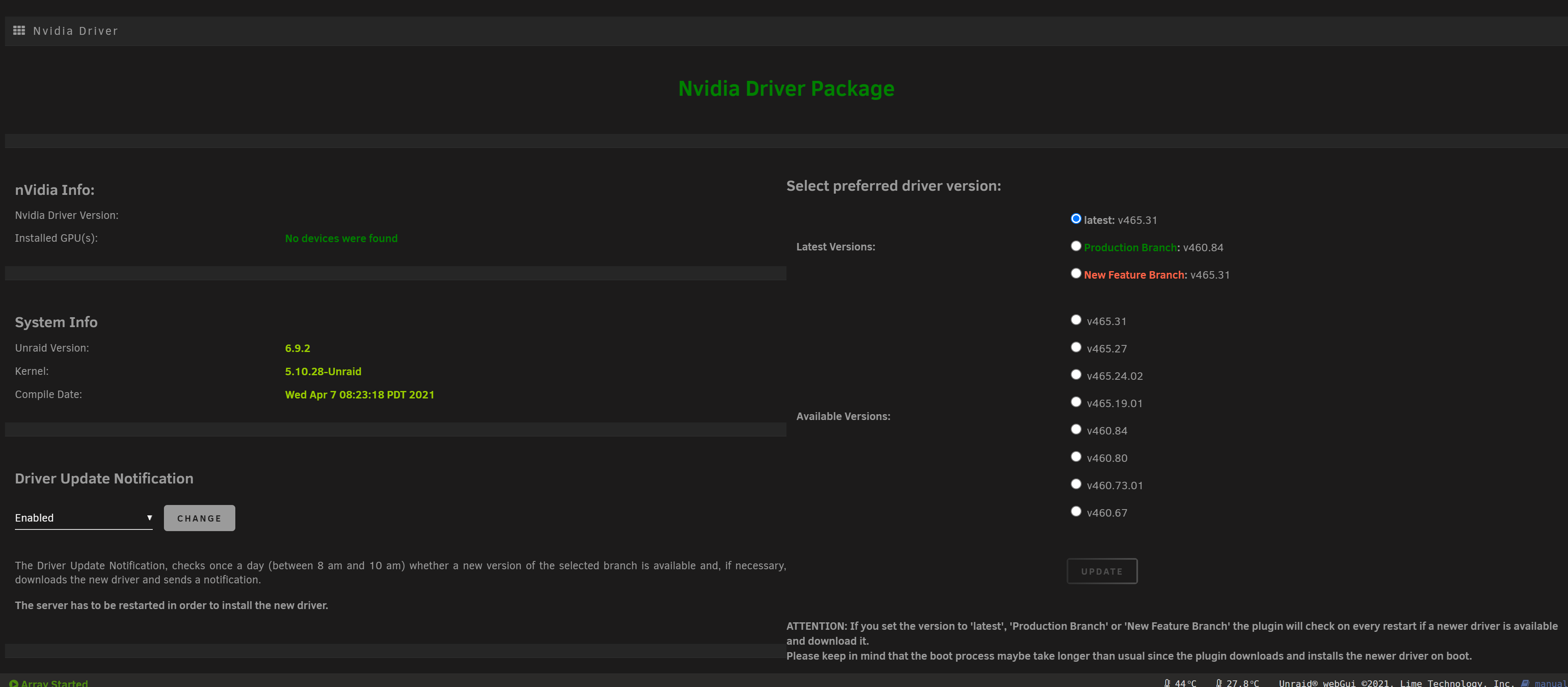

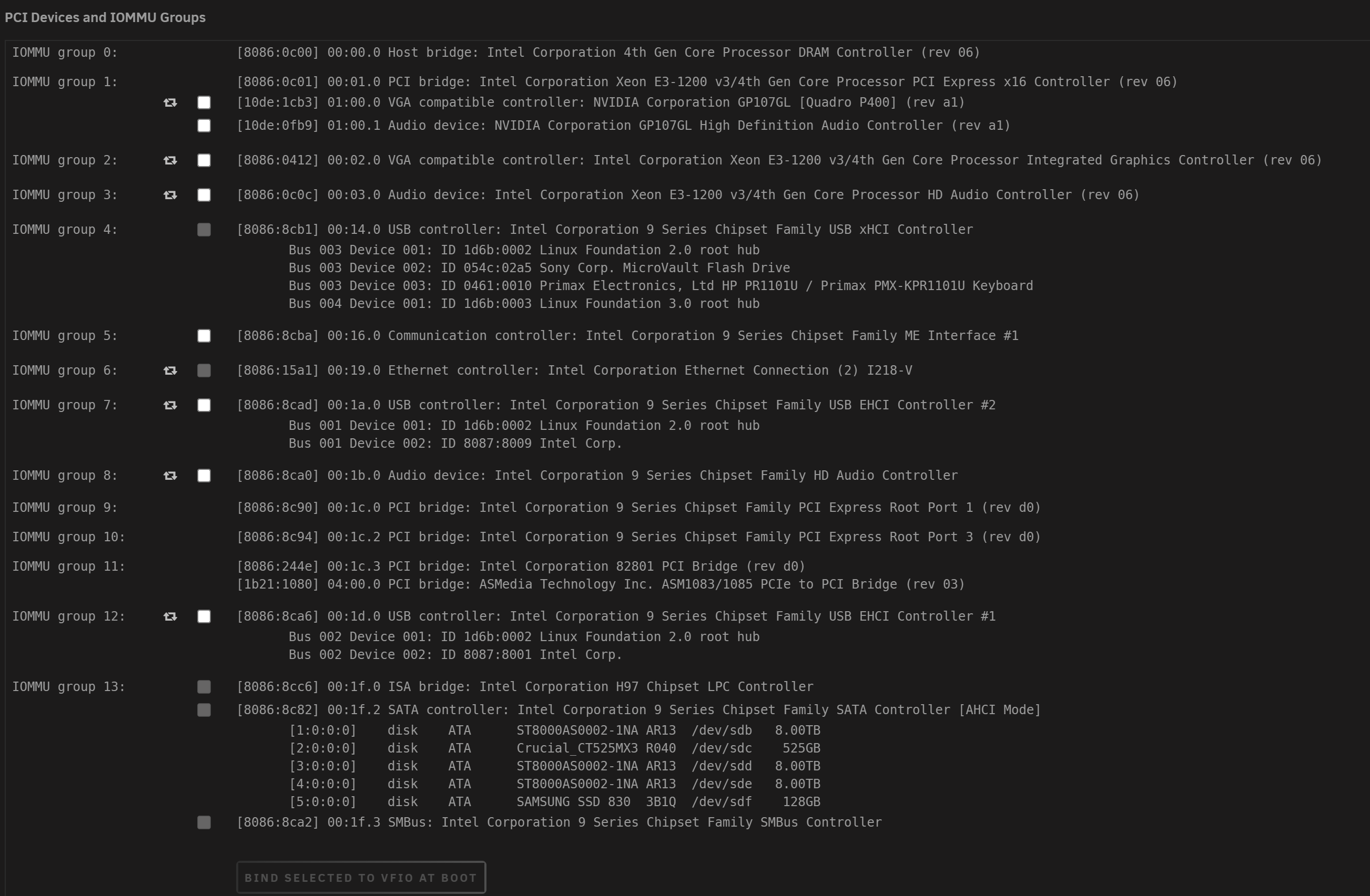

Hi Folks,
I'm running into the following problem. I installed the Nvidia Plugin as instructed but my Nvidia P400 is not showing up. Still tough it shows up in the device list.
My System Specs:
Model: Custom
M/B: MSI H97M ECO (MS-7817) Version 5.0 - s/n: To be filled by O.E.M.
BIOS: American Megatrends Inc. Version V26.8. Dated: 02/18/2016
CPU: Intel® Core™ i5-4590 CPU @ 3.30GHz
HVM: Enabled
IOMMU: Enabled
Cache: 256 KiB, 1 MB, 6 MB
Memory: 8 GiB DDR3 (max. installable capacity 32 GiB)
Network: bond0: fault-tolerance (active-backup), mtu 1500
 eth0: 1000 Mbps, full duplex, mtu 1500
Kernel: Linux 5.10.28-Unraid x86_64
OpenSSL: 1.1.1j
Uptime:
Unraid Version 6.9.2 2021-04-07
Nvidia Screenshot:
Cli Nvidia Smi Screenshot:
PCI Devices Screenshot:
If I bind the GPU via VFIO the Nvidia settings page says that the driver could not connect to the GPU which is strange since it says the device is not found when the GPU is unbound.
What I've tried until now:
1. Switching between UEFI and Legacy Boot.
2. Update my BIOS to the latest available.
3. Setting the PCI-E Slot in Bios Manually to Gen. 3
Any suggestions how I can get the driver to see my Nvidia P400 GPU?
tower-diagnostics-20210618-1910.zip
Edited by jaddel
add diagnostics
