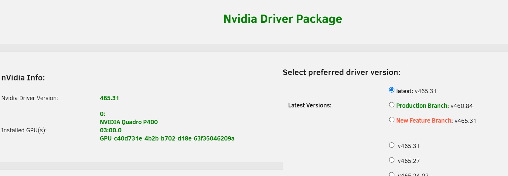

  4. Finally! Guess it was either: PCIE slot 1 and 2 not providing enough power Legacy or UEFI boot option The auto setting for PCI Gen 1,2,3 causing the riser to not be recognised (i had that with my main desktop build.)

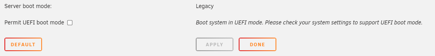

  5. OK!!! So i put the riser cable into the one PCIE slot i had not tried yet, as it held my 2 port SATA card, and moved that away. I went into BIOS and changed "Legacy or UEFI" to just "Legacy" in the boot options, and turned the Auto PCIE speed selection to 2nd Gen. I also set to prefer Offboard GPU Dug out a mini display port to HDMI adapter and boom - logged into WebGUI direct from new Server GPU. Seeing if i can sort this Nvidia driver out now...

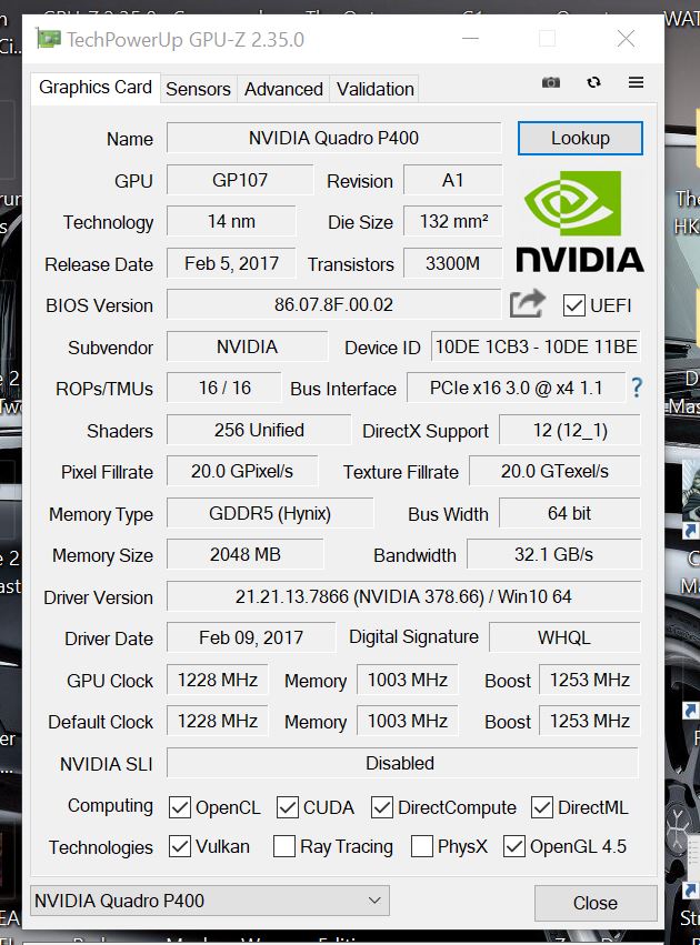

  6. I have just now - plugged it using the riser cable into my modern desktop, installed drivers and it was recognised fine. I ran part of a TimeSpy test and it worked fine on that, although the FPS was poor, as expected on such a tough test. Also played Doom and Arkham City on Steam and they worked. I boot in Legacy according to UnRaid flash info. So i'm sure the card works as it should, as does the cable
