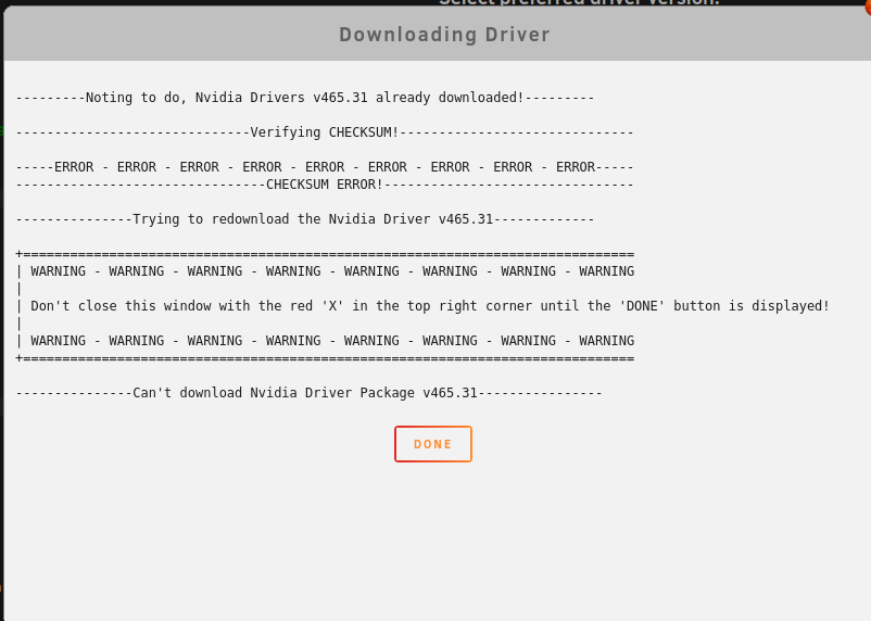

unRAID was trying to download the new driver but it fails, no idea to troubleshot this, can't find anything in the logbook:
Have you clicked the download button again once more?
What Unraid version are you using?
Please also attach the diagnostics (Tools -> Diagnostics -> Download -> drop the downloaded zip file here in the text box).

2 hours ago, sjaak said:
6.9.2
Can you download this file: Click
Have you got any blocking software on your network (PiHole,...)?
Also, have you tried to click the download button a second time?
I now tried a fresh install:
And also when I click the download button on the Nvidia Driver page:
yeah, i have Pi-hole, but unRAID is excluded from it. manual download did work.
will trying a second time download.
This message indicates that something is preventing the file from being downloaded...

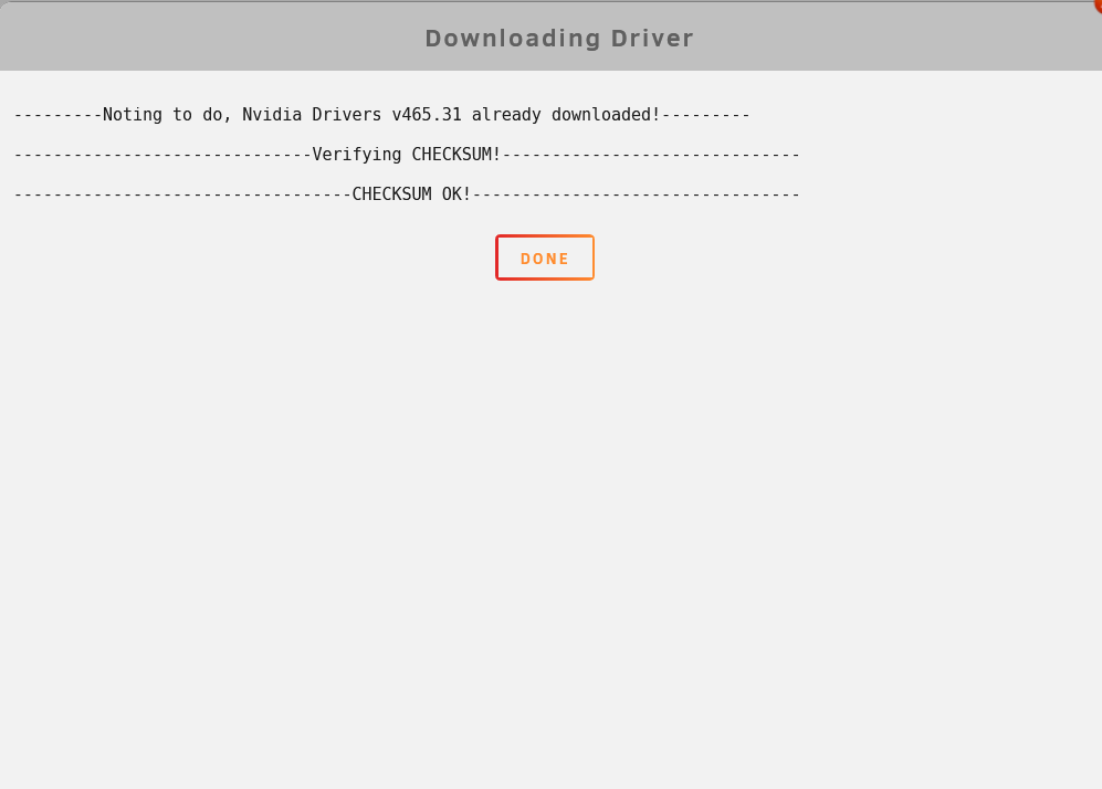

yeah, i think i found the problem, the driver installer is trying to use IPv6, and unraid itself isn't setup for that. i'm going to temporary disable the second NIC by unplug the fiber (which is setup for IPv6) and then try again.
the files are there where they belong, i uploaded it to unraid ;)
and 8.8.8.8 is banned on my network (i did found some reference to 8.8.8.8 in this plugin)
jup, found the problem, disabled the second NIC and tried again, its finished and its report me to reboot the server ;)
Edited by sjaak
What do you mean with that, the Driver Plugin only uses wget to download files...
Seems like there is something not configured properly...
This is always a bad idea to block the Google DNS server, why would you do that? :D
The plugin tries to ping 8.8.8.8 because it's an anycast IP address and is basically always online, just a little side note: not only my plugin tries to connect to 8.8.8.8 to check if there is actually a internet connection available...
In this case the boot takes about 30 seconds longer.
