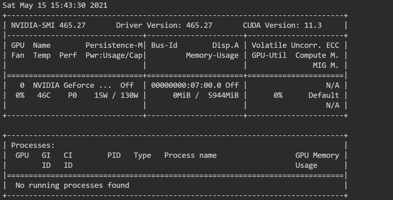

  6. So I did the reboot and it looks like persistenced is off but its still transcoding fine
  7. I have it working now. It didnt work on the first attempt though, I checked my plugins and there was an error with gpu statistics, deleted the error, updated all plugins, restarted docker, and now Plex and Jellyfin are working with persistence mode enabled. Is it possible an outdated plugin could have caused the problem?

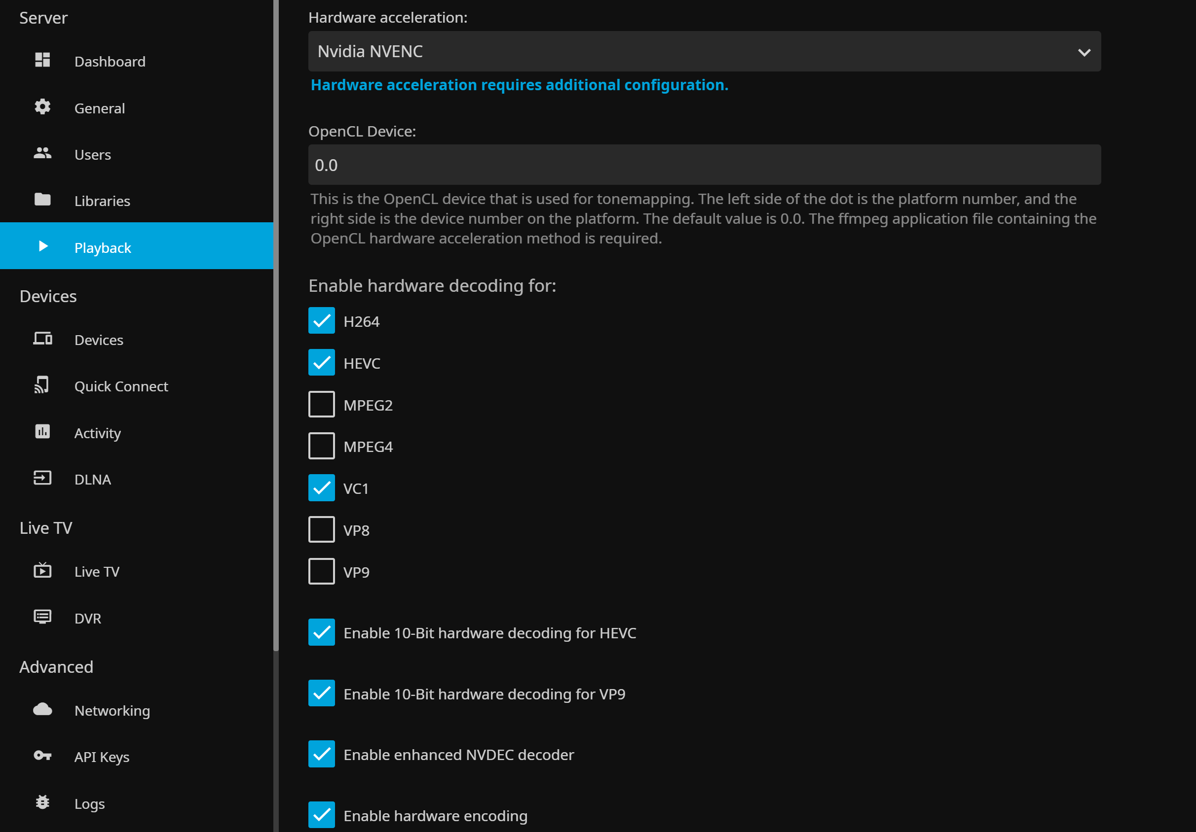

  12. The behavior didn't change checking all the boxes either. Tried that driver previously and rebooted before and after installing the plugin and driver, also disabled/enabled the docker. I honestly have no idea if this GPU had a power connector, its been in the server for a year now and worked perfect previously. If there was a connector it has to be connected, I used to use it to play games in a VM and it never struggled I've actually had this problem ever since the previous plugin stopped receiving updates, when there were Nvidia versions of the beta. Once I changed over to the official versions the GPU stopped working for transcoding entirely I have no idea if something when wrong when the OS updated either las-noches-diagnostics-20210515-1600.zip

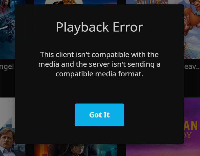

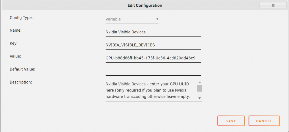

  13. Sorry misread that part. So with this one the videos either do the same thing, wont use the GPU, or I get this playback error GPU seems to still be detected

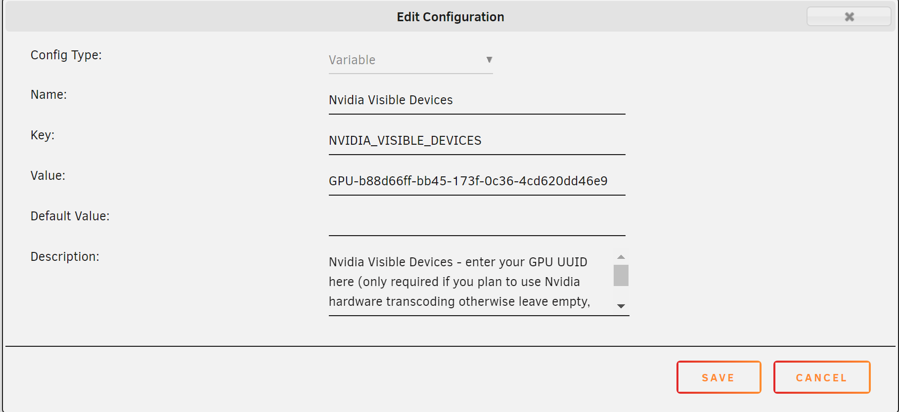

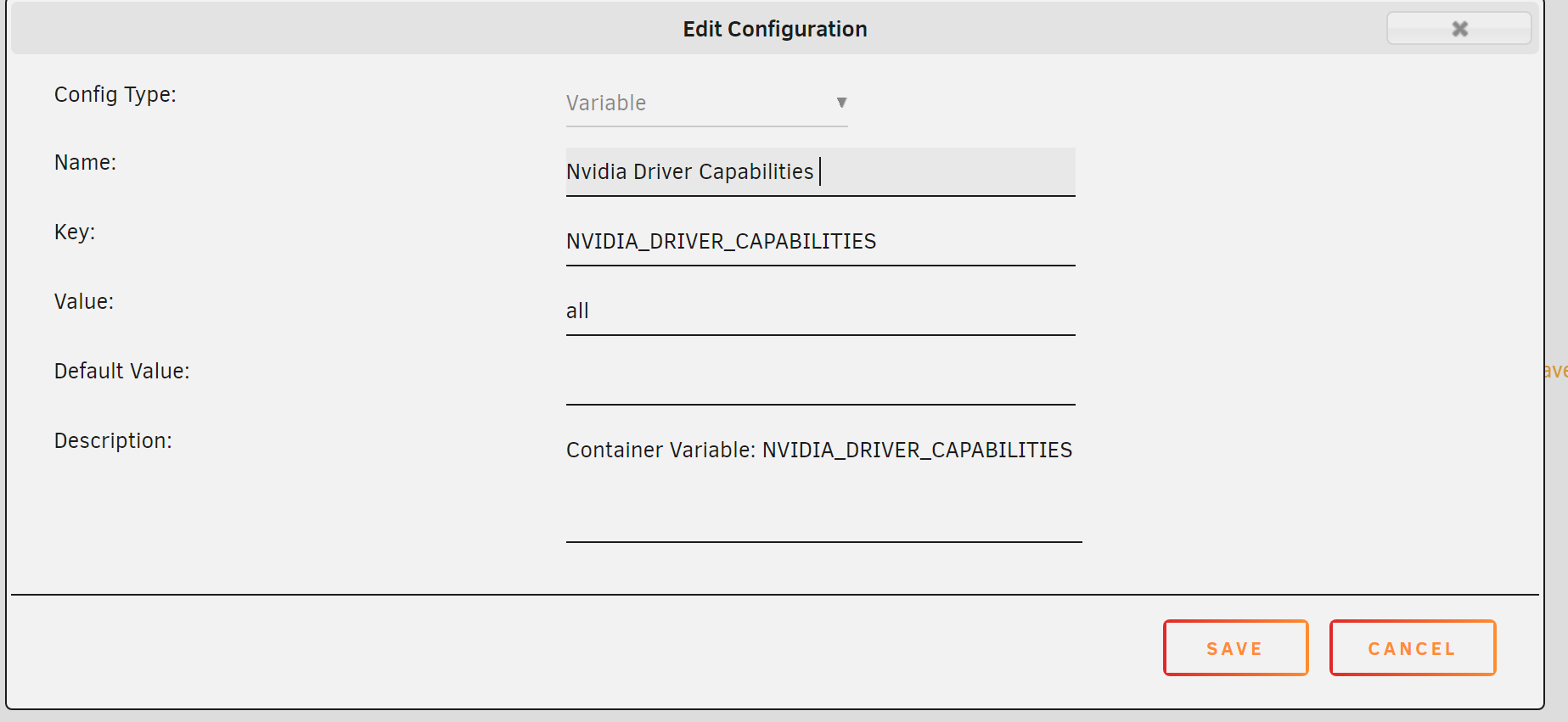

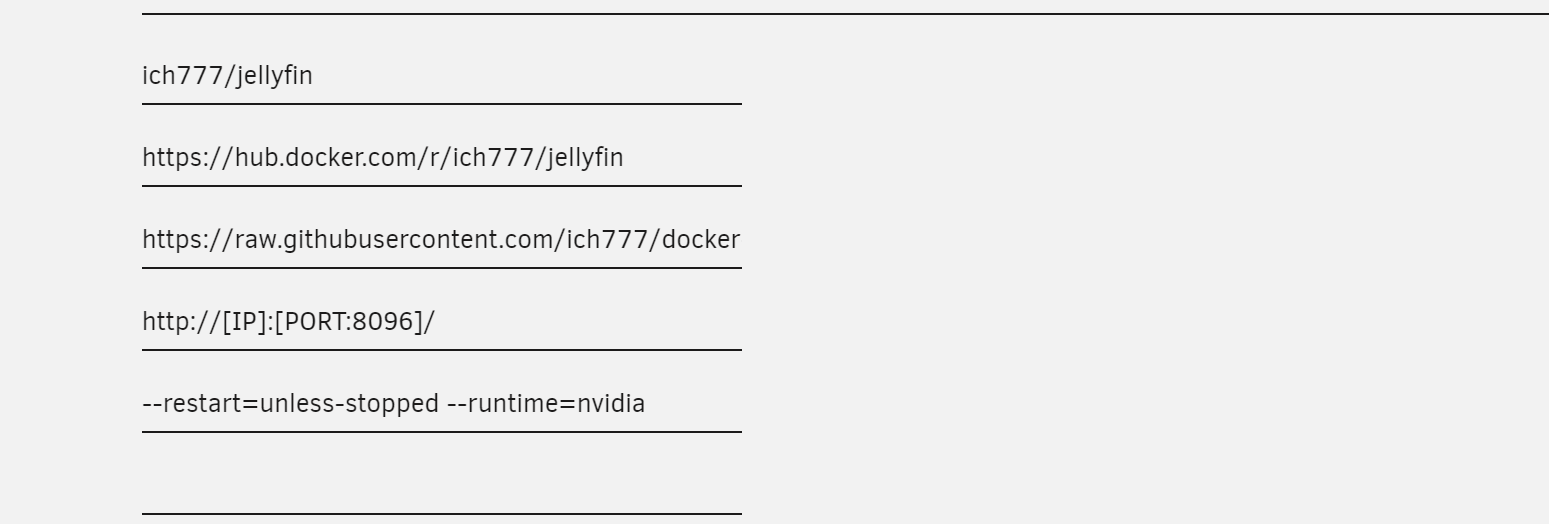

  14. Just installed binhex-jellyfin to test and same behavior Added the variables, enabled HW transcoding in the settings, CPU still doing all the transcoding Card never leaves the P0 power state
  15. NVIDIA Corporation TU116 [GeForce GTX 1660] I've attempted 1080p > 720p with h.264 and h.265, 4k > 1080p, all were .mp4 and .mkv Movies, TV shows, ignores the GPU every time
