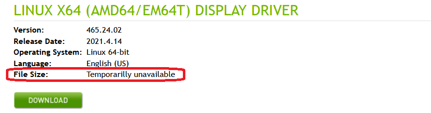

Hi @ich777,
I've seen the latest New Feature Branch driver 465.24.02 is now available in the settings page. Could you also make the latest Production Branch driver 460.73.01 available please ?
The download page for this one also indicates "File Size: Temporarily unavailable", but the download link is fine, I just downloaded and installed it on another machine.
Thanks for the great job, as usual 😉
Done:
Thanks @ich777, quick and efficient, as usual ! I have a strong preference in Production branch rather than the New Features one on my server ...
The problem with the drivers is that it is not that easy to get the drivers and version numbers easily that Nvidia announces to compile them (the latest new features branch isn't even on their public available download server...). :/
Anyways if you are missing a driver feel free to write a short message in this thread and I will try to compile them ASAP (keep in mind I will only compile new drivers... ;)

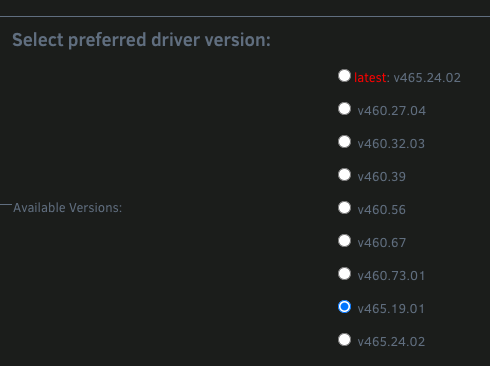

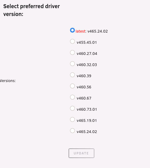

hi @ich777 me again with another very minor niggle with this plugin, any chance you can sort the version numbers for the nvidia drivers in descending order, the order looks a bit weird to me as it is right now, screenshot:-
to me a more sensible order would be:-
latest v465.24.02
v465.24.02
v465.19.01
v460.67
v460.56
v460.39
v460.32.03
v460.27.04
what do you think?.
3 minutes ago, binhex said:
what do you think?.
I've already seen that but need some input what would be best... :D
I have a few solutions to this:
  • move the latest tag to the bottom
  • let the latest tag on top and set it a little apart from the other version numbers
  • remove the version number from the latest tag completely
  • or like you said sort it in descending order
I left the latest tag on top of it because I thought it would be best to set it apart from the latest version number to avoid confusion so that you don't have two identical version numbers line by line.
Also thought about a dropdown but I think the radio buttons are more user friendly.
