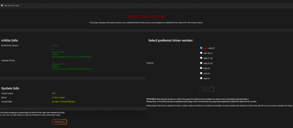

Its still happening. Checked the plugin error tab and nvidia driver is showing up.
EDIT: I think i fixed it, On the Nvidia Driver settings tab. I selected v460.67 instead of Latest and that seemed to fix it.  I should've read this part
"Please keep in mind if you update Unraid to a newer version and there is no internet connection on boot available the download of the driver will fail and you have to reinstall the Plugin."
Since Adguard docker isn't running yet after a reboot it would make sense that it cant connect to the internet yet
lowkey-diagnostics-20210323-1837.zip
Edited by mkayze

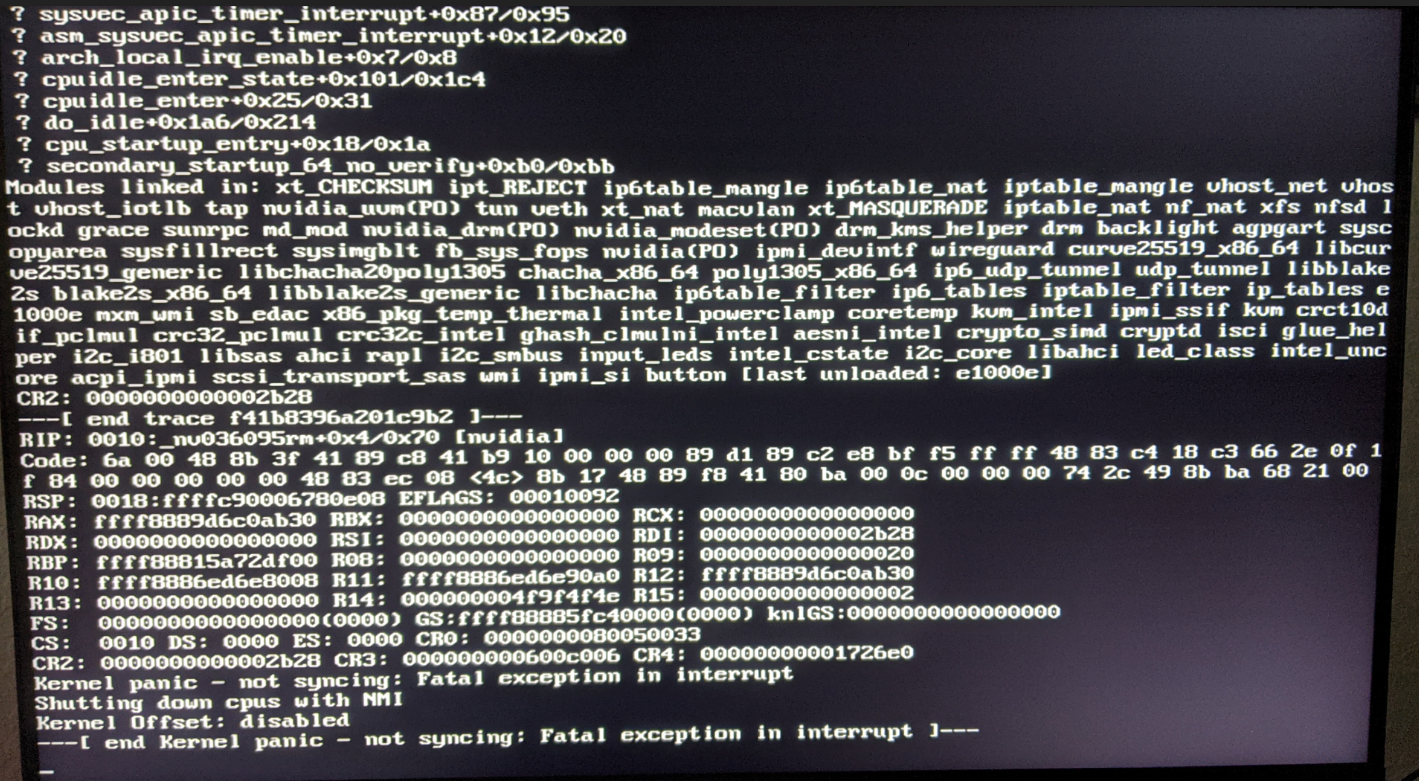

Has anyone here experienced this error happening? I am on 6.9.1 and using the latest nvidia driver (v460.67). I am running a Quadro P2200 for Plex transcoding and a GT710 for Unraid video out.
I've had this error appear 4 times since Sunday, and it completely locks up the server, requiring a hard reset and parity check.
The line in particular that makes me think it's related to the driver is this one, right after the end trace (maybe I'm wrong... idk):
RIP: 0010:_nv036095rm+0x4/0x70 [nvidia]
I also want to say that it seems like it started after I updated to this latest driver (v460.67).
The first time it happened, I had to uninstall and re-install the driver because I wasn't able to get DNS to work without PiHole, but I fixed that, and the driver is back installed and working. I can transcode in Plex still. The error just randomly happens.
I was going try reverting the driver back to an earlier version to see if it helps, but was just curious if anyone else had seen this, or could tell me what to do to troubleshoot it.
Error:
Nvidia Driver Package:
GPU Statistics w/ transcoding working:
Can you try to pull the GT710 from the server if you only use it for video output?
Because you can actually use the P2000 for video out and Plex at the same time and it will also save power.
I can't imagine that's the problem but you can at least try it.
Please report back.
Oh, wow. That just goes to show how much of a newb I am. lol
I had no idea I could run the video for Unraid on the same GPU as my transcoding GPU.
GT710 has been removed. Unraid video out and Plex transcoding confirmed working on just the P2200.
Will report back in a few days if it hasn't happened by then.

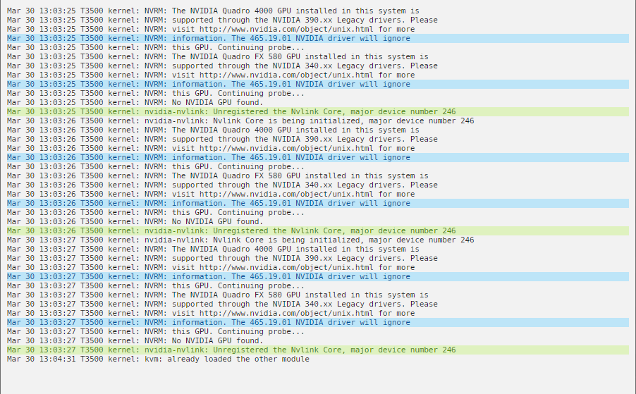

Following the installation I ran into the dreaded "NVIDIA-SMI has failed because it couldn't communicate with the NVIDIA driver."
I do not believe there is an issue with the hardware, and I've made sure that neither of the two GPUs are bound to VFIO (they do appear in the PCI Devices and IOMMU Groups under System Devices in Unraid.)
Another odd thing I found while following along SpaceInvader One's setup video (utilizes this plugin) was that after I added the "GPU Statistics" plugin none of my GPUs appeared on the dropdown list:
While debugging this issue I made sure that the settings in my BIOs we're OK and during a reboot I decided to check the system logs and saw this:
Which reads
Unregistered the Nvlink Core, major device number 246
Nvlink Core is being initialized, major device number 246
The NVIDIA Quadro 4000 GPU installed in this system is supported through the NVIDIA 390.xx Legacy drivers. Please visit http://www.nvidia.com/object/unix.html for more information. The 465.19.01 NVIDIA driver will ignore this GPU. Continuing probe...
Could this be a part of my issue?
Thanks for all your help 😃
To use the card in Docker containers you have to be at least on Kepler and your card is Fermi based so to speak you can't use this card in Docker containers because it's simply too old and not supported by the driver.
Visit the link that you have linked in your post (this is also the link in the first post to the supported cards) and you see a list of cards when you click on the corresponding driver (I know currently the driver version 465.19.01 isn't listed there but you can click on the latest that is available version 460.67 - this is actually the same list and applies to newer drivers as well).
