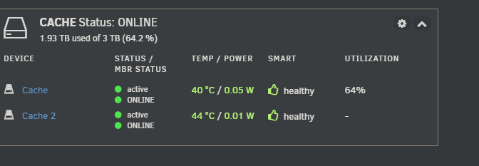

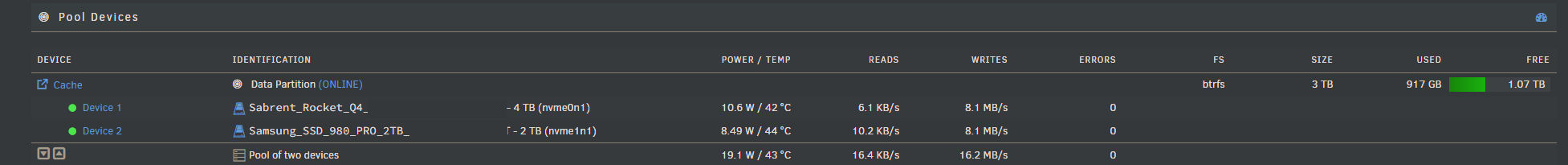

  2. Interesting. In my use case, these two screenshots seem to report different metrics for usable space (the Main page reports correctly in that 2TB is "usable", but the math on the Dashboard reporting doesn't seem to be mathing: Dashboard: Main:
