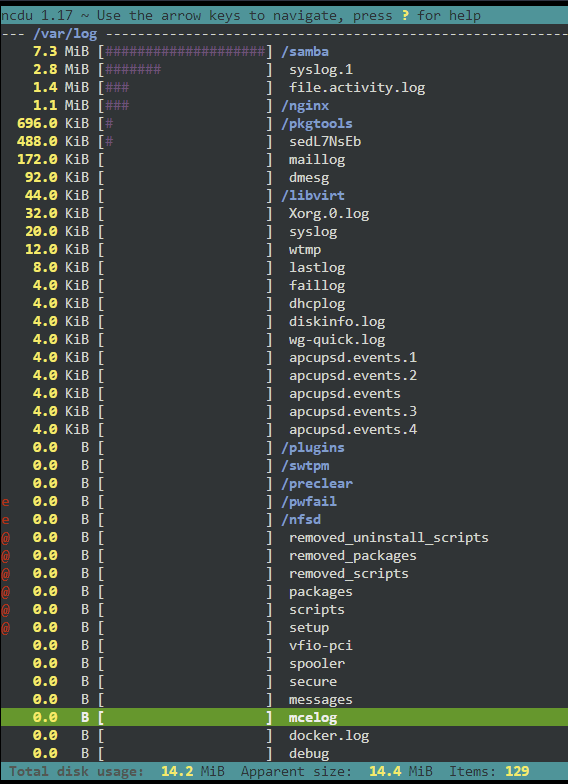

  21. Samba logs are definitely contributing, but not to the extent I was hoping for:
  22. Thanks for the suggestion. I will try that later today. I'm trying to avoid a full reboot as the Poweredge server I have Unraid on will always fail to reboot successfully (some IDRAC error, can't recall offhand). Needs to be powered off at the server itself then turned back on and wait 15 minutes.
  23. I had tried deleting a 10MB docker.log.1 file, but that didn't reduce the space at all. That said, I deleted 2 older syslog files (.1 and .2, at 3MB a piece), and it drop the log file a little. What I don't get is the disparity between the space in use, and what space is free: df -h /var/log Filesystem Size Used Avail Use% Mounted on tmpfs 128M 118M 11M 92% /var/log ls -sh /var/log total 4.5M 32K Xorg.0.log 0 cron 1.4M file.activity.log 0 nginx/ 0 removed_scripts@ 0 swtpm/ 4.0K apcupsd.events 0 debug 8.0K lastlog 0 packages@ 0 removed_uninstall_scripts@ 2.9M syslog 4.0K apcupsd.events.1 4.0K dhcplog 0 libvirt/ 0 pkgtools/ 0 samba/ 0 vfio-pci 4.0K apcupsd.events.2 4.0K diskinfo.log 172K maillog 0 plugins/ 0 scripts@ 4.0K wg-quick.log 4.0K apcupsd.events.3 92K dmesg 0 mcelog 0 preclear/ 0 secure 12K wtmp 4.0K apcupsd.events.4 0 docker.log 0 messages 0 pwfail/ 0 setup@ 0 btmp 4.0K faillog 0 nfsd/ 0 removed_packages@ 0 spooler Whereabouts is the extra space being used?
  24. Eureka! There were 2 containers spontaneously rebooting every minute. Authelia and Cachet-URL-Monitor (former for a failed migration (apparently it thinks my DB is corrupt so that'll be fun to sort) and the latter because the Cachet container was off and it couldn't communicate). Since stopping both containers, the promiscous logs have finally stopped. Thank you for your (and @trurl's) help! Is there a way to drop the percentage of the log file without a full reboot?
