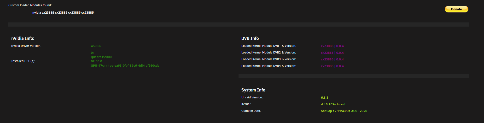

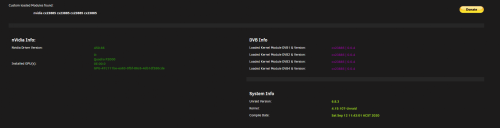

Sorry if this has already been mentioned, but will this work if you're using a custom build already (say, LSIOs nVidia build), or does it need to be stock before making any changes? My understanding was given you're overriding the existing files in /boot, it should just "work". I've gone through and built a custom build with nVidia and DVB enabled (I'm on Unraid 6.8.3), overwrote the files within /boot with the newly compiled drivers (using WinSCP to get to the boot drive) and rebooted. The LSIO nVidia build remains after reboot The log file don't show anything to have failed when I built the custom build myself using the CA App (logs attached). I've also tried using a prebuild 6.8.3 with nVidia and DVB enabled but the same result. Not sure if I'm missing anything? EDIT: For whatever reason, recompiling the same settings for a third time (nothing changed), it now loads both nVidia and DVB drivers (attached log): Thanks for your hard work @ich777! 2020-09-12_10.29.31.log 2020-09-12_11.38.43.log
