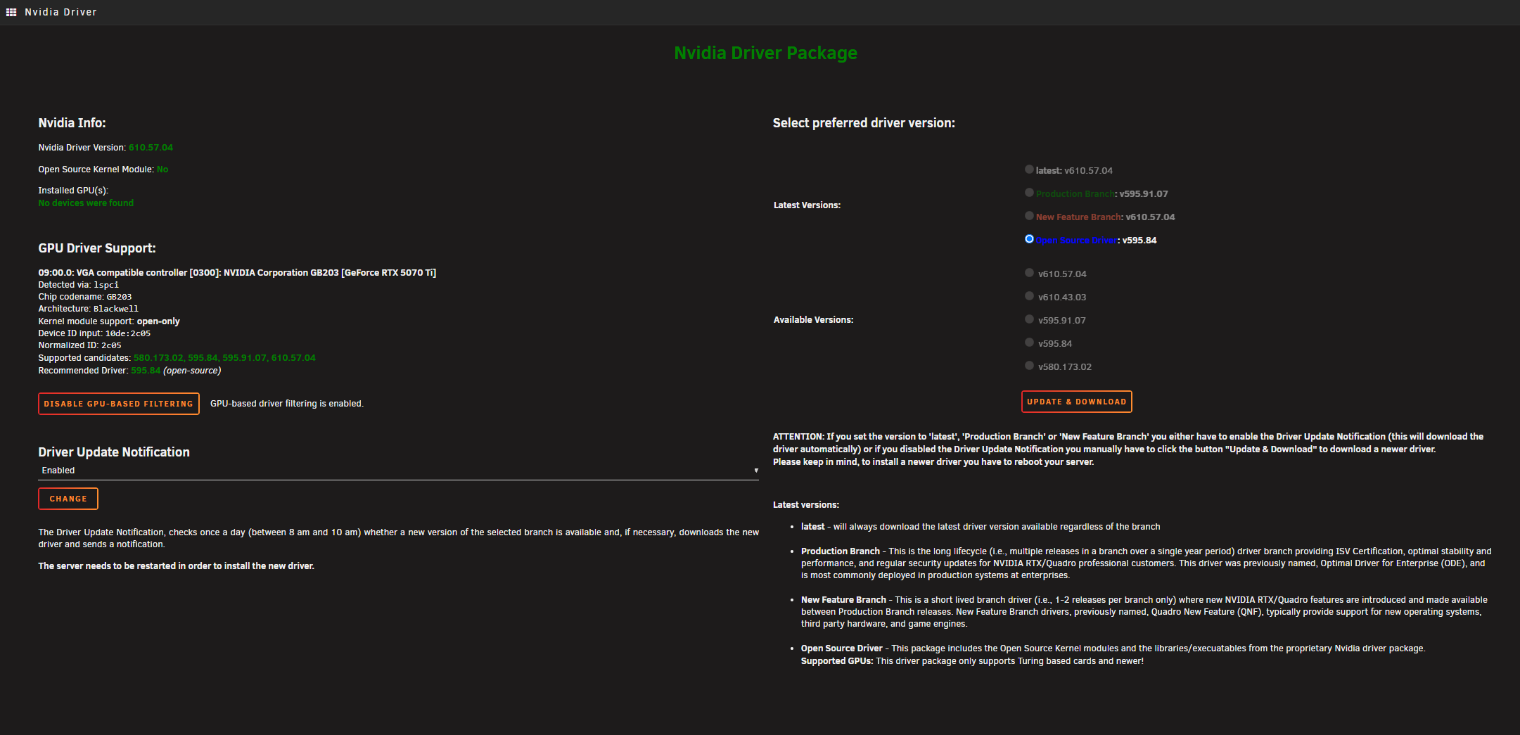

I'm running Unraid 7.3.4 (kernel 6.18.58-Unraid) with an NVIDIA RTX PRO 4000 Blackwell SFF Edition.
On Unraid 7.3.3 (kernel 6.18.54), I was running NVIDIA 595.104.02 using the open-source kernel module. Frigate GPU video decoding worked correctly for all four cameras.
After updating to Unraid 7.3.4, the NVIDIA plugin selected open-module 580.196.07 because that was the available open-module package for the new kernel.
The GPU is recognized and CUDA workloads work correctly, including Frigate object detection, Ollama, and Immich. However, Frigate's NVIDIA video decoding now fails for several H.264 streams with:
cuvidCreateDecoder ... CUDA_ERROR_INVALID_VALUE
The failures are stream-specific. Some streams decode correctly, while others fail. Testing with h264_cuvid succeeds on a stream where Frigate's current hardware-decoding path fails.
I would like to test a supported, precompiled NVIDIA 595 open-module package rather than install an unofficial build.
Would it be possible to provide an official nvos-595.104.02 or nvos-595.112.07 package for kernel 6.18.58-Unraid?
Also, is there a plan to allow users with Blackwell GPUs to select different open-source driver branches rather than only the currently packaged production branch?
I can provide sanitized diagnostics, exact FFmpeg commands, and test results if helpful.
Thank you!

I manually change it to 595.x now, and everything seems to be functioning just fine, but it does feel like the plugin is awry.
2 hours ago, jfoxwoosh said:
Updated to 7.3.4, but somehow Nvidia plugin got removed after reboot. Reinstalled the plugin, and the recommended driver version is 580.x for RTX2000Ada production branch. It used to be 595.x in 7.3.3.
Are you by chance not using a 50 series card? I noticed the same thing and I am stuck on 580.x because the open source driver. Unless I need to remove and re-add it?
I am using 5060 Ti
I am using 5060 Ti
My GPU is RTX 2000 Ada, so it is considered 40 series card. I still have an option to go to 595.x driver, but I am not sure if that is the open source version or not.image.png
