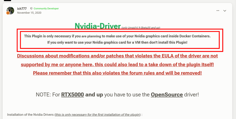

[Plugin] Nvidia-Driver
  • Replies 5.9k
  • Views 1.1m
  • To utilize your Nvidia graphics card in your Docker container(s) the basic steps are:   Add '--runtime=nvidia' in your Docker template in 'Extra Parameters' (you have to enable 'Advanced

On 11/15/2020 at 2:22 PM, ich777 said:
or RTX5000 and
