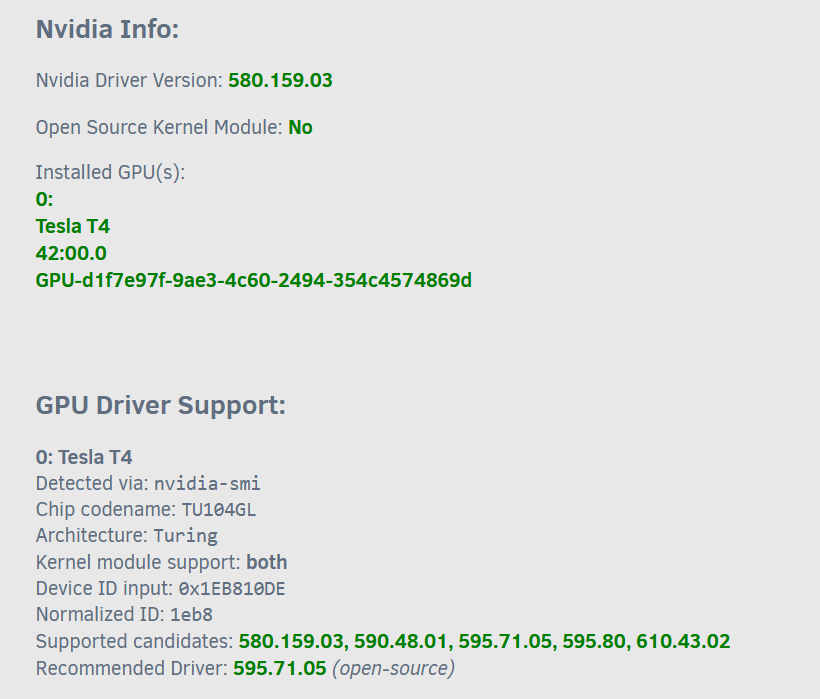

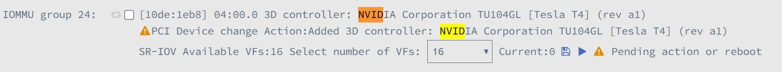

  1. Without re posting everything in its raw format, would anyone be able to shed some light on the following issue I'm having adding a 2nd GPU to my system and if the family of GPU would be the likely cause of my 2nd GPU not showing up? Adding 2nd GPU not showing to Unraid - General Support - Unraid TLDR - Have a P4, got a T4 but both dont seem to work together only 1 appears in the plugin while the other wont show but is detected by Unraid
  2. I have been running an Nvidia P4 for some time but have been looking to get an upgrade and I recently came across an Nvidia T4 unit and as my system supports multiple PCI I wanted to run them both side by side, When I login I'm able to see both GPU's in the System Devices but the newer T4 dosnt show up in any of the Nvidia tools or under nvidia-smi Should there be more I need to do about enabling it or if one is working should the other just work? Or is the generation gap between them not going to allow me to actually run both side by side? Yes I have rebooted the system as per the prompt but it still doesn't show in the Nvidia app etc. Is anyone able to shed some guidance on getting two GPU's enabled? If its any help attached is the diag filedellbox-diagnostics-20260904-1528.zip EDIT When I remove the P4 it seems to allow the T4 to load and it seems to still be using the same supported driver it appears Is it having different generations the problem maybe?

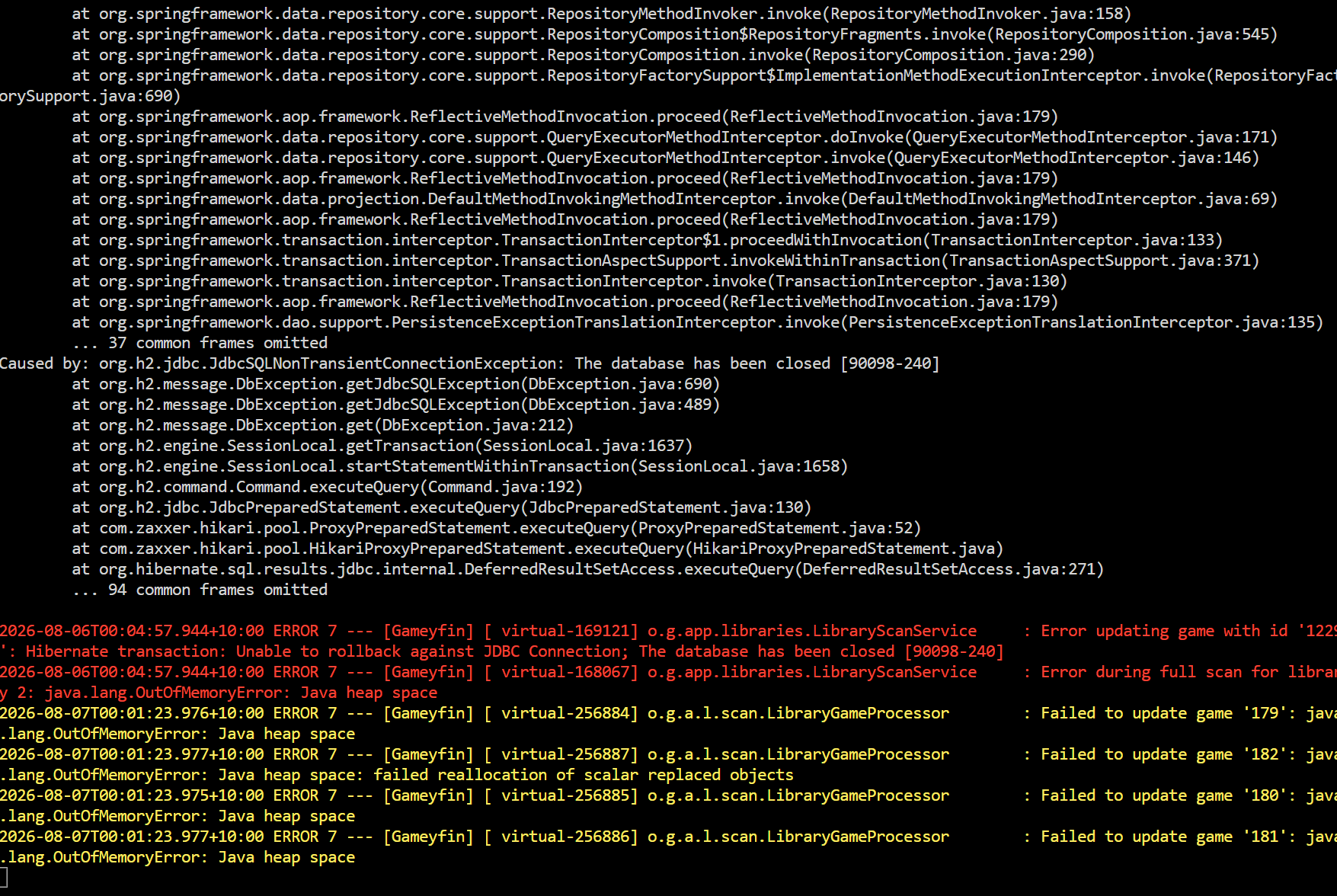

  5. Not sure if something with mine or something else but for some reason my instance was sucking my CPU dry Had the Java app running at crazy % Not sure if just the stage of development or an issue with the container but wanted to share, not sure if there is a way to kill when it hands
