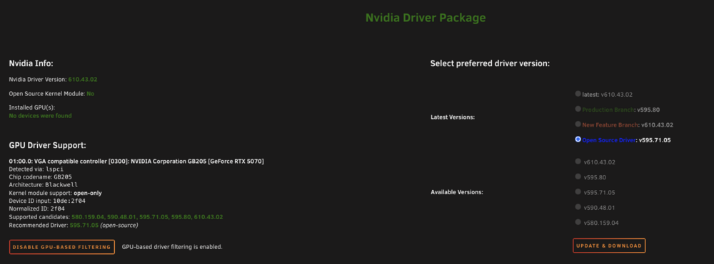

Something seems wrong with upgrade to 7.3.1 (at least I also have issues after doing so as well. Just haven't had time to get the diagnostic logs submitted). 5070.
Tried uninstalling, rebooting, reinstalling, etc.

Figured out needed to select the open source driver and reinstall

I cant get 610.43 to load for me, says I need to be on the open source driver for my setup (intel 14500, 5060). Any news on when that will be available? My x265 encoder I like updated and will only use 610
Just got this error when updating to 7.3.2
Similar to an above comment, is there a way to force the plugin to download the Open version of "New Feature Branch"? I want to get 610.x as it has some important fixes, but installing the new feature branch installs the closed source version which won't work on 5000 series cards.
