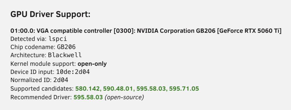

12 minutes ago, 123marvin123 said:
I attached my diagnostics. I'm trying to fall back to 580.142
No, because it isn't the OpenSource driver. Your syslog even mentions that:
Apr 30 22:04:56 Node804 kernel: NVRM: The NVIDIA GPU 0000:01:00.0 (PCI ID: 10de:2d04)
Apr 30 22:04:56 Node804 kernel: NVRM: installed in this system requires use of the NVIDIA open kernel modules.
Apr 30 22:04:56 Node804 kernel: NVRM: GPU 0000:01:00.0: RmInitAdapter failed! (0x22:0x56:897)
Apr 30 22:04:56 Node804 kernel: NVRM: GPU 0000:01:00.0: rm_init_adapter failed, device minor number 0
Why do you want to install the old driver?
Can you please also share your Diagnostics with the OpenSource driver installed?
Where does it mention that the 580 driver is compatible, do you have a screenshot?

I want to fall back to 580.142 because the 595.58.03 driver crashes when I turn off my virtual machine and the GPU control gets passed back to Unraid:
Apr 27 16:53:57 Node804 kernel: [drm] [nvidia-drm] [GPU ID 0x00000100] Loading driver
Apr 27 16:53:59 Node804 kernel: [drm] Initialized nvidia-drm 0.0.0 for 0000:01:00.0 on minor 1

The issue might be fixed in nvos-595.71.05.

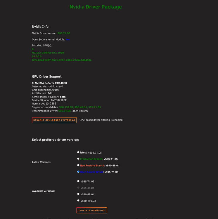

Please upgrade to Unraid 7.2.5 since the open source driver version 595.71.05 is available there.
Please also note that you can only use the Open Source driver with your 50 series card, no other driver will work.

thank for reply i have NVIDIA GeForce RTX 4060 now switch to open source driver still the same error
docker run
  -d
  --name='llama.cpp'
  --net='br0'
  --ip='192.168.0.82'
  --pids-limit 2048
  -e HOST_OS="Unraid"
  -e HOST_HOSTNAME="GNAS"
  -e HOST_CONTAINERNAME="llama.cpp"
  -e 'TCP_PORT_8000'='8080'
  -e 'CA_TS_FALLBACK_DIR'='/models'
  -l net.unraid.docker.webui='http://[IP]:[PORT:8080]/'
  -v '/mnt/ncache/appdata/llama.cpp/models':'/models':'rw'
  --gpus all 'ghcr.io/ggml-org/llama.cpp:server-cuda'
f9238272f96172115220e760c98ae6daab201d5664e67e80b912c1592ff8c1e8
docker: Error response from daemon: failed to create task for container: failed to create shim task: OCI runtime create failed: runc create failed: unable to start container process: error during container init: error running prestart hook #0: exit status 1, stdout: , stderr: Auto-detected mode as 'legacy'
nvidia-container-cli: ldcache error: process /sbin/ldconfig failed with error code: 1
Run 'docker run --help' for more information
The command failed.
Edited by Gvon

9 minutes ago, Gvon said:
sorry my bad here the Diagnostics
Did you read the post to upgrade the plugin to 2026.05.01, reboot and try again?
i already did check for update twice but it's say 2026.03.19 up-to-date did i miss something?
edit remove and install again still on 2026.03.19
Edited by Gvon
Wait a few minutes and try again.
ok thank you
