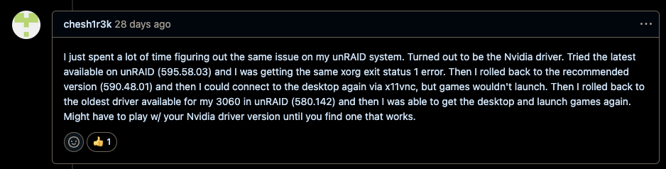

PPS: linuxserver.io: "Nvidia support only works on 580 and up full proprietary drivers (no MIT/GPL)" so not suitable for me at all (blackwell architecture, open source, you know that way better than me).
Edited by anticholium
another unraid user was able to resolve the same bug by rolling back to 580.142, since he has a RTX 3060, so not dependent on open source kernel modules. 590.48.01 did only work partially... Any thougts on that? the linuxserver image, as expected, didn't work because of not supporting open source driver... – any "clean" option to manually downgrade to https://github.com/unraid/unraid-nvidia-driver/releases/download/6.12.54-Unraid/nvos-580.95.05-6.12.54-Unraid-1.txz ?
https://github.com/Steam-Headless/docker-steam-headless/issues/224
