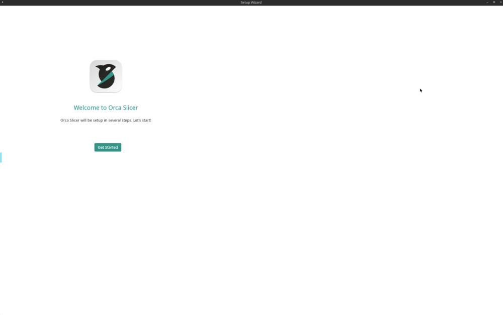

After opening the Webgui (just gray background):

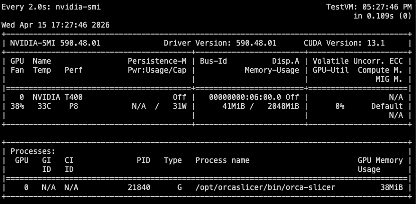

  • To utilize your Nvidia graphics card in your Docker container(s) the basic steps are:   Add '--runtime=nvidia' in your Docker template in 'Extra Parameters' (you have to enable 'Advanced
  • Recompiled the drivers and they are now just working fine (to get it working scroll down):   Please do the following (this is only necessary if you upgraded before I recompiled the dri
  • I'm currently spinning up my build VM and compiling the drivers again, currently drivers for 6.11.0 stable are not available...

I thought I can wait until Nvidia releases the new Container Toolkit 1.19.0 but it seems I have to look into it now and create a patched version for Unraid.
@AvoooCadoo & @rpetrina14 on what Unraid version are you and which driver version do you have installed, this is essential to know what drivers to recompile:
I also give you the log but I really don't know if that is that important here since it's running just fine:
Container output

However as said, I need your Unraid version and the driver version that you are currently on since I need to recompile the driver with the new runtime - if you are on Unraid 7.2.4 you can already try the Open Source driver version 590.48.01 which is already updated (please note that only Ampere and up will work with the Open Source driver), you might have to redownload the driver if you are already on that version.
I also fogot to post proofe that it actually uses the card (just the output from nvidia-smi and I move the build plate rapidly to produce some load):
I went through and ran this same test and noticed same results still just a black screen.
On Unraid 7.2.4
UnRAID 7.2.4 and driver version 580.142

Just now, M1K3Y said:
I followed step 1 and got it to force re-download. I then rebooted.
I still get the same black screen here's more of my logs
Something seems wrong with this installation, however have you yet considered to completely remove the container including all the data for the container in your appdata directory and start over, however something seems still wrong since you have some odd lines in your log, but I also think that's from a previous start but I can't tell for sure.

I'm not 100% sure how I can help since the driver is now fixed.
Please next time post your log in a box and not in plain text. :)

53 minutes ago, ich777 said:
Build is running, please give it a bit, in the meantime please uninstall the plugin.
I'll update this post here when it's done.
EDIT: @rpetrina14 the driver is now rebuilt, please install the plugin again and reboot afterwards.

running prestart hook #0: exit status 1, stdout: , stderr: Auto-detected
mode as 'legacy'
nvidia-container-cli: ldcache error: process /sbin/ldconfig failed with
error code: 1: unknown
edit: had to restore the last known good unraid flash backup to get open sourced 590 driver and my GPUs working again. Really not sure if it was the 595 driver update or something got corrupted. I had updated to the 595 driver, didnt reboot yet because I was hitting the 3090 with a lot of LLM requests and it seemingly froze the 3090. Upon rebooting, 595 was active and both the 3090 and 5060ti were detected but I kept getting the ldconfig errors when trying to load docker containers that used the GPUs
