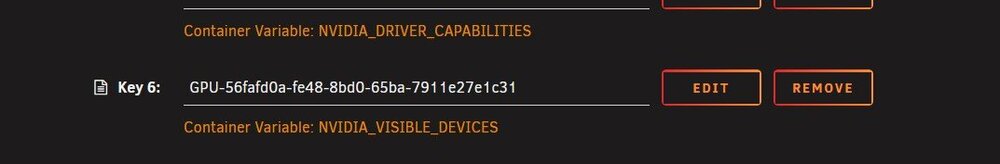

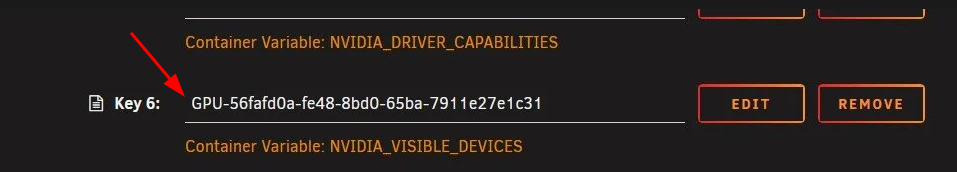

12 hours ago, djtodd said:
Are you 100% sure that there is no space at the beginning, it looks like there is one space there:
Yeah, not a space. Looks like one! Had my hopes up for a minute that I pulled a classic IT fat finger.

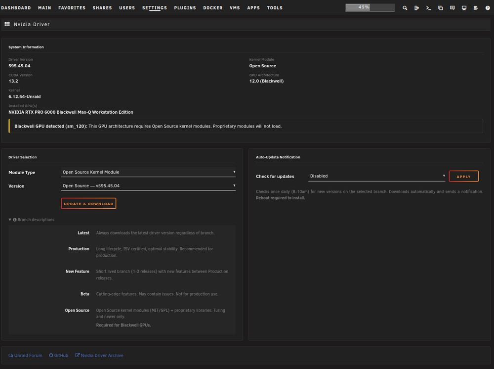

I updated my PR for this Repo. So that its mergable again.
Contains an automatic build pipeline and new UI/UX design.
(only dark because of my browser settings. for you it's probably not dark ;-))
PR: https://github.com/unraid/unraid-nvidia-driver/pull/7
best regards
Edited by Valtos

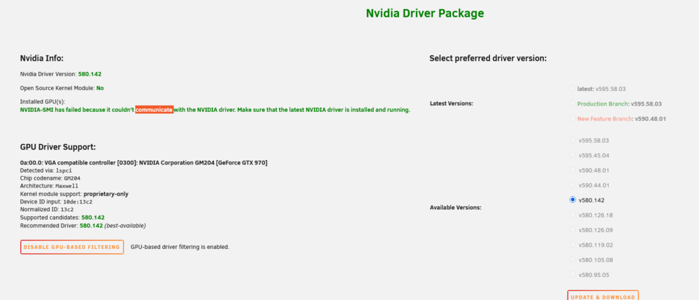

I have started a second Unraid server and installed a Nvidia GTX 970 in it. I am getting an error nvidia-smi not able to communicate. I have tried several of the troubleshooting ideas that are listed in this topic. Anybody have any ideas. I have tried moving the driver versions, uninstalled and reinstalled the plugin. This is in a Dell T320. I also have a Dell 720 with a GTX 1080. In the Dell 720 the plugin does not recognize the integrated video card but in the T320 it does.
@SimonF would you mind taking a look at that since this would revert pretty much everything from your PR.
@Valtos depending on what @SimonF says, does the PR or better speaking also take into consideration that a user has multiple GPUs installed in his system?
If so is there an index displayed? I would also like to turn the logic around for the driver so all drivers are OpenSource except for the legacy 580.x driver version, so to speak OpenSource goes away and it says Legacy there.
Please always post your Diagnostics, without them troubleshooting is impossible.
Sorry I was wondering about that after I saw several other posts.
memoryalpha-diagnostics-20260405-1533.zip
Please do the following from a Unraid Terminal:
echo "blacklist nouveau" > /boot/config/modprobe.d/nouveau.conf
after that reboot (you will get no output from the command).
This is caused because the card is bound to the nouveau instead to the nvidia driver as you can see here:
0a:00.0 VGA compatible controller [0300]: NVIDIA Corporation GM204 [GeForce GTX 970] [10de:13c2] (rev a1)
Subsystem: EVGA Corporation Device [3842:3975]
Kernel driver in use: nouveau
Kernel modules: nouveau, nvidia_drm, nvidia
Thank you very much that did it.

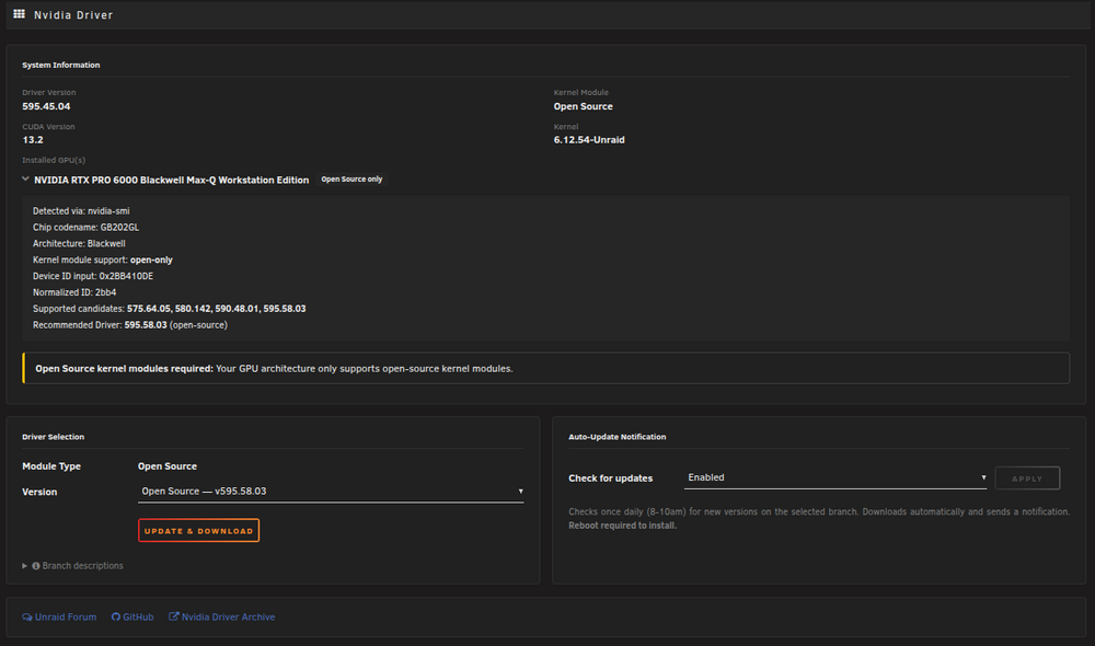

Done. The PR now handles multiple GPUs. Each GPU is listed in the System Info card with an expandable detail panel showing chip codename, architecture, device ID, kernel module support, and recommended driver (from gpu-support.php).
The module support is computed across all installed GPUs:
- If all GPUs support open-source -> auto-selected, no dropdown
- If all GPUs need proprietary (pre-Turing) -> auto-selected as "Legacy"
- If mixed (e.g. Turing + Blackwell) -> open-source (the common denominator)
- If conflicting (e.g. Volta + Blackwell) -> error banner, download disabled
Labels have been renamed: "Proprietary" -> "Legacy (Proprietary)" open-source is now the default. The module type dropdown is hidden entirely when only one option is valid.
best regards

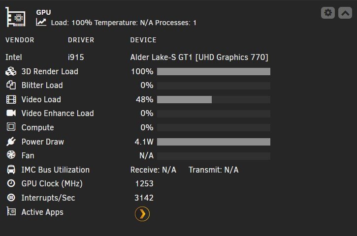

I just wanted to jump in again and thank @ich777 for nor only the Nvidia driver, but the iGPU one as well.
Having much better luck on my new Intel setup!
