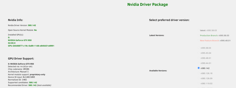

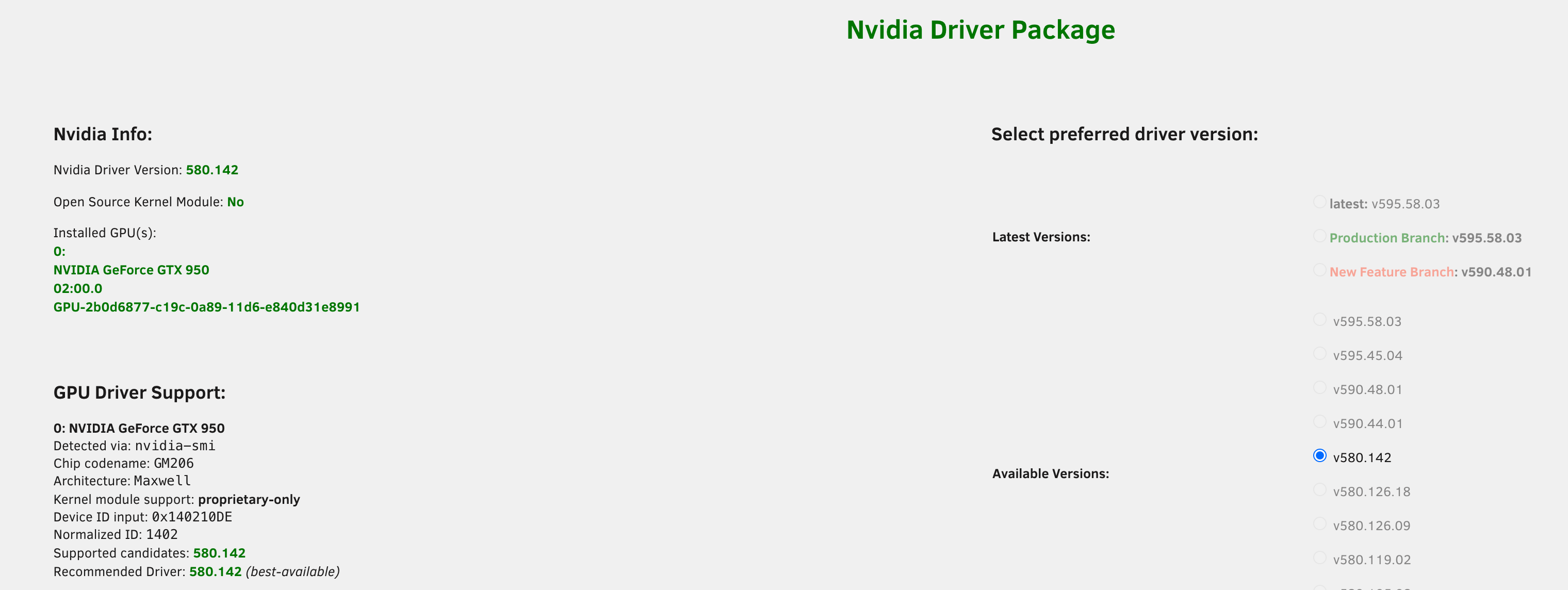

  1. Google is telling me support ended on my card with this version so this doesn't seem like the bug I thought it was.
  2. Howdy. I just noticed I'm also stuck on an old driver like the person above. Image and diagnostics attached. Thanks. unraid-diagnostics-20260413-0632.zip

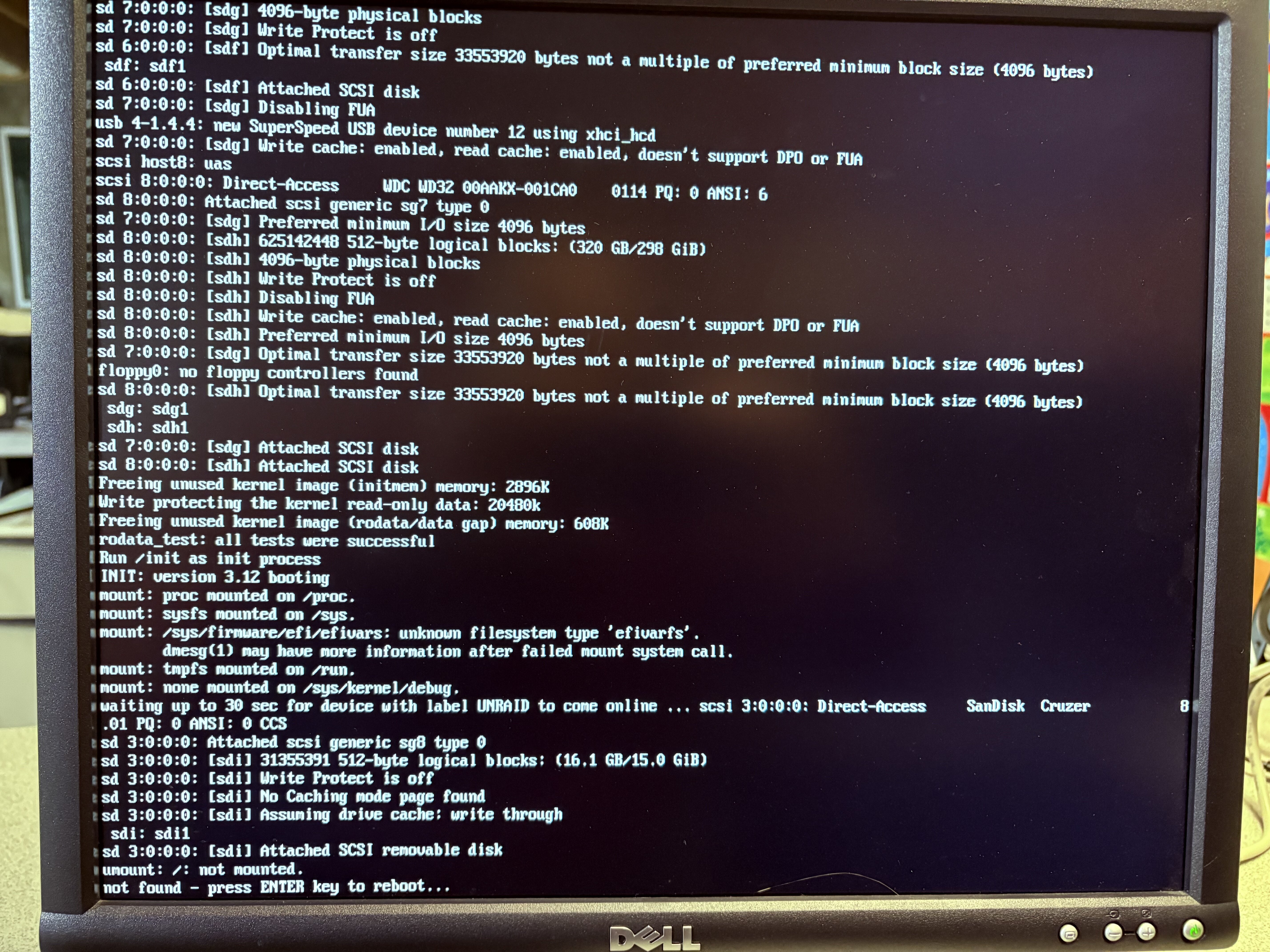

  4. Support had me test without my USB expansion drives and V7 boots so it appears it is something related to not finding the flash USB during the mount process.
  5. Generally same issue. Generic v7 image doesn't boot on my Dell PowerEdge T430. I've had a support issue #6232 open since the day of the release. V6 works, upgrade does not, V7 generic does not, v7 with config copy does not. I also completely remade the USB and that didn't help. NOTE: This is bare metal, not virtualized.
