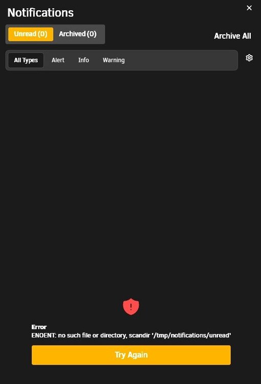

Hey Team,
I've been having an issue with my notifications for a while.
ENOENT: no such file or directory, scandir '/tmp/notifications/unread'
I booted into Safe Mode, and the issue went away. I have been slowly removing plugins to identify which one is breaking my notifications, and I think it's the Nvidia driver plugin. It was the last one removed because I wanted my Jellyfin Docker to stay up. Once I removed it, the issue didn't happen. When I reinstalled it, the notifications issue came back.
Thank you
The Nvidia driver Plugin doesn't do anything to the /tmp directory other than saving the version numbers.
