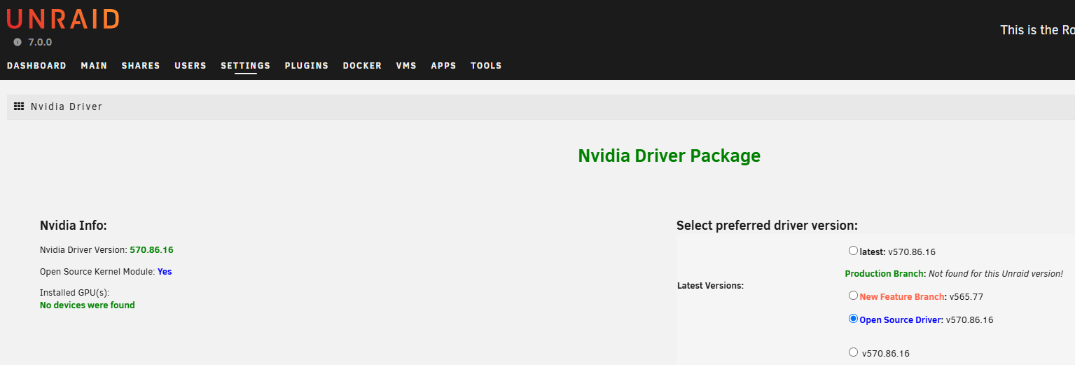

I just installed a ASUS TUF GeForce RTX 5070 Ti 16GB GDDR7 OC Edition GPU. and updated nvidia drivers, but its not being detected in the nvidia driver section, but with this prompt it shows its there just not initiated?image.png.130d710db2db4807e4a43d2d8728845b.png
Seems like the latest driver wont work with this GPU ?
On 4/23/2025 at 9:52 AM, ich777 said:
Diagnostics would help a lot for such specific questions and to diagnose the issue properly.
However 5000 Series cards only work with the Open Source drivers, please select the Open Source driver, wait for the Download to finish and reboot your server.
As @Mainfrezzer already pointed out, only the Open Source driver works with 5000series cards

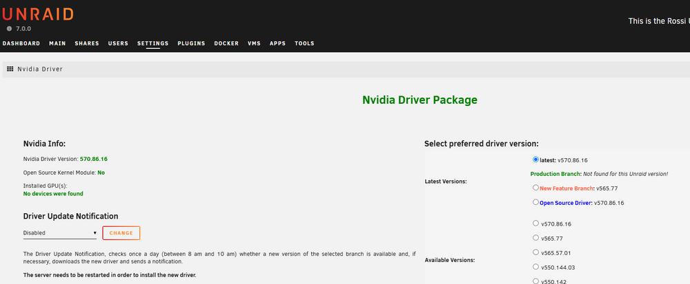

4 hours ago, Maximo101 said:
rebooted and still showing no GPU.
and you are sure its eated properly, has enough power supply (also power cables checked), ...
from the syslog (while your diags zip is mailformatted named ...)
May 18 18:03:59 RossiServer kernel: NVRM: Xid (PCI:0000:02:00): 79, GPU has fallen off the bus.
May 18 18:03:59 RossiServer kernel: NVRM: GPU 0000:02:00.0: GPU has fallen off the bus.
May 18 18:03:59 RossiServer kernel: NVRM: kgspRcAndNotifyAllChannels_IMPL: RC all channels for critical error 79.
May 18 18:03:59 RossiServer kernel: NVRM: _issueRpcAndWait: rpcSendMessage failed with status 0x0000000f for fn 78!
May 18 18:03:59 RossiServer kernel: NVRM: nvCheckOkFailedNoLog: Check failed: GPU lost from the bus [NV_ERR_GPU_IS_LOST] (0x0000000F) returned from nvdEngineDumpCallbackHelper(pGpu, pPrbEnc, pNvDumpState, pEngineCallback) @ nv_debug_dump.c:274
May 18 18:03:59 RossiServer kernel: NVRM: RmLogGpuCrash: RmLogGpuCrash: failed to save GPU crash data

I appreciate the response alturismo.
BIOS rBar is active already.
The PSU is new 850 watt, and its 8pin is firmly connected to the psu and gpu. GPU light is on.
The gpu is too big for my cs380 case so i am using  a PCIe 5 riser, i unplugged it from both ends and re seated it. It was a cheaper riser cable, but it is pcie5....
I dont want to use another pcie slot as that main one is the pcie5 one while the others are 4.
New diagnositics attached, does it show the same issue still? Still not showing in nvida drivers plug page.

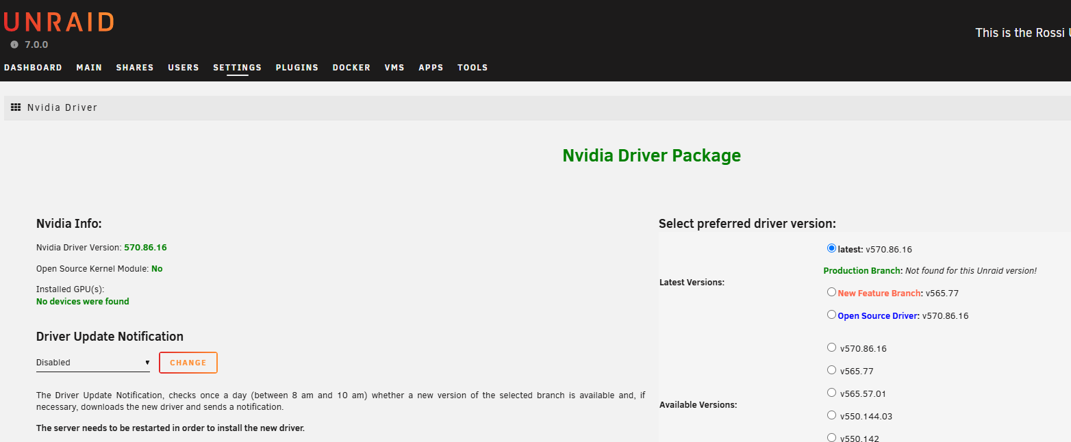

Yes:

At least similar, you have the XID error 79 which indicates a Bus error, maybe try to set the link gen for this specific PCIe interface to Gen4 or even Gen3 <- won't matter much if you are using the card only for transcoding, you can get more information about XID errors here and what they mean.
However I don't recommend using a riser at all because timing needs to be very precise and only a minimal interference can cause such an issue.
for testing purpose and exclude pcie slot, riser cable, ... issues, i would recommend to try it to exclude ...
also may the test run with a different OS, like mentioned.
and about pcie4 or 5 concerning some docker usage ... it really wont matter anyhow ;)
wont even in Gaming performance high end ... may RTX 70xx will profit ... may ... ;)
about pcie devices, yes, your card is there, but not really recognized ... usually there is also a model nr.

I'm experiencing the same issue as @Maximo101
I have an Inno3D RTX 5070Ti and a Quadro P4000 installed in an Asus Pro-WS-X570-ACE motherboard with an AMD 5950 CPU.
My Quadro P4000 is recognized with Nvidia driver v570.144, but my 5070Ti is not.
Both GPUs are visible in the system devices.
The Quadro P4000 is currently used for transcoding, and I would like to utilize the 5070Ti in a Windows 11 VM.
I'm unsure what BIOS settings need to be changed to make this work.
server-diagnostics-20250519-1624.zip

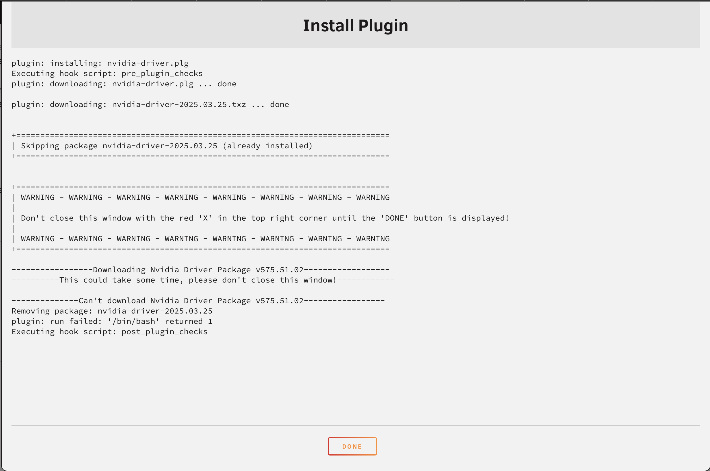

Hello,
I am having an issue trying to install the Nvidia-Driver plugin. I am new to Unraid so go easy on me.
I have looked through the forum and on the internet and could not find how to fix this.
I am running on unraid 7.1.2, 3060 GPU.

May 19 16:11:00 server rc.local: plugin: installing: nvidia-driver.plg
May 19 16:11:00 server rc.local: Executing hook script: pre_plugin_checks
May 19 16:11:00 server rc.local: +==============================================================================
May 19 16:11:00 server rc.local: | Installing new package /boot/config/plugins/nvidia-driver/nvidia-driver-2025.03.25.txz
May 19 16:11:00 server rc.local: Verifying package nvidia-driver-2025.03.25.txz.
May 19 16:11:00 server rc.local: Installing package nvidia-driver-2025.03.25.txz:
May 19 16:11:00 server rc.local: PACKAGE DESCRIPTION:
May 19 16:11:00 server rc.local: Package nvidia-driver-2025.03.25.txz installed.
May 19 16:11:00 server rc.local: --------------------Nvidia driver v570.144 found locally---------------------
May 19 16:11:00 server rc.local: --------------Installation of Nvidia driver v570.144 successful--------------
May 19 16:11:00 server rc.local: plugin: nvidia-driver.plg installed
May 19 16:11:00 server rc.local: Executing hook script: post_plugin_checks
may also check pcie slots, assignments, free pcie lanes on your board, etc etc ...

Do you have Diagnostics?
How long did you wait until you got the error? It seems that you installed the plugin already once, please remove the plugin (go to the Plugins page and make sure it's not listed there anymore) reboot and try to reinstall it and wait for the dialogue to display the DONE button.
