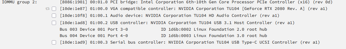

I've been having a strange issue the last 2 weeks, trying to get my RTX 2080 working in my server. Until 2 months ago, it was used for my vm. Then took the card out for egpu purpose, and now regret it.
I can se my card in system devices, but nvidia-smi shows no devices.
The card is quite hot and one of the two fans are spinning at maximum.
unraid-diagnostics-20250403-2157.zip
First of all, please remove those lines from your go file, these are not needed anymore:
# force iptable mangle module to load (required for *vpn dockers)
/sbin/modprobe iptable_mangle
modprobe i915
chmod -R 777 /dev/dri
(at least the last two lines are safe to remove).
You've also seen this (your syslog is full of those messages) :
Apr  3 16:00:01 unraid shfs: share cache full
Apr  3 16:00:01 unraid shfs: assign_disk: /appdata/tdarr/logs/Tdarr_Server_Log.txt (28) No space left on device
Because of those messages I can't extract any viable information from your syslog because as said, it's full of those messages, however from your previous boot I can see this message which indicates an issue with your card:
Apr  1 19:54:30 unraid kernel: NVRM: Xid (PCI:0000:01:00): 140, An uncorrectable ECC error detected (possible firmware handling failure) DRAM:-1840691974, LTC:0, MMU:0, PCIE:0
You can learn more about XID errors here, however Error code 140 usually means something is wrong with the hardware.

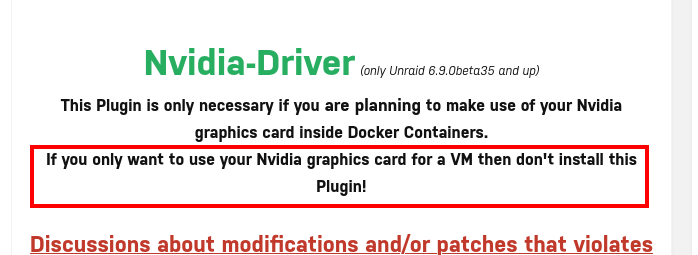

@ich777 Thank you for the quick response.
I'm an idiot.. Set the GPU to vfio at boot and made a vm with both virtuel and the gpu.
At boot the VM showed "Connect the PCIe power cables for all graphic cards". Then i remembered my PCIe extender cables were not connected in the other end...
Now its working again.

You are also mentioning that you using the card for usage in VM, you know that you shouldn't install this plugin if you are using the card in VMs, first post in this thread:
OK, that explains it. Thanks for the explanation.

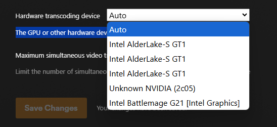

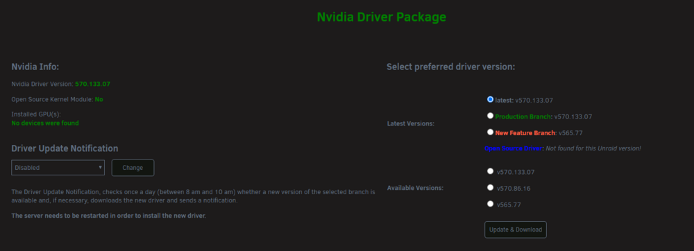

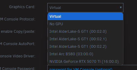

Hi All,
I'm currently having issues getting my 5070 ti not being detected. Currently running on 7.1.0-rc1 due to battlemage support.
Plex docker detects it with the app, and VMs can see it but the NVIDIA plugin is returning no devices.
Plugin
Plex
VM
I do see interesting logs but from the driver plugin i can't use the open source ones
diagnostics-20250412-1042.zip
Please go to the plugin page again and select the Open Source driver (blue one), click Update & Download, wait for the download to finish and reboot your server.

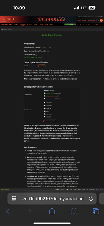

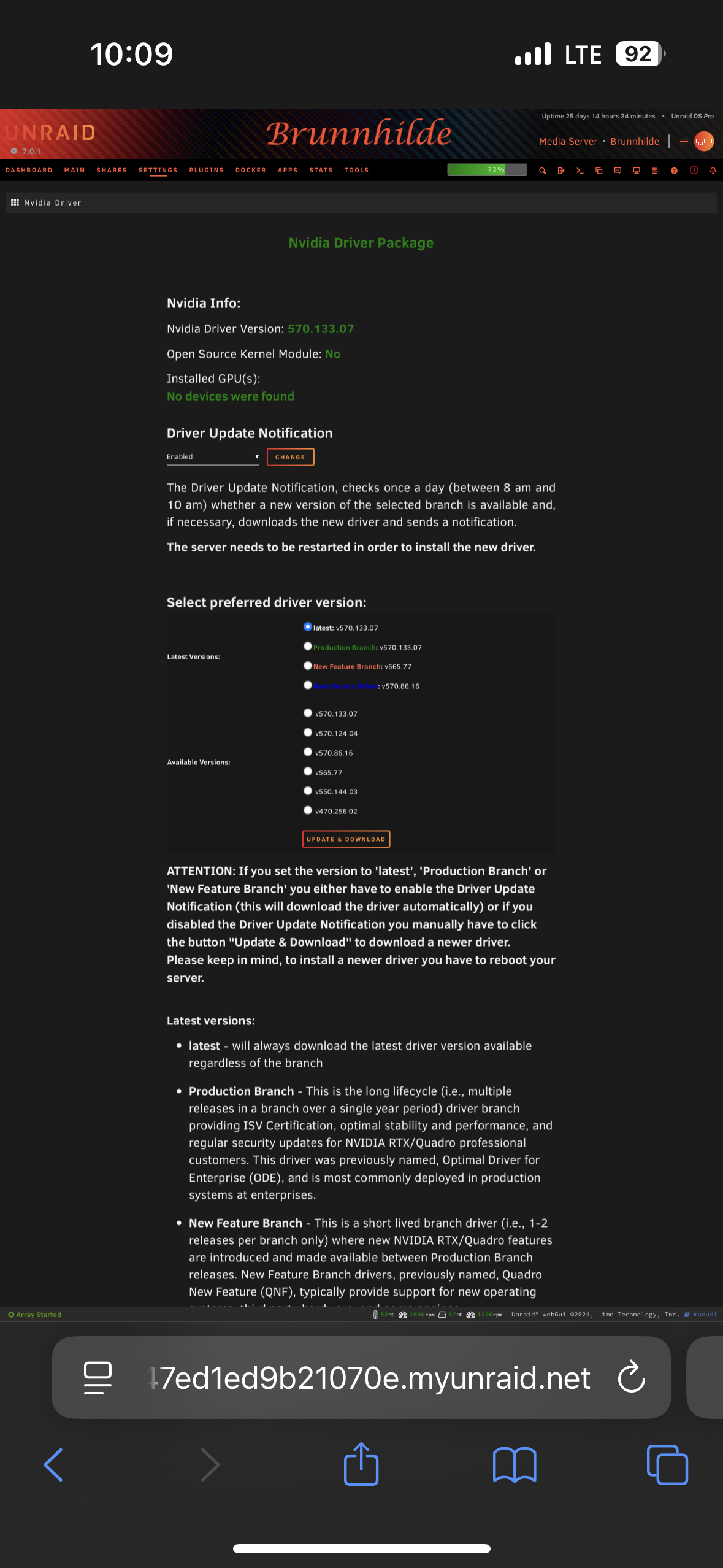

I’m getting error notifications from the nvidia plugin
unRAID Server: Notification
Link: https://Brunnhilde.dahoney.me/Settings/nvidia-driver
Event: Nvidia Driver
Subject: Notification
Description: Found new Nvidia Driver v570.133.07 but a download error occurred! Please try to download the driver manually!
Importance: alert
But when I go to the plugins tab and try to manually download I get a popup showing that the updated plugin has already been downloaded.
Please try to remove the plugin entirely (you containers will still work as expected) and then install the Nvidia Driver plugin from the CA App again and see if you get the same error?

7 hours ago, AnnabellaRenee87 said:
So, I had the issue where my GPU would come alive for a moment then go back to sleep. (Again)
May I ask first which container are you testing transcoding with?
The only time that I hear from such issues is in combination with Plex and trying transcoding in the WebPlayer.
It's a known issue that the Plex WebPlayer shows just a quick transcoding process on the GPU and then either showing a black screen or falling back to the CPU transcoder when switching the quality and trying to force a transcode.
For proper testing you should use a Native Plex Client like the Android or iOS App and forcing a transcode there or try it with Jellyfin.
The transcoder log should/could also give more information about that <- but it's not always that obvious what the problem is.

I was testing with Plex on my phone while on 5G/LTE.
I was also testing with Emby and JellyFin (Yes i have all 3 runing because I'm a nerd)

However the issue that you are experiencing is really weird since no one else reported such an issue and many more people have enabled nvidia-persistenced, do you already habe new hardware? Maybe it‘s related to the old hardware that you are running.
