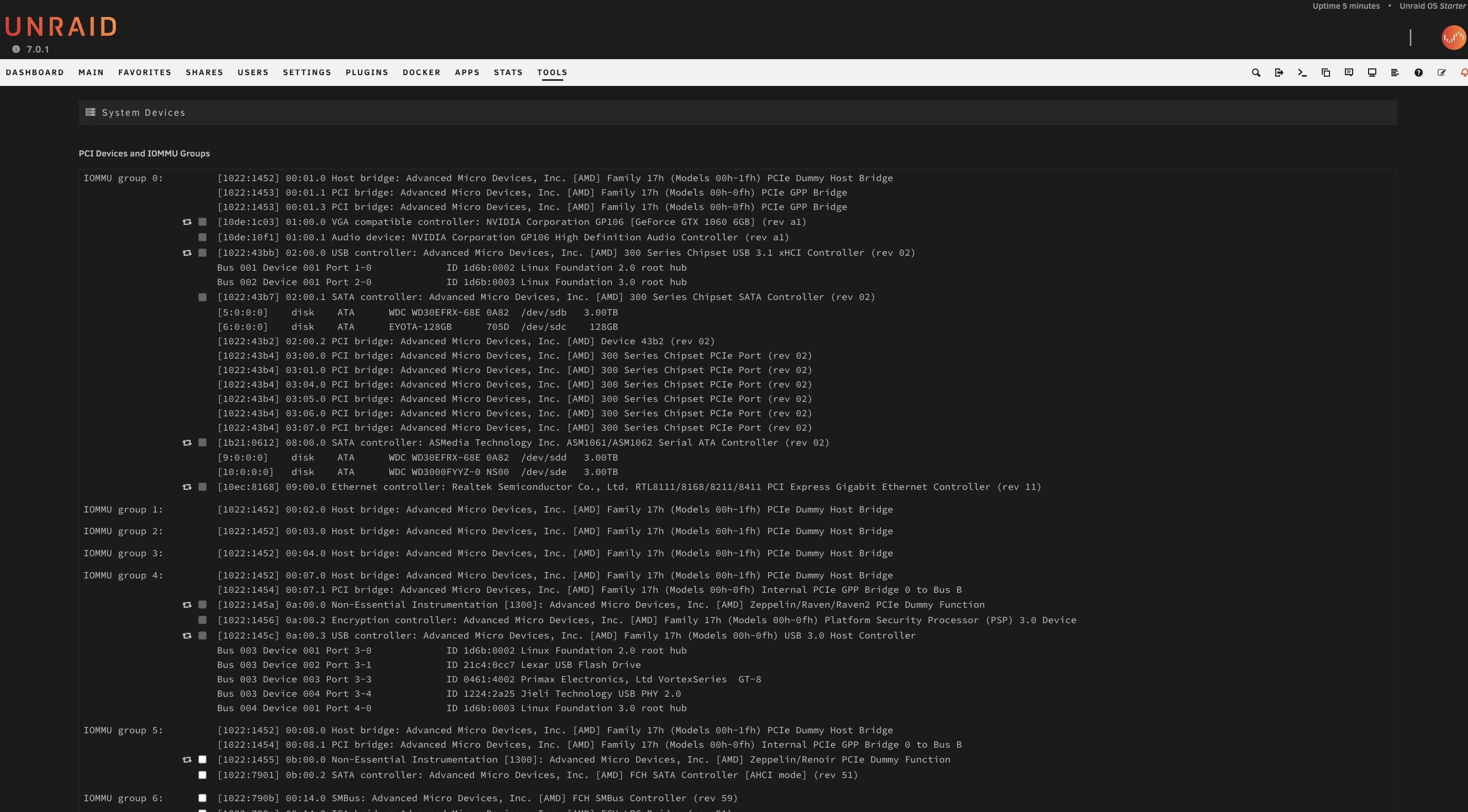

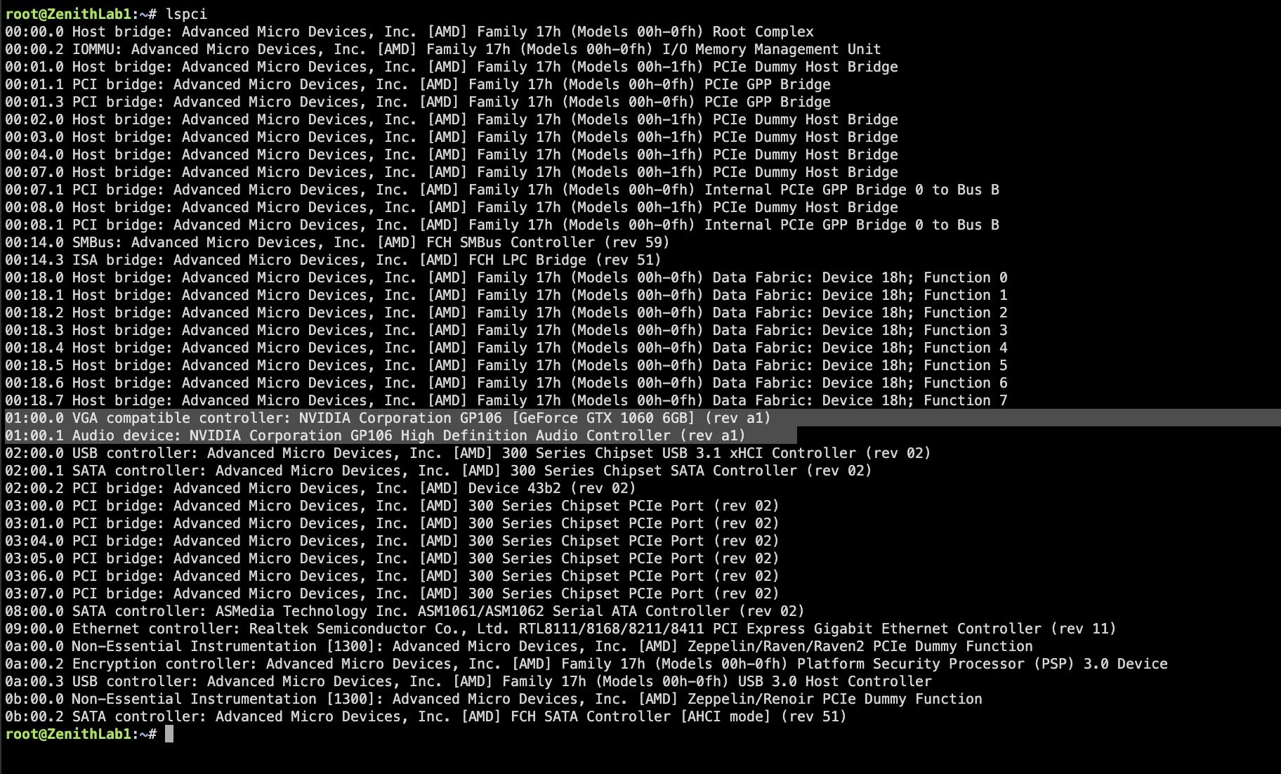

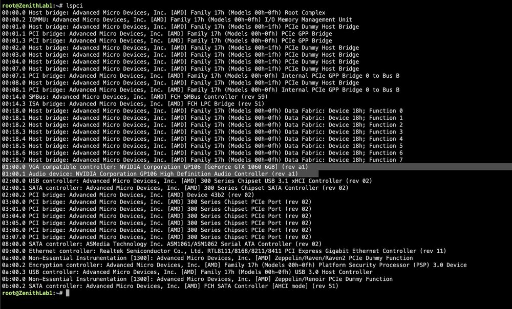

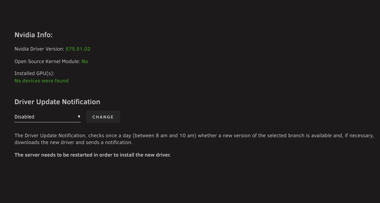

I have an issue with my GTX 1060
The devices have been detected on System Devices, and on lspci
However, the latest and production drivers didn't detect it. When I put the open source driver, I got the error "unraid NVIDIA-SMI has failed because it couldn't communicate with the NVIDIA driver. Make sure that the latest NVIDIA driver is installed and running."
Attached are the screenshots, and the diagnostics file,
Thank you
This is odd since it says that the driver is in use:
01:00.0 VGA compatible controller [0300]: NVIDIA Corporation GP106 [GeForce GTX 1060 6GB] [10de:1c03] (rev a1)
	Subsystem: ZOTAC International (MCO) Ltd. Device [19da:1438]
	Kernel driver in use: nvidia
	Kernel modules: nvidia_drm, nvidia

I see that the initialization fails:
May  5 18:09:58 ZenithLab1 kernel: NVRM: GPU 0000:01:00.0: RmInitAdapter failed! (0x24:0x72:1589)
May  5 18:09:58 ZenithLab1 kernel: NVRM: GPU 0000:01:00.0: rm_init_adapter failed, device minor number 0
May  5 18:09:59 ZenithLab1 kernel: NVRM: GPU 0000:01:00.0: RmInitAdapter failed! (0x24:0x72:1589)
May  5 18:09:59 ZenithLab1 kernel: NVRM: GPU 0000:01:00.0: rm_init_adapter failed, device minor number 0
Please also make sure that you are on the latest BIOS version and please check to enable Above 4G Decoding and Resizable BAR support in your BIOS.
I assume the card was working before in this Server or did you just install the card?
This is a new card i got it second hand from the marketplace, I was using P400 before, and it's working smoothly.
I have enabled the Above 4G Decoding and Resizeable BAR in my BIOS
I also plugin the GPU into a monitor via HDMI, and can see the computer booting and unraid console there.
Edited by zenaufa
May I ask why the switch to a GTX1060, Pascal will be Soon be "legacy" and not be supported by the latest driver version. Something like a Nvidia T400, T600 or even T1000 should be way enough for a few simultaneous transcodes.
I just saw that you have a Ryzen 1st gen CPU, I think you have to disable C-States or was it P-States IIRC so that all Nvidia cards work properly.
That doesn't mean that the card works properly, do you have another computer where you could test the 1060 and install the Nvidia driver?
The card want's to initialize but it refuses to initialize, this could be due to a Firmware (BIOS) issue or the card being defective.
