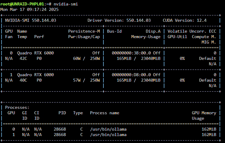

Good morning everyone, I'm somewhat newer to the on rate scene and I have installed two Nvidia RTX Quadros 6000. The issue I'm running into is I can install the new video plugins no problem but I believe they are installing the consumer versions of the driver when I need the data center server version of the drivers. Reason this is an issue is I am seeing Significantly poor performance off of the consumer drivers and during testing I uninstalled the Nvidia plugin and the Gpus ran amazing, is there any way to install those drivers I've done a ton of research and I've tried as many different things to know success any help is greatly appreciated.
What driver did you use specifically? Did you try the open source variant too?
The workstation driver is not part of this plugin, I have to look into if it would be even possible to create precompiled packages like it is the case for the existing plugin.
I have tried installing v570.124.04, v565.77, v565.57.01, v550.144.03, as well as the latest, production branch, and new feature branch. I have not however installed the Open Source Driver.
Driver I am trying to install is the following: "Data Center Driver for Linux x64 570.124.06 | Linux 64-bit"
I know what you are trying to do but you need a complete development environment since you have to compile the driver, then create a package and after that you have to install that on Unraid.
Please keep in mind that if you reboot the installation will be gone if you don't do it like that.
What Unraid version are you on? I should be able to compile a test package for you.

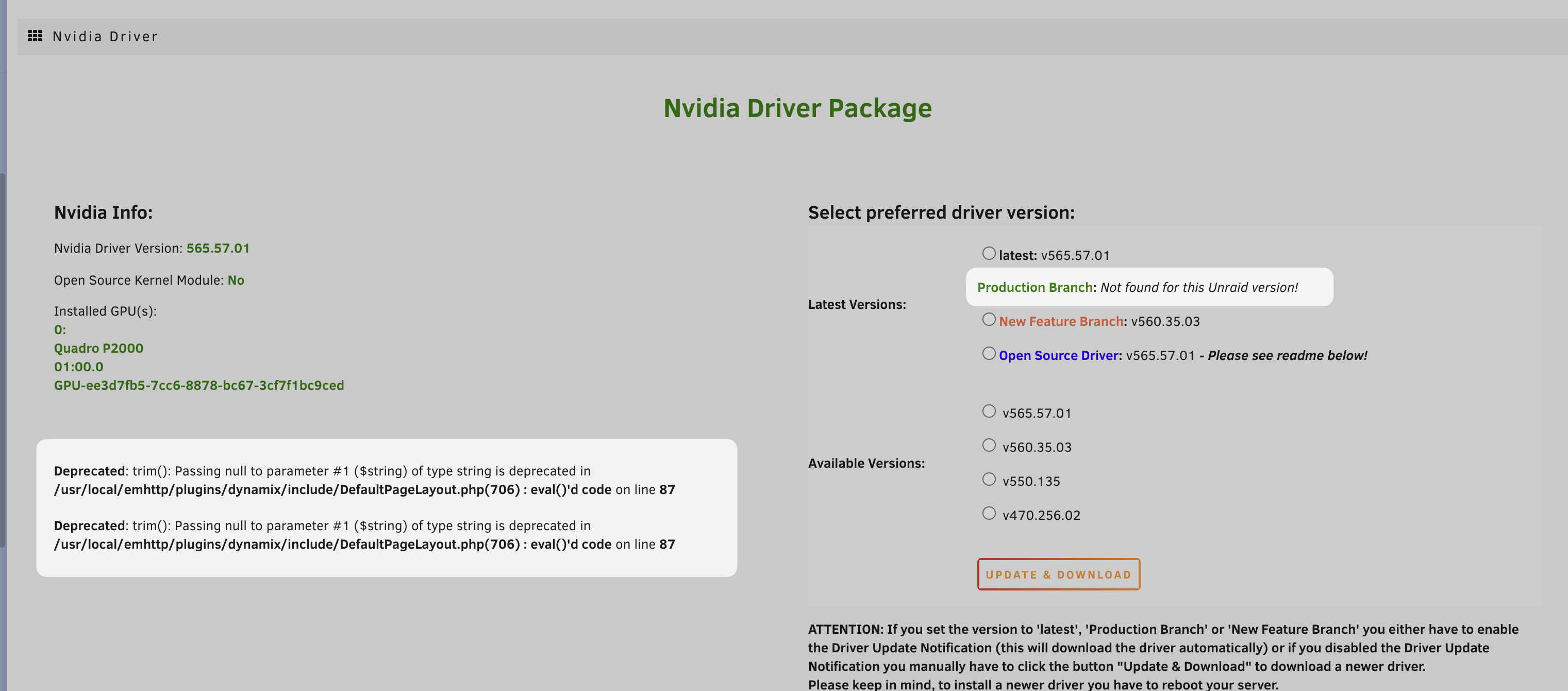

I have an Nvidia Quadro P2000 card I've been using for a few years with unraid 6.12.x.
I'm trying to update to 7.0.1 and got this warning after the install (but before rebooting):
On the Nvidia settings tool, i see this:
Edited by tmchow
Your plugin is broken (you'll see that on the two Deprecated lines, these should be not there and is a clear indication that something is not working correctly), please do the following:
  1. Uninstall the plugin
  2. Go to Settings -> Disk Settings -> set "Enable auto start" to "No" -> click Apply
  3. Reboot
  4. Install the Nvidia Driver plugin again (don't start the Array)
  5. Go to Settings -> Disk Settings -> set "Enable auto start" to "Yes" -> click Apply
  6. Reboot
After that everything should be back to normal.
