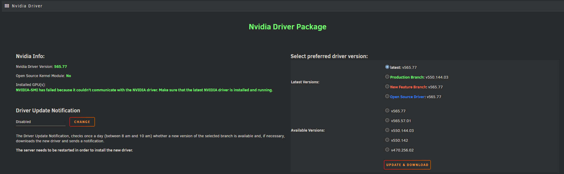

I hear you. But I only have the card in this machine because the CPU (AMD 1700) doesn't have an APU for my IPKVM. I was just trying to give it as a help to the CPU. But from the provided link, doesn't look like it will be doing much. Lol. Thank you for replying all the same!
On 1/11/2025 at 12:02 AM, ich777 said:
This graphics card is not capable of encoding/decoding most of the common formats nowadays because it is pretty old by todays standards.
You can take a look here what the card is actually capable of:
https://developer.nvidia.com/video-encode-and-decode-gpu-support-matrix-new
I would recommend that you look into something new or even used because you can get something like a Nvidia T400 for pretty cheap nowadays.
I

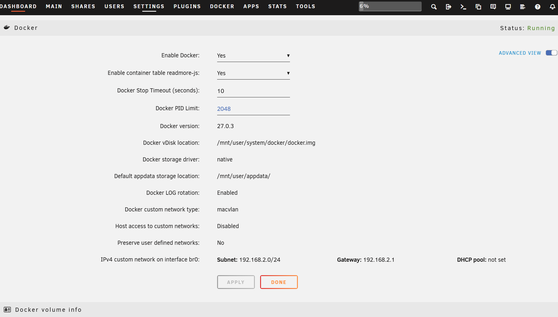

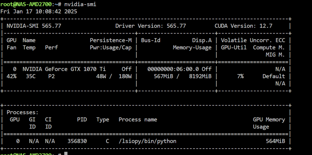

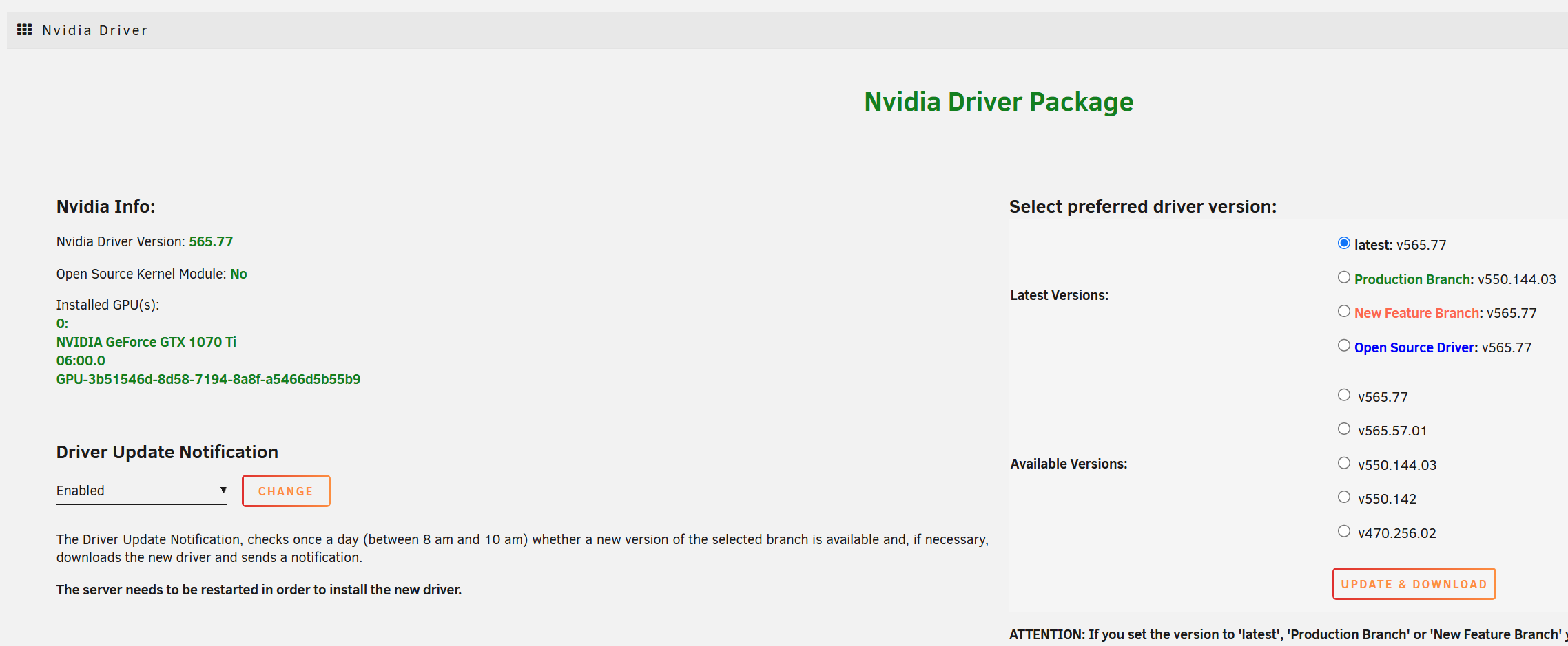

Hi Everyone,
I'm new to Unraid, so please excuse me for my lack of general Docker knownledge! I am trying to get my GPU working for some functionnality in Immich and eventually in Jellyfin. However, after a lot for tickering, I think the drivers does not get install properly because I dont see the option in Setting>Docker (Advanced View) for NVDIA Driver = Enable. Also, NVDA-SMI doesnt work in console mode. BUT, my GPU is showing Tab for NVDIA Driver Package. Can also confirm that GPU Stats does show me GPU information.
I have installed Unraid 7.0.0 from 2025-01-09.
I have an NVDIA GTX 1070 TI installed
Last things I tried is Uninstalling the NVDIA Driver, reboot, Reinstall, Reboot, Docker Enable = No, Docker Enable = Yes , but the NVDIA Driver = Enable option isn't showing..
I made sure the card is sitting properly in its slot, that 4g decoding and rebar are enable in the Bios.
I am attaching Diag file hoping someone can point me to the right direction.
Thank you!
image.png.a9be90399666b3634d48b342e79dabb4.pngimage.png.36b4b32fb08aee693f8f54447c95b9f6.png
nas-amd2700-diagnostics-20250117-0823.zip
Did you read the second post in this thread what you have to add to a container to utilize the Nvidia card in the container?
Did you also follow the first post and the steps how to install the driver.

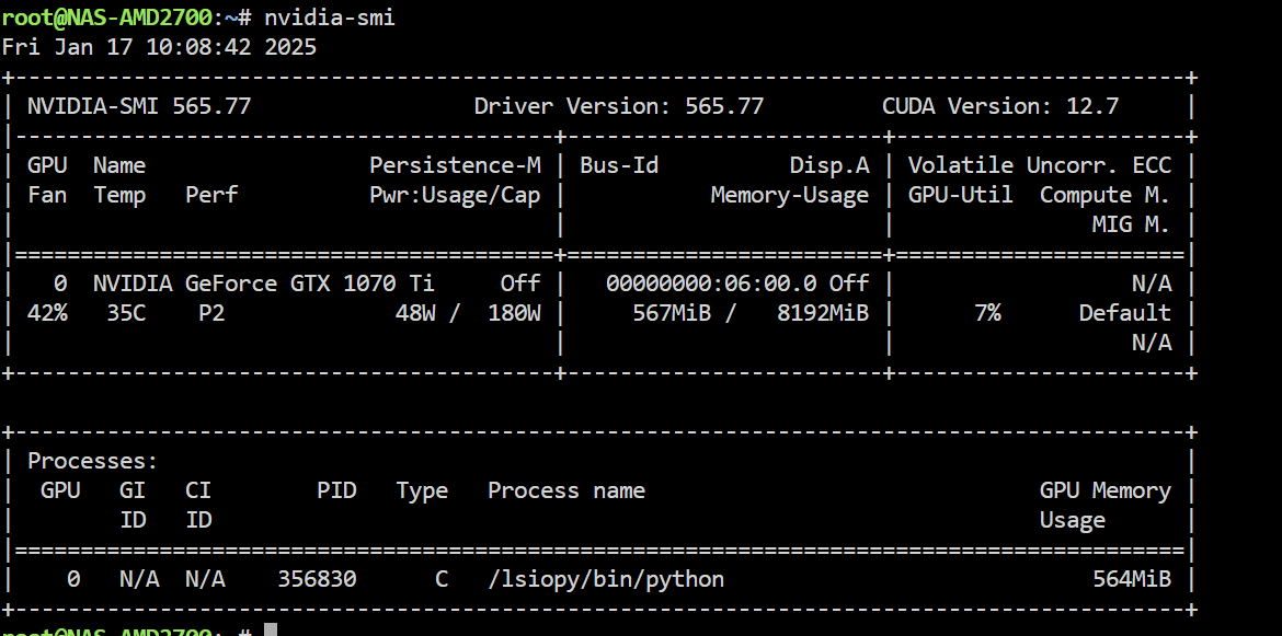

The command from the terminal is:
nvidia-smi
You have a typo in your screenshot.
First of all, I am total noob with this stupid typo .. ! I'm very sorry! I didnt want to waste your time! NVIDIA-SMI works. Looks like I had the same typo in the --runtime-NVIDIA which was killing my Immich docker. Well, all good now and working. Thanks so much!! image.thumb.png.aaeabe39cb1c0956d071a70c8e2d4f2c.png
Edited by Desret
Typo correction

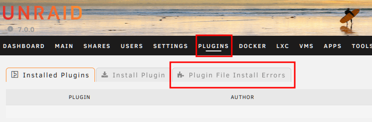

19 minutes ago, SamH said:
The plugin does not show as installed anywhere so I can't remove it.
Are you also sure that you don't have this tab:
However I would recommend that you upgrade to Unraid 7.0.0 when the reason you downgraded was just the Nividia Driver not working.
When upgrading did you see the message to wait until you are notified it is safe to upgrade, this should look something like this here.
If you get that message this usually means that your Unraid Server is not able to communicate with GitHub, this is where all the driver packages and version files are located.
Did you by any chance change your network gear recently or did you install any AdBlocking software recently?
Most of the times Unifi Routers with enabled IDS/IPS or AdBlocking software on the local network can cause issues.
Please do the following:
  1. Turn of any AdBlocking/IDS/IPS in your Firewall for the time doing these steps here
  2. Run the upgrade assistant to upgrade to Unraid 7.0.0
  3. Reboot
  4. Download the driver plugin again
From your Diagnostics I see that the Nvidia Driver plugin tried to upgrade to the appropriate package for Unraid 7.0.0 but it failed like when you did it manually:
Jan 21 13:21:55 SamsNas01 rc.local: +==============================================================================
Jan 21 13:21:55 SamsNas01 rc.local: | Installing new package /boot/config/plugins/nvidia-driver/nvidia-driver-2024.12.08.txz
Jan 21 13:21:55 SamsNas01 rc.local: Verifying package nvidia-driver-2024.12.08.txz.
Jan 21 13:21:55 SamsNas01 rc.local: Installing package nvidia-driver-2024.12.08.txz:
Jan 21 13:21:55 SamsNas01 rc.local: PACKAGE DESCRIPTION:
Jan 21 13:21:55 SamsNas01 rc.local: Package nvidia-driver-2024.12.08.txz installed.
Jan 21 13:21:56 SamsNas01 rc.local: -----ERROR - ERROR - ERROR - ERROR - ERROR - ERROR - ERROR - ERROR - ERROR------
Jan 21 13:21:56 SamsNas01 rc.local: ---Can't get latest Nvidia driver version and found no installed local driver---
This is probably caused because of something blocking access to GitHub.
Please try the things that I pointed out above and see if it is working afterward.
