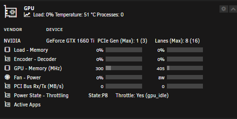

Hi Everyone,
I'm new to Unraid, so please excuse me for my lack of general Docker knownledge! I am trying to get my GPU working for some functionnality in Immich and eventually in Jellyfin. However, after a lot for tickering, I think the drivers does not get install properly because I dont see the option in Setting>Docker (Advanced View) for NVDIA Driver = Enable. Also, NVDA-SMI doesnt work in console mode. BUT, my GPU is showing Tab for NVDIA Driver Package. Can also confirm that GPU Stats does show me GPU information.
I have installed Unraid 7.0.0 from 2025-01-09.
I have an NVDIA GTX 1070 TI installed
Last things I tried is Uninstalling the NVDIA Driver, reboot, Reinstall, Reboot, Docker Enable = No, Docker Enable = Yes , but the NVDIA Driver = Enable option isn't showing..
I made sure the card is sitting properly in its slot, that 4g decoding and rebar are enable in the Bios.
I am attaching Diag file hoping someone can point me to the right direction.
Thank you!
image.png.a9be90399666b3634d48b342e79dabb4.pngimage.png.36b4b32fb08aee693f8f54447c95b9f6.png
nas-amd2700-diagnostics-20250117-0823.zip
Did you read the second post in this thread what you have to add to a container to utilize the Nvidia card in the container?
Did you also follow the first post and the steps how to install the driver.
The command from the terminal is:
nvidia-smi
You have a typo in your screenshot.
First of all, I am total noob with this stupid typo .. ! I'm very sorry! I didnt want to waste your time! NVIDIA-SMI works. Looks like I had the same typo in the --runtime-NVIDIA which was killing my Immich docker. Well, all good now and working. Thanks so much!! image.thumb.png.aaeabe39cb1c0956d071a70c8e2d4f2c.png
Edited by Desret
Typo correction
