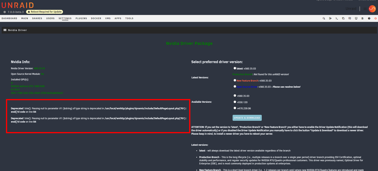

Hi there.
I am using latest Unraid 7.0.0-rc.1 and have an ASUS PRIME Z790M-PLUS motherboard with a nvidia RTX 4060Ti 16Gb installed.
If i install the latest nvidia driver through this plugin i get the following dmesg error output:grafik.thumb.png.f30ef8218a876db7b59d321b35e13cf4.png
Since ASUS does not offer any support for Linux Distros, i was wondering if this is a driver problem and can be fixed through an upcoming update.
I also have the problem, that in the moment i plug in any nvidia GPU into my motherboard (regardless of i installed the nvidia driver plugin or not), my system is not able to reach higher c-states than C3 anymore. If i remove the nvidia card i reach C10 again.
Does someone else experience this and is there any workaround?
Thanks in advance and kind regards
Please post your Diagnostics, there is too less information in your post.
This is a firmware bug, so to speak caused by your BIOS, nothing that I can do about.
Watch out for new BIOS updates and update as soon as one is available.
