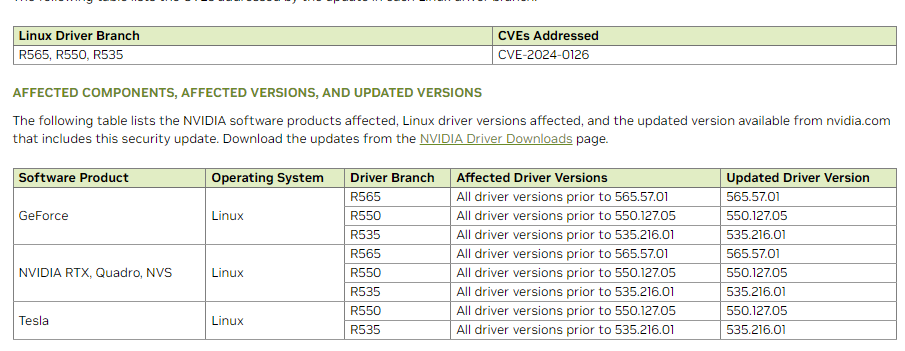

There was a recent security bulleting pushed out about driver vulnerabilities... I'm unsure what "driver branch" is in use with this plugin and how would you manually update?

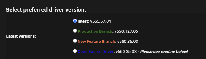

This is what I see available to me on 7 beta 2
4060 Ti is the card
Thanks!
Edited by melmurp
added card

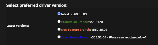

It might be a good idea to consider upgrading to the latest beta.4 version, as it includes the latest driver versions, which could enhance your system's security.
I certainly don't mean to be overly critical. It's just important to ensure that when discussing CVEs, you're operating on the most current version of the OS to maintain optimal security.
Hope that helps. ;)
