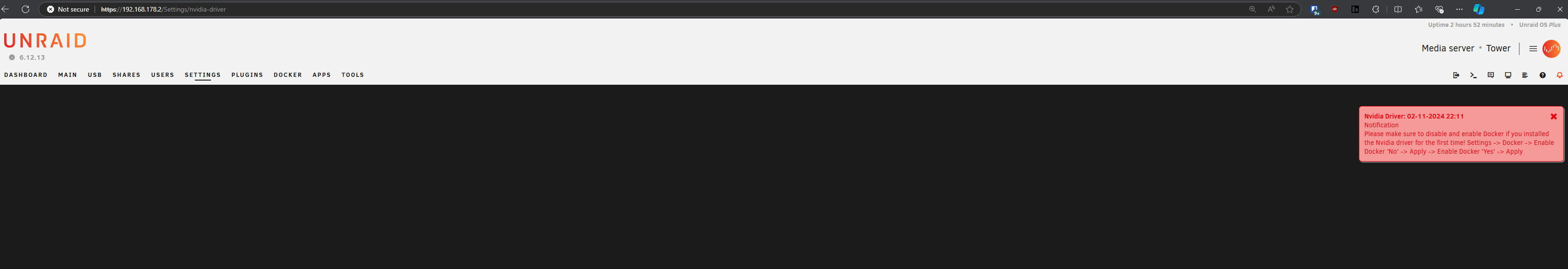

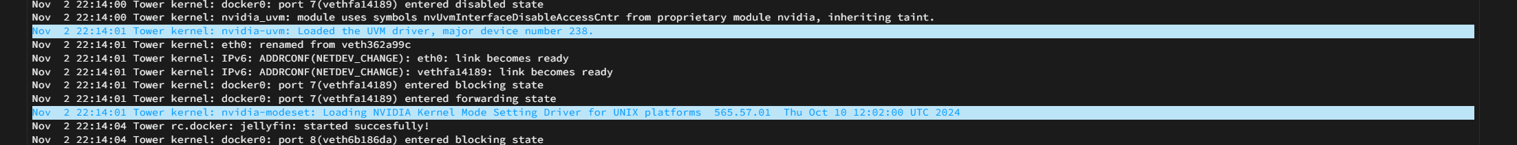

  2. Installation now worked, waited like a good boy: Somehow not able to access the plugin. Any logs I can set or should I just remove everything and go from 6.12.13 to v7 beta.4 again and before that remove the plugin? Otherwise could also go for a reboot first and see if that fixes it. But would is the most weird is this "[error] 27548#27548: *71149 open() "/usr/local/emhttp/game" failed" don't know where this is coming from but you'll most probably not able to help with that Edit: It seems like Jellyfin is able to access the device again and playback is working also just like before. Hesitant now to change anything again as it is working 😅
  3. Did not downgrade immediately. Tried troubleshoot for half of the day but was in the end not successful and thought that might do it. Was previously installed correctly and waited with the new install also . Will post diagnostics after installation. In case if its not in plugin tab can I check on file system whether I have a corrupt installation?

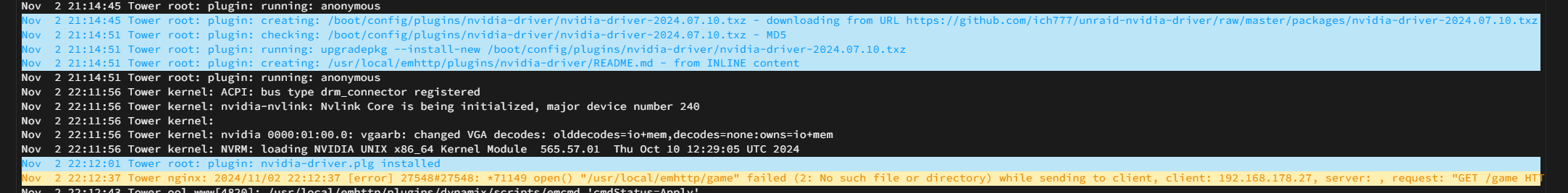

  4. I somehow completely fucked my environment. Upgraded to v7 update 4 and the network bricked and graphics card not usable anymore. Fixed network (?) and tried to reinstall nvidia driver plugin. That did not work. Now I downgraded and try to install nvidia plugin again. Not working, I get error: "plugin: run failed: 'bon/bash' returned 1" but I have enough space on my flash. Could be still network issue?

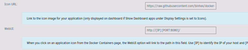

  5. Thanks @MisterLas - downgrade worked. Also the suggestion of Binhex did the trick for 4.6! You can also give it a try. @binhex Thanks for the hint! Process started again and the initial credentials were working.
  6. That is correct! Both are set to 8080, as you can see from the docker screen, here also the container config: From my logs when it worked, I got the message that the process has started listening on port 8080: 2023-05-21 04:41:48,976 DEBG 'watchdog-script' stdout output: [info] qBittorrent process started [info] Waiting for qBittorrent process to start listening on port 8080... 2023-05-21 04:41:49,198 DEBG 'watchdog-script' stdout output: [info] qBittorrent process listening on port 8080 2023-05-21 04:41:49,201 DEBG 'watchdog-script' stdout output: [info] Attempting to start Privoxy... 2023-05-21 04:41:50,209 DEBG 'watchdog-script' stdout output: [info] Privoxy process started [info] Waiting for Privoxy process to start listening on port 8118... 2023-05-21 04:41:50,214 DEBG 'watchdog-script' stdout output: [info] Privoxy process listening on port 8118 But this does not happen now, he is somehow stuck at: [info] Waiting for qBittorrent process to start listening on port 8080... Do you know of any additional possibilities/options to check, why the process does not start listening besides enabling debug function?
  7. That is correct Sir. Machine is reachable via 192.168.178.2 and according to my understanding 192.168.178.2:8080 should be Bittorrent. Container is configured using bridge network:
