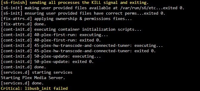

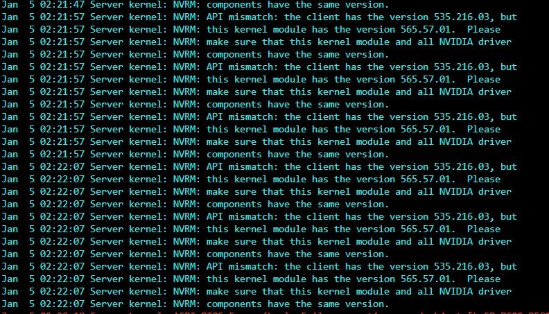

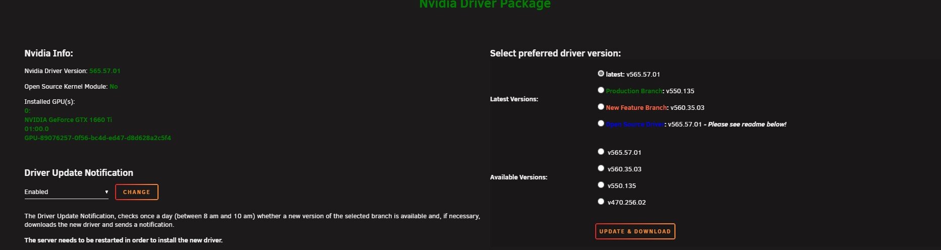

I just upgraded to Unraid 6.12.14 and then upgraded the nvidia driver from 535.216.03 to 565.57.01 and now my dockers will not use my GPU. I have since tried several other versions of the drivers available, rebooting server after each installation and dockers still do not see the GPU. The dockers worked fine utilizing the GPU before. The original driver I was using does not show as an option in the list of available drivers in the nvidia addon. Motherboard is ASUS Proart Z790 Creator WIFI, GPU is GTX 1660 TI, and Intel 19-13900K. Using ter GPU with Plex docker as well as Code Project AI Docker. First image is a error on startup after first trying to upgrade driver, 3rd image is a error on plex docker startup.
server-diagnostics-20250106-2136.zip

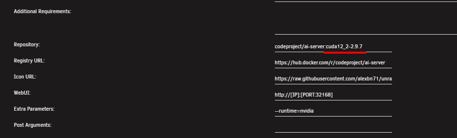

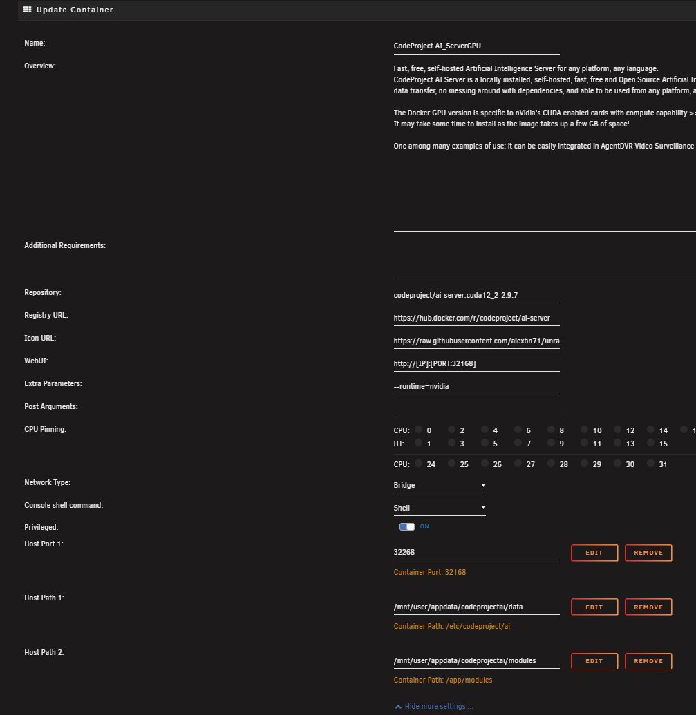

I assume you are talking about this container:

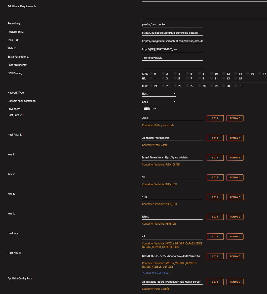

Can you please share a bit more detail on how do you run the container?
Which repository, do you also use a tag for the container?
Maybe share a screenshot from the Docker template with Advanced View enabled.
with Plex docker
What is not working exactly?
The log shows not really an error that is related to the Nvidia GPU.
What container are you using (repository)?
Do you force a transcode in the webplayer from Plex or how did you do to test that it's not working any more?
From what I see in your Diagnostics the driver is installed and working fine.
This exact driver page which you are using has about 15k downloads on it and I assume that everything is working for most people.
Not sure what you mean, I use it as AI for Blue Iris security Cameras.
Added below

18 minutes ago, Itsaulgoodman said:
I assume most certainly the tag is wrong.
Please try to remove the tag from the Repository and see if that fixes the issue.
19 minutes ago, Itsaulgoodman said:
Not sure what you mean by remove tag?
This here is the "tag":
I can't imagine that the maintainer is relaying on such an old version from the driver and is not supporting newer versions from the driver.
I see, I had to add that tag in order to get a newer version to download. I cant remember what it said there before, but I found a list, and that version was the most recent one that used GPU with CUDA.
but I found a list
Can you maybe share that list so that I can also take a look at that?
However even the documentation says that you should install the latest Nvidia driver, which you have installed:
https://www.codeproject.com/ai/docs/install/install_on_linux.html#nvidia-gpu-support
However you could join their Discord and see if they can help you there:
https://discord.com/invite/adxDt9YTX2
I'm not sure if you really need that old of a driver for the container to run.

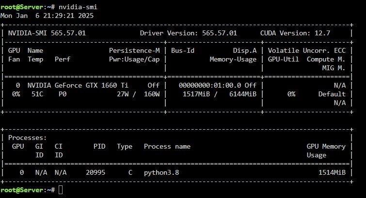

BTW, I see that some python process is running on your GPU which is most likely this container:
