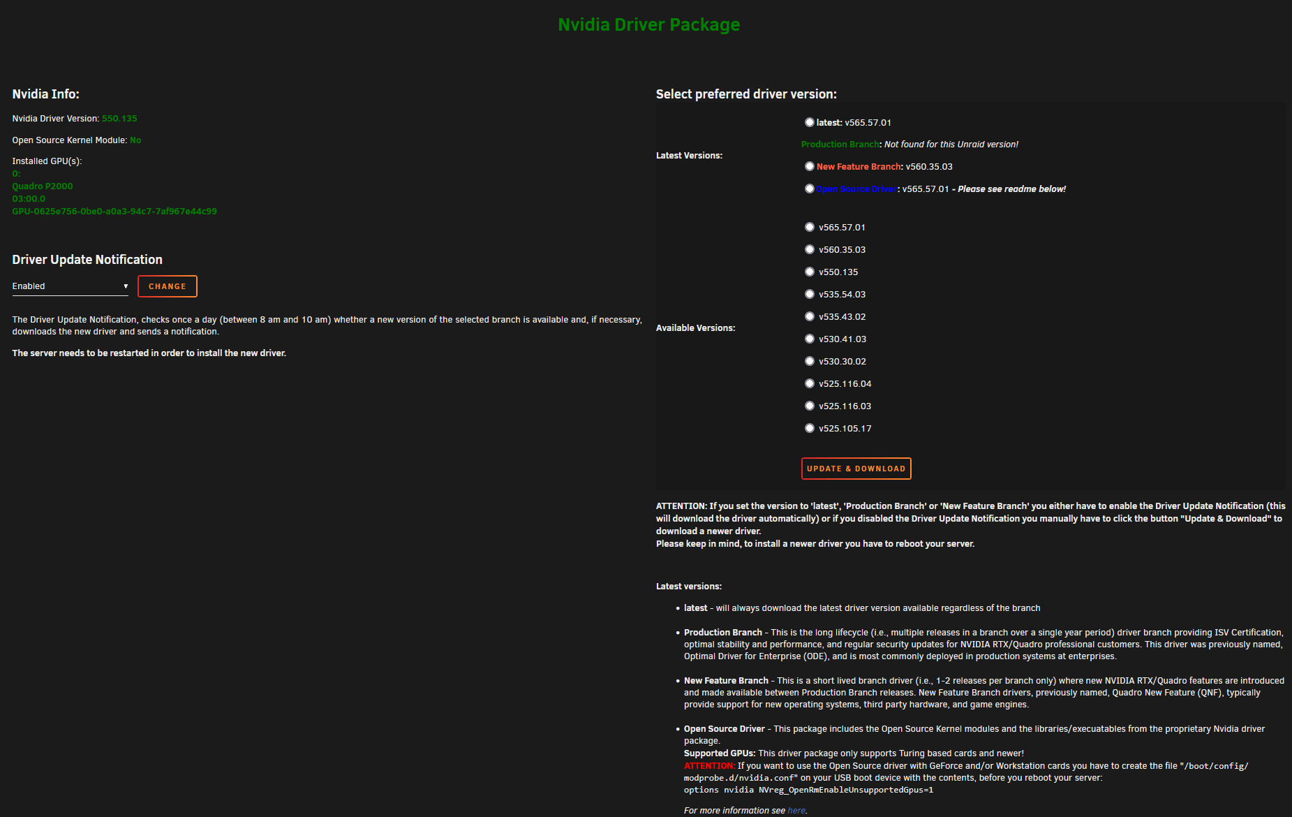

Could someone help me with a problem?
When I try to access http://[IP]/Settings/nvidia-driver the unraid WebUI freezes for a few minutes, and I can't access the nvidia configuration page, because it keeps loading infinitely.
Accessing other pages also becomes impossible after trying to access the settings, because it keeps loading for a certain amount of time, and only after a few minutes the WebUI unfreezes if I have the Nvidia configuration page closed.
I don't know what it could be, I've already removed the driver completely, restarted the server, then reinstalled the driver via Community Apps and the issue remains.
I can use the GPU normally in my Dockers, but configuring it, choosing a driver, or anything like that requires the driver configuration page.
I have two GPUs on the server, a P2000 for transcoding and a simple GT to just be able to plug in a maintenance screen.
nashome-diagnostics-20250212-1319.zip
Sorry for the late response...
You have multiple of these messages in your syslog:
Feb 12 02:05:00 NASHOME mcelog: Corrected memory errors on page 282c43000 exceed threshold 6 in 24h: 6 in 24h
Feb 12 02:05:00 NASHOME mcelog: Location SOCKET:0 CHANNEL:5 DIMM:? []
Feb 12 02:05:00 NASHOME mcelog: Fallback Socket memory error count 4 exceeded threshold: 225 in 24h
Feb 12 02:05:00 NASHOME mcelog: Location SOCKET:0 CHANNEL:? DIMM:? []
Feb 12 02:05:00 NASHOME mcelog: Running trigger `socket-memory-error-trigger' (reporter: sockdb_fallback)
Feb 12 02:05:00 NASHOME kernel: mce: [Hardware Error]: Machine check events logge
Are you sure that your RAM is okay? @JorgeB have you seen such messages before?
I assume they have to do with your issue with the driver.

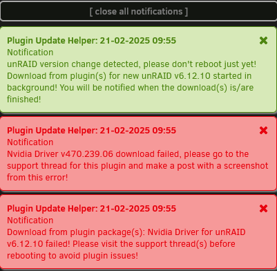

I'm on unRaid 6.11.5, updating to 6.12.10, and I got the following toast notifications:
I have not received the toast notification that it's safe to reboot yet.
I'm already on a higher driver version than 470.239.06, and I don't seem to have a corrupt plugin like some others in this thread have had. Here's a screenshot from my plugin settings page:
Any help would be appreciated.
Uninstall the plugin, deactivate autostart from the array, install the plugin, enable autostrt from the array in the disk settings again and reboot again.
I would strongly recommend that you upgrade directly to 7.0.0
Please post your Diagnostics if you experiencing further issues.
my journey with this same issue.
  Ive been banging my head on my desk for a month trying to figure this out. Even tried to just use a laptop with plex and unraid on it as a stop gap. I see the same issues on the laptop... (has a 1080) Ive tried to blow away my build and start over (kept array) and still no luck. Ive been using unraid for about 8 years and i have neve had these issues and it has worked properly for years until now.
Edited by radly82
Do I reboot in between deactivating autostart and then re-installing the plugin?
I already started the upgrade process to 6.12.10. Am I able to override this with an upgrade to 7 if I just run it again? Or am I stuck on the upgrade path to 6.12.10?
EDIT: Did the above process with a reboot after uninstalling the plugin and deactivating the autostart. Seems to be working as expected now. I'll keep an eye on it when I move up to the 7.0.0 to see if I have similar issues.
Edited by Eyeheartpie
Just do it in the order that I said above.
I‘m not sure but you can upgrade to 6.12.10 and then to 7.0.0
The upgrade process should just work fine from 6.12.10 to 7.0.0 as long as you wait for the notification that it is safe to reboot from the plugin update helper.
Hope that helps.
