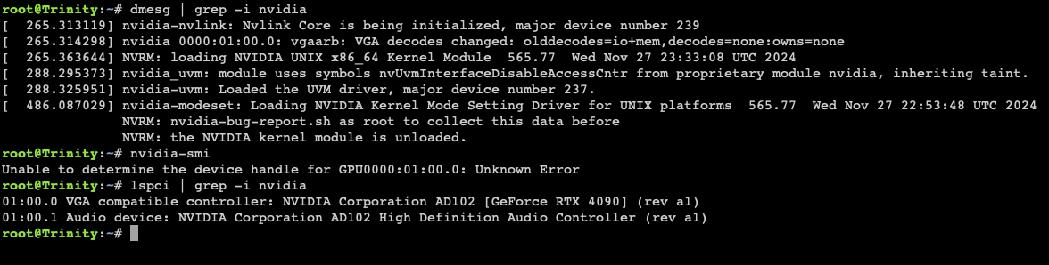

hello, i've had this issue a few times; why does the nvidia driver after a while it cant find my gpu anymore? it works for a bit sometimes 1 day sometimes 2 days then i have this issue; ill attach the unraid logs if they can help to solve this

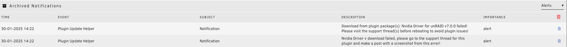

Hey there,
i have this error while updating to 7.0.0
diagnostics-20250206-1135.zip
The update itself is stuck here:
Any ideas what to do?
Thanks in advance!
Edited by orhaN_utanG
Please open up a Unraid Terminal and issue this command:
wget -qO- https://raw.githubusercontent.com/ich777/unraid-plugin_update_helper/master/force_package_update | bash
This should download the driver for Unraid 7.0.0 otherwise you can also just reboot since the driver plugin will also try to download the driver on boot but do keep in mind boot will take a bit longer than usual because the driver is about 230MB in size.
