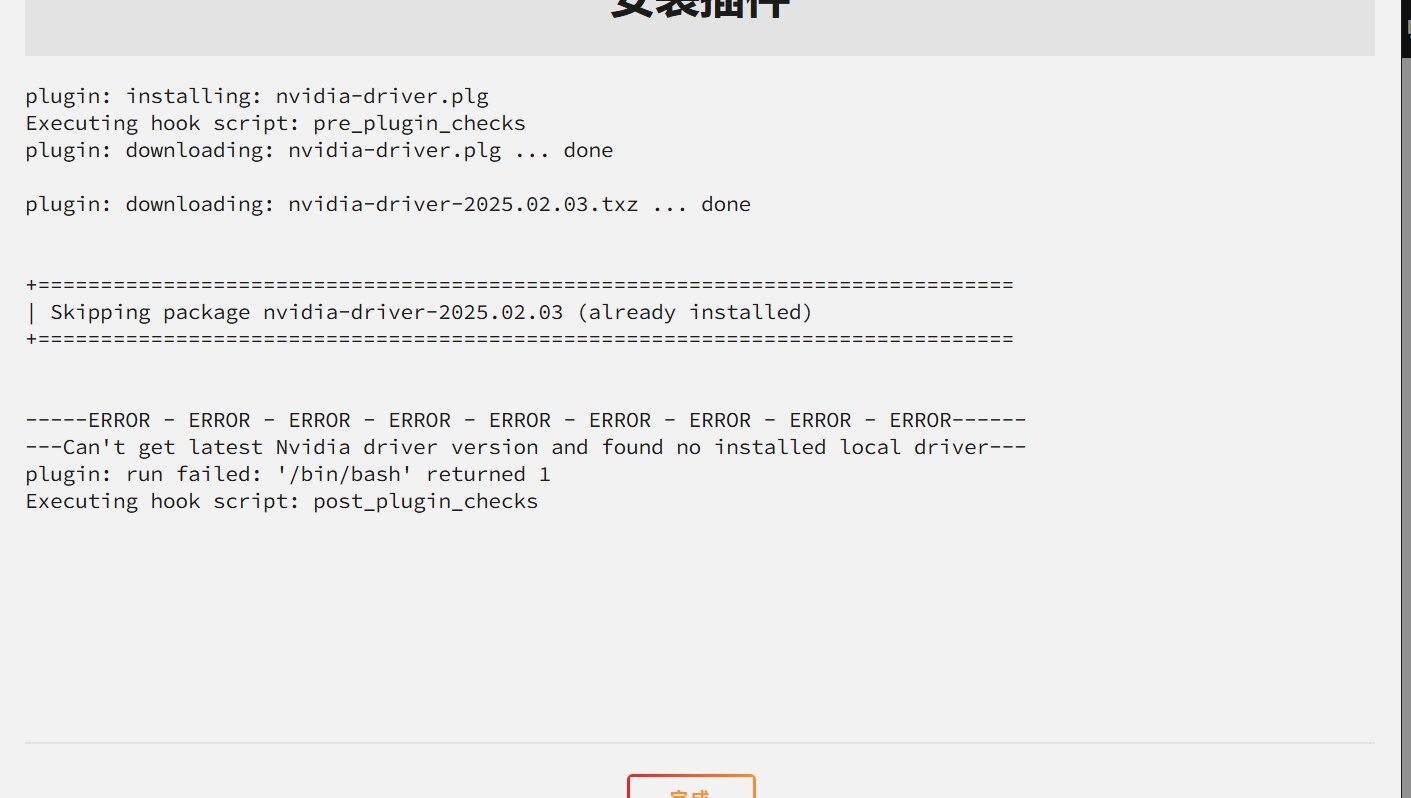

大佬,出现这个问题时啥原因,装不上插件。
In this part of the forums only English please.
Do you have a proxy installed? I think it is necessary to communicate with GitHub in your region of the world.
The driver plugin uses GitHub API calls to get the latest driver version, maybe there are no free API calls are left on your Proxy, you can check how many GitHub API calls you have left by opening a Terminal and issue this command:
curl -L https://api.github.com/rate_limit | jq -r '.rate'
you should see a response like this:

Here is what I am getting when I try to update the plugin:
plugin: updating: nvidia-driver.plg Executing hook script: pre_plugin_checks plugin: run failed: 'upgradepkg --install-new' returned 127 Executing hook script: post_plugin_checks

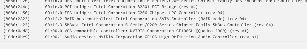

For some reason it does not see my Quadro 2000. I get:
NVIDIA-SMI has failed because it couldn't communicate with the NVIDIA driver. Make sure that the latest NVIDIA driver is installed and running.
The trouble shooting info at the beginning of this thread says;
If you bound accidentally all cards to VFIO unbind the card you want to use for the Docker container(s) and reboot the server (TOOLS -> System devices -> unselect the card -> BIND SELECTED TO VFIO AT BOOT -> restart your server).
Do I need the Legacy driver (470xx)? If so, how do you install those .run files?

I need to download and install Linux x64 (AMD64/EM64T) Display Driver 390.116 | Linux 64-bit to use with my NVIDIA NVS 4200M.  I realize it is older but I would be using it to transcode MPEG-1, MPEG-2, VC-1, and H.264 which it is capable of doing.  The NVIDIA Driver plugin's oldest version is v470.256.2.  I am getting this error: NVIDIA-SMI has failed because it couldn't communicate with the NVIDIA driver. Make sure that the latest NVIDIA driver is installed and running.
Could someone please assist me.
