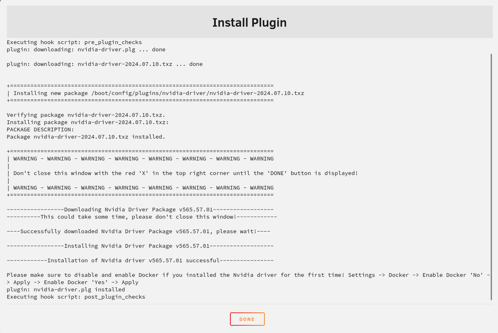

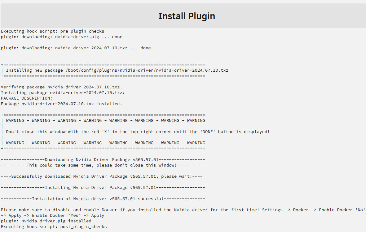

8 hours ago, dwgtx said:
I upgraded Unraid to 6.12.13 from 6.12.10 but missed the note on ensuring that this driver was updated to the latest version.
Did you notice the message that you should wait for third party drivers to update and to tell you that it is safe to reboot?
After the reboot, the driver disappeared.
My comment above is maybe why it disappeared.

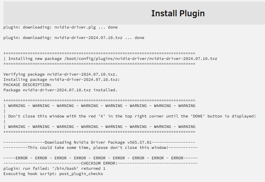

I tried an install from CA but kept getting this message.
I just tried it and it is working over here:
May I ask what Network gear that you have and if you do some AdBlocking on your Network?
The Plugin is using the GitHub API and some people reported here that Unifi network gear at times blocks access to the API or to GitHub, I'm not 100% sure since I don't own any Unifi gear, I assume it has something to do with IDS.
However it seems that you are running into a Checksum error which is very weird, are you sure that your USB Boot Device is okay? But I still assume that this is some kind of network error.

I appreciate the replies from the community. Here are answers to questions thus far:
  • while the message during install indicates that the "Package nvidia-driver-2024.07.10.txz installed", I see no evidence that it actually did (I'm assuming the initial install was deleted when I tried to reinstall after the 6.12.13 update). The plugin does not appear under Installed Apps/Plugins in CA; there is no nvidia-driver folder on my flash config folder nor in the plugins-error or plugins-removed folders and nothing in the /boot/config/plugins/ folder. So it's unclear how I would go about uninstalling a plugin I can't find
  • Regarding reboot after upgrading to 6.12.13, unfortunately, I did not notice the message to wait for third-party drivers to update before reboot. My bad, and now I'm paying for it
  • I'm using Sodola 2.5G network switches with an Eero Pro 6 gateway that handles DHCP and connects to my cable modem. My Unraid server has a fixed IP. There is no AdBlocking at the network level (browser only) and no AB plugins on the Unraid server
  • I'm in the process of replacing my USB Boot device to see if that is the culprit
  • Note: the current network equipment and Flash Boot device were utilized during the successful initial driver install. However, upgrading the USB device was already on a maintenance checklist. I'll provide an update when that's complete
Well, well, well... This was a sight for sore eyes. Or, as we say in Texas: "I'm happier than a jackrabbit at a speed dating social."
It was, in fact, the USB drive. To assist others who may encounter this issue, here are the before and after USB specs:
  • Was Using: Sandisk 32G Ultra 3.1 (in use for 2+ years and apparently wore out)
  • Replaced with: SAMSUNG BAR Plus 32G 3.1 (Spaceinvader One recommendation)
As Joan Baez aptly put it: "You don't know what you have till it's gone." I had no idea just how vital this driver was to my daily existence until I rushed through a server update without reading the (crucial-and-will-never-skip-again) installation notes. I'm grateful to the community for your time and expertise and incredibly thankful for ich777's work and commitment to his community engagement. I'm headed to his donation link and encourage everyone to do the same.
https://paypal.me/chips777
Maybe a recommendation from my side: Transcend 32GB USB 2.0
This is a really good device and served my server for years without any issue, as a bonus you should be still be able to get a USB 2.0 version which runs way cooler than a 3.0+ USB device, sure the boot times take a bit longer (about 10 to 20 seconds) but that is negligible.
Just a recommendation, if you are satisfied with your new USB Boot device no need to change. :)
Anyway glad that everything is solved now and you are up and running again.

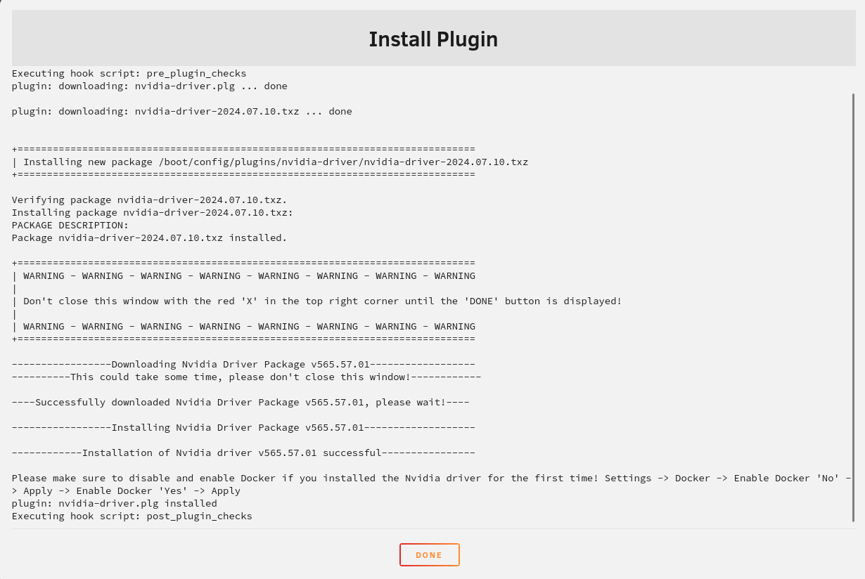

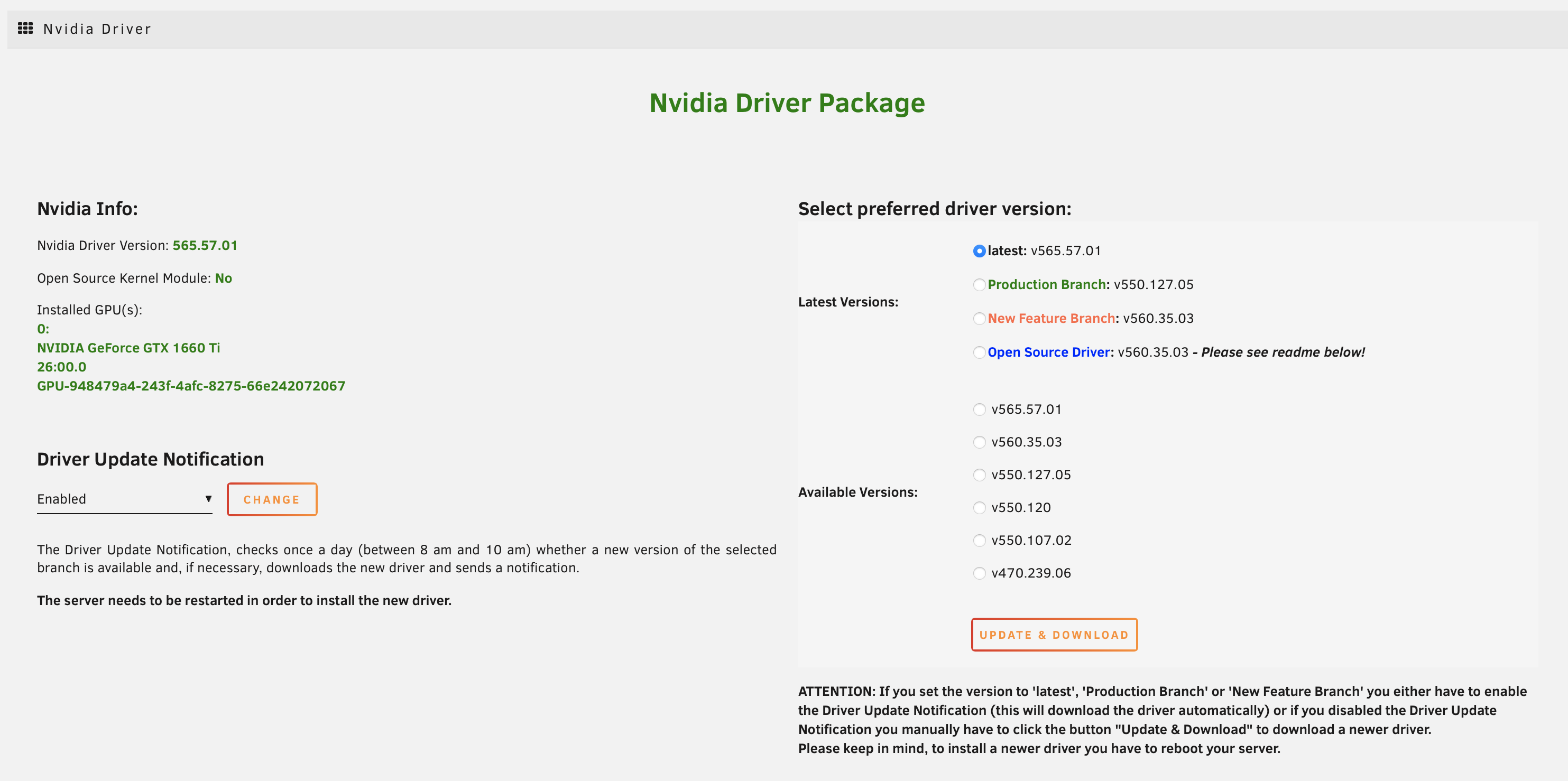

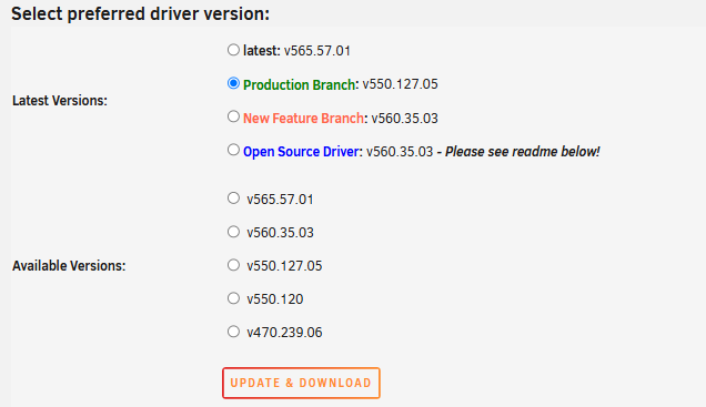

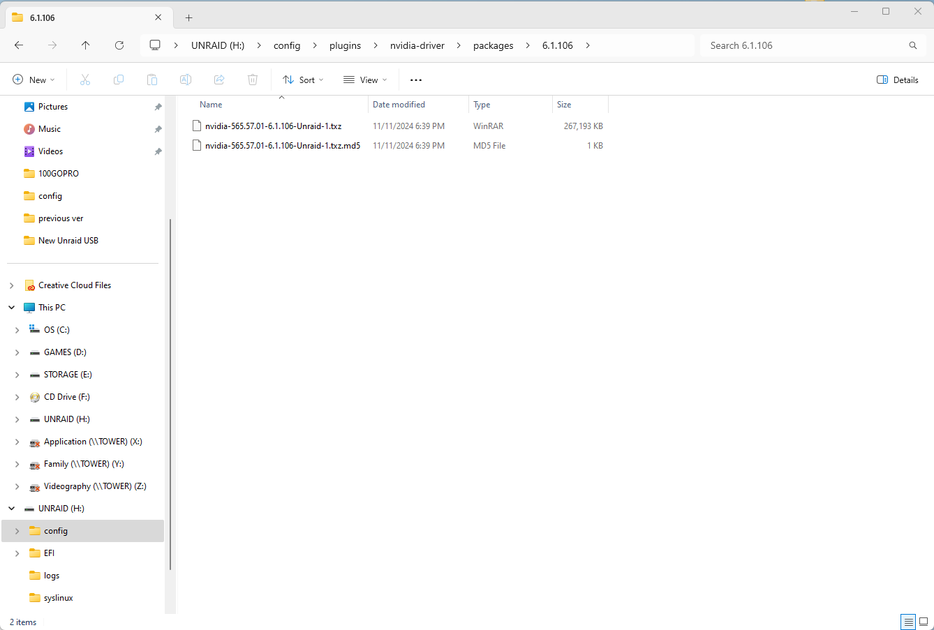

Having issues today trying to update my plugin version
root@tower:~# /usr/local/emhttp/plugins/nvidia-driver/include/exec.sh update_version latest
| WARNING - WARNING - WARNING - WARNING - WARNING - WARNING - WARNING - WARNING
| Don't close this window with the red 'X' in the top right corner until the 'DONE' button is displayed!
----------------Downloading Nvidia Driver Package v470.239.06-----------------
---------This could take some time, please don't close this window!------------
/boot/config/plugins/nvidia-driver/packages/6.1.106/nvidia-470.239.06-6.1.106-Unraid-1.txz
nvidia-550.107.02-6.1.106-Unraid-1.txz
nvidia-550.120-6.1.106-Unraid-1.txz
nvidia-550.127.05-6.1.106-Unraid-1.txz
nvidia-560.35.03-6.1.106-Unraid-1.txz
nvidia-565.57.01-6.1.106-Unraid-1.txz: Invalid argument
---------------Can't download Nvidia Driver Package v470.239.06----------------
root@tower:~# /usr/local/emhttp/plugins/nvidia-driver/include/exec.sh update_version latest_prb
root@tower:~# ll /boot/config/plugins/nvidia-driver/packages/6.1.106
total 243M
-rw------- 1 root   33 Aug 22 00:26 nvidia-560.35.03-6.1.106-Unraid-1.txz.md5
-rw------- 1 root 243M Aug 22 00:26 nvidia-560.35.03-6.1.106-Unraid-1.txz
drwx------ 2 root  16K Sep  6 07:40 ./
drwx------ 3 root  16K Sep  6 07:40 ../
total 48K
drwx------ 2 root 16K Sep  6 07:40 6.1.106/
drwx------ 3 root 16K Sep  6 07:40 ./
drwx------ 3 root 16K Nov 18 19:35 ../
The plugin is broken, you‘ll see that on the two php warnings on the page.
Please do the following:
  1. Uninstall the Nvidia driver plugin,
  2. Reboot
  3. Pull a fresh copy from the CA App
  4. Go to the Nvidida Plugins website and slelct the driver that you want to use
  5. Reboot again
@ich777 Thank you! The provided steps & guidance worked.

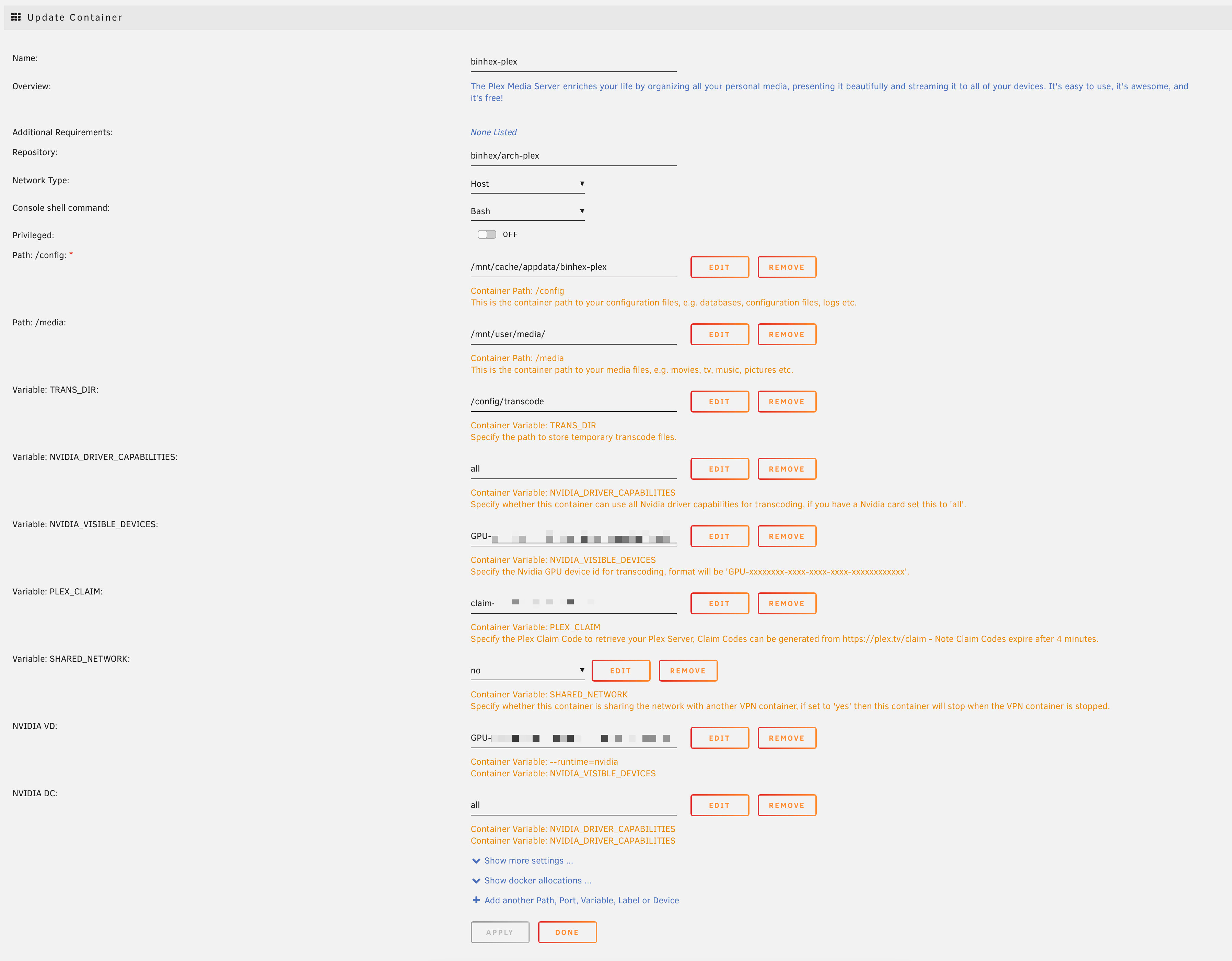

Hello All,
HW transcode not working.
  • PMS Version 1.41.2.9200
  • Followed ICH777 instructions above
  • "Installation of Nvidia driver v565.57.01 successful"
  • GPUID in Plex docker config matches Nvidia plugin info
  • nvidia-smi sees the GPU
  • NVIDIA_VISIBLE_DEVICES added
  • I don't see any place to add:  '--runtime=nvidia' to the 'Extra Parameters
But HW transcode is not working:
Nov 22, 2024 17:35:47.787 [22699250924344] ERROR - [Req#2bd/Transcode] [FFMPEG] - Cannot load libnvidia-encode.so.1
Nov 22, 2024 17:35:47.787 [22699250924344] ERROR - [Req#2bd/Transcode] [FFMPEG] - The minimum required Nvidia driver for nvenc is 455.28 or newer
Edited by Bladedude
this looks more like an issue with your docker, which one are you using ?
and which driver version is installed on the host ?
PlexInc. Repository plexinc/pms-docker:latest
From Nvidia driver plugin: Nvidia Driver Version: 565.57.01
looking good, may post your docker run <<click<< here and also may look at the plex forums if there are any issues with the latest update ... they are currently working on the transcoder engine.
Works now. I was missing "NVIDIA_DRIVER_CAPABILITIES" parameter.
However, when I set this up 2 months ago, I didn't have that parameter. I was following a YT from AlienTech, but this guide is much better.
And I still can't find where to add '--runtime=nvidia' to the 'Extra Parameters'" to complete all the documented steps from the guide.
docker run
  -d
  --name='Plex-Media-Server'
  --net='host'
  --pids-limit 2048
  -e TZ="America/Los_Angeles"
  -e HOST_OS="Unraid"
  -e HOST_HOSTNAME="supermicro"
  -e HOST_CONTAINERNAME="Plex-Media-Server"
  -e 'PLEX_CLAIM'='Insert Token from https://plex.tv/claim'
  -e 'PLEX_UID'='99'
  -e 'PLEX_GID'='100'
  -e 'VERSION'='latest'
  -e 'NVIDIA_VISIBLE_DEVICES'='GPU-XXX'
  -e 'NVIDIA_DRIVER_CAPABILITIES'='all'
  -l net.unraid.docker.webui='http://[IP]:[PORT:32400]/web'
  -l net.unraid.docker.icon='https://raw.githubusercontent.com/plexinc/pms-docker/master/img/plex-server.png'
  -v '/mnt/user/data/media':'/data/media':'rw'
  -v '/dev/shm':'/transcode':'rw'
  -v '/mnt/user/appdata/Plex-Media-Server':'/config':'rw'
  --runtime=nvidia 'plexinc/pms-docker'
The command finished successfully!
Edited by Bladedude
Did you follow this tutorial:
You have to enable Advanced View in the Docker template at the top right.
If this parameter is not present it shouldn‘t work.
Yes. I followed the tutorial.
Ah OK. Once Advanced View was enabled, I saw that I had already added "--runtime=nvidia" during initial setup.
Today I noticed HW transcode wasn't working, but had been working 1-2 months ago, so I:
1. Uninstalled, reinstalled the Nvidia plugin, and installed the latest Nvidia driver. No change, same Plex error in log
2. Followed the tutorial, and added NVIDIA_DRIVER_CAPABILITIES parameter. HW transcode works.
Not sure how HW transcode was working on initial setup w/o NVIDIA_DRIVER_CAPABILITIES set..
Edited by Bladedude
So it still isn‘t working?
Please post your Diagnostics.
It's working now, since I added NVIDIA_DRIVER_CAPABILITIES.
