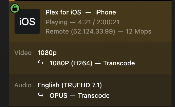

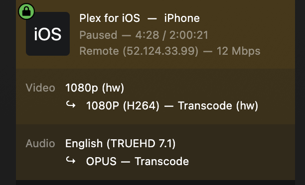

  4. It's working now, since I added NVIDIA_DRIVER_CAPABILITIES.
  5. Yes. I followed the tutorial. Ah OK. Once Advanced View was enabled, I saw that I had already added "--runtime=nvidia" during initial setup. Today I noticed HW transcode wasn't working, but had been working 1-2 months ago, so I: 1. Uninstalled, reinstalled the Nvidia plugin, and installed the latest Nvidia driver. No change, same Plex error in log 2. Followed the tutorial, and added NVIDIA_DRIVER_CAPABILITIES parameter. HW transcode works. Not sure how HW transcode was working on initial setup w/o NVIDIA_DRIVER_CAPABILITIES set..
  6. Works now. I was missing "NVIDIA_DRIVER_CAPABILITIES" parameter. However, when I set this up 2 months ago, I didn't have that parameter. I was following a YT from AlienTech, but this guide is much better. And I still can't find where to add '--runtime=nvidia' to the 'Extra Parameters'" to complete all the documented steps from the guide. docker run -d --name='Plex-Media-Server' --net='host' --pids-limit 2048 -e TZ="America/Los_Angeles" -e HOST_OS="Unraid" -e HOST_HOSTNAME="supermicro" -e HOST_CONTAINERNAME="Plex-Media-Server" -e 'PLEX_CLAIM'='Insert Token from https://plex.tv/claim' -e 'PLEX_UID'='99' -e 'PLEX_GID'='100' -e 'VERSION'='latest' -e 'NVIDIA_VISIBLE_DEVICES'='GPU-XXX' -e 'NVIDIA_DRIVER_CAPABILITIES'='all' -l net.unraid.docker.managed=dockerman -l net.unraid.docker.webui='http://[IP]:[PORT:32400]/web' -l net.unraid.docker.icon='https://raw.githubusercontent.com/plexinc/pms-docker/master/img/plex-server.png' -v '/mnt/user/data/media':'/data/media':'rw' -v '/dev/shm':'/transcode':'rw' -v '/mnt/user/appdata/Plex-Media-Server':'/config':'rw' --runtime=nvidia 'plexinc/pms-docker' The command finished successfully!
  7. PlexInc. Repository plexinc/pms-docker:latest From Nvidia driver plugin: Nvidia Driver Version: 565.57.01
  8. Hello All, HW transcode not working. PMS Version 1.41.2.9200 Followed ICH777 instructions above "Installation of Nvidia driver v565.57.01 successful" GPUID in Plex docker config matches Nvidia plugin info nvidia-smi sees the GPU NVIDIA_VISIBLE_DEVICES added I don't see any place to add: '--runtime=nvidia' to the 'Extra Parameters But HW transcode is not working: Nov 22, 2024 17:35:47.787 [22699250924344] ERROR - [Req#2bd/Transcode] [FFMPEG] - Cannot load libnvidia-encode.so.1 Nov 22, 2024 17:35:47.787 [22699250924344] ERROR - [Req#2bd/Transcode] [FFMPEG] - The minimum required Nvidia driver for nvenc is 455.28 or newer
