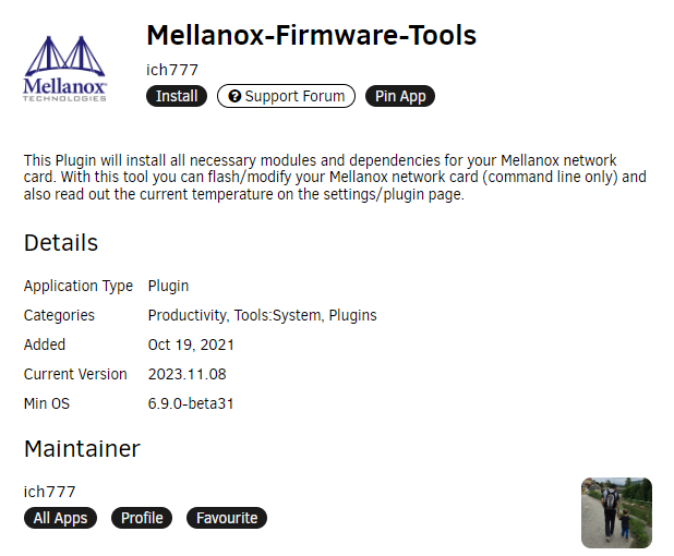

For anyone who doesn't have easy access to a Windows machine for the easy updates/configuration changes, you can pass the card through to a VM and do it from there without using a separate computer. You won't see it back in unRAID network settings until you "unstub" the card though, removing it from the VM. I also rebooted my entire unRAID server rather than just the VM when Windows said that was needed for the card changes to take effect.
