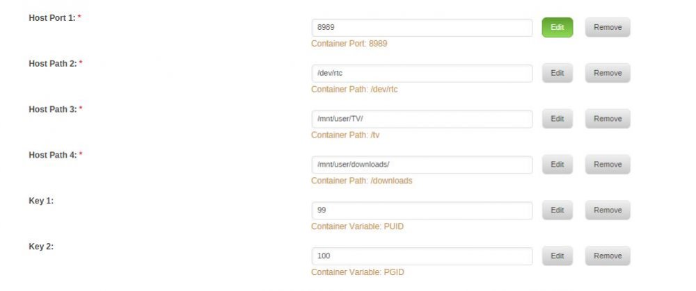

  4. You're right. And that actually fixed it. I'm not sure I understand why though. Using both /mnt/cache/appdata/ and /mnt/cache/appdata/sonarr/ made it create the path: /mnt/cache/appdata/sonarr/ Thanks for the help!
  5. I made that change and the run command is now: /plugins/dynamix.docker.manager/scripts/docker create --name="sonarr" --net="bridge" -e TZ="America/New_York" -e HOST_OS="unRAID" -e "PUID"="99" -e "PGID"="100" -p 8989:8989/tcp -v "/dev/rtc":"/dev/rtc":ro -v "/mnt/user/TV/":"/tv":rw -v "/mnt/user/downloads/":"/downloads":rw -v "/mnt/cache/appdata/":"/config":rw linuxserver/sonarr and the AppData Config Path is now: /mnt/cache/appdata/ I'm still getting the error: [Info] Bootstrap: Starting Sonarr - /opt/NzbDrone/NzbDrone.exe - Version 2.0.0.4689[Info] AppFolderInfo: Data directory is being overridden to [/config][Info] MigrationLogger: *** Migrating data source=/config/nzbdrone.db;cache size=-10485760;datetimekind=Utc;journal mode=Wal;pooling=True;version=3 ***[Fatal] ConsoleApp: EPIC FAIL![v2.0.0.4689] NzbDrone.Core.Datastore.CorruptDatabaseException: Database file: /config/nzbdrone.db is corrupt, restore from backup if available. See: https://github.com/Sonarr/Sonarr/wiki/FAQ#i-am-getting-an-error-database-disk-image-is-malformed ---> System.Data.SQLite.SQLiteException: disk I/O errordisk I/O errorat System.Data.SQLite.SQLite3.Prepare (System.Data.SQLite.SQLiteConnection cnn, System.String strSql, System.Data.SQLite.SQLiteStatement previous, System.UInt32 timeoutMS, System.String& strRemain) [0x0033c] in <61a20cde294d4a3eb43b9d9f6284613b>:0at System.Data.SQLite.SQLiteCommand.BuildNextCommand () [0x00068] in <61a20cde294d4a3eb43b9d9f6284613b>:0--- End of inner exception stack trace ---at NzbDrone.Core.Datastore.DbFactory.Create (NzbDrone.Core.Datastore.Migration.Framework.MigrationContext migrationContext) [0x00121] in M:\BuildAgent\work\b69c1fe19bfc2c38\src\NzbDrone.Core\Datastore\DbFactory.cs:116at NzbDrone.Core.Datastore.DbFactory.Create (NzbDrone.Core.Datastore.Migration.Framework.MigrationType migrationType) [0x00000] in M:\BuildAgent\work\b69c1fe19bfc2c38\src\NzbDrone.Core\Datastore\DbFactory.cs:56at NzbDrone.Core.Datastore.DbFactory.RegisterDatabase (NzbDrone.Common.Composition.IContainer container) [0x00000] in M:\BuildAgent\work\b69c1fe19bfc2c38\src\NzbDrone.Core\Datastore\DbFactory.cs:36at NzbDrone.Host.Bootstrap.Start (NzbDrone.Host.ApplicationModes applicationModes, NzbDrone.Common.EnvironmentInfo.StartupContext startupContext) [0x0003d] in M:\BuildAgent\work\b69c1fe19bfc2c38\src\NzbDrone.Host\Bootstrap.cs:73at NzbDrone.Host.Bootstrap.Start (NzbDrone.Common.EnvironmentInfo.StartupContext startupContext, NzbDrone.Host.IUserAlert userAlert, System.Action`1[T] startCallback) [0x00075] in M:\BuildAgent\work\b69c1fe19bfc2c38\src\NzbDrone.Host\Bootstrap.cs:40at NzbDrone.Console.ConsoleApp.Main (System.String[] args) [0x0000e] in M:\BuildAgent\work\b69c1fe19bfc2c38\src\NzbDrone.Console\ConsoleApp.cs:20Press enter to exit... Before I started the docker back up I deleted the previously created sonarr folder in appdata. After starting the docker here is what the permissions look like. Does that look correct? root@Tower:/mnt/cache/appdata# ls -al total 16 drwxrwxrwx 1 nobody users 52 May 5 13:42 ./ drwxrwxrwx 1 nobody users 58 May 4 17:29 ../ drwxr-xr-x 1 nobody users 134 May 5 13:42 sonarr/ Thanks for the help!
  6. Here is the docker run command: /plugins/dynamix.docker.manager/scripts/docker create --name="sonarr" --net="bridge" -e TZ="America/New_York" -e HOST_OS="unRAID" -e "PUID"="99" -e "PGID"="100" -p 8989:8989/tcp -v "/dev/rtc":"/dev/rtc":ro -v "/mnt/user/TV/":"/tv":rw -v "/mnt/user/downloads/":"/downloads":rw -v "/mnt/user/appdata/sonarr":"/config":rw linuxserver/sonarr
  7. I just tried installing this docker fresh and I'm getting the error below. I've attached a screenshot of my config. Any idea? Thanks for the help! [Info] Bootstrap: Starting Sonarr - /opt/NzbDrone/NzbDrone.exe - Version 2.0.0.4689 [Info] AppFolderInfo: Data directory is being overridden to [/config] [Info] MigrationLogger: *** Migrating data source=/config/nzbdrone.db;cache size=-10485760;datetimekind=Utc;journal mode=Wal;pooling=True;version=3 *** [Fatal] ConsoleApp: EPIC FAIL! [v2.0.0.4689] NzbDrone.Core.Datastore.CorruptDatabaseException: Database file: /config/nzbdrone.db is corrupt, restore from backup if available. See: https://github.com/Sonarr/Sonarr/wiki/FAQ#i-am-getting-an-error-database-disk-image-is-malformed ---> System.Data.SQLite.SQLiteException: disk I/O error disk I/O error at System.Data.SQLite.SQLite3.Prepare (System.Data.SQLite.SQLiteConnection cnn, System.String strSql, System.Data.SQLite.SQLiteStatement previous, System.UInt32 timeoutMS, System.String& strRemain) [0x0033c] in <61a20cde294d4a3eb43b9d9f6284613b>:0 at System.Data.SQLite.SQLiteCommand.BuildNextCommand () [0x00068] in <61a20cde294d4a3eb43b9d9f6284613b>:0 --- End of inner exception stack trace --- at NzbDrone.Core.Datastore.DbFactory.Create (NzbDrone.Core.Datastore.Migration.Framework.MigrationContext migrationContext) [0x00121] in M:\BuildAgent\work\b69c1fe19bfc2c38\src\NzbDrone.Core\Datastore\DbFactory.cs:116 at NzbDrone.Core.Datastore.DbFactory.Create (NzbDrone.Core.Datastore.Migration.Framework.MigrationType migrationType) [0x00000] in M:\BuildAgent\work\b69c1fe19bfc2c38\src\NzbDrone.Core\Datastore\DbFactory.cs:56 at NzbDrone.Core.Datastore.DbFactory.RegisterDatabase (NzbDrone.Common.Composition.IContainer container) [0x00000] in M:\BuildAgent\work\b69c1fe19bfc2c38\src\NzbDrone.Core\Datastore\DbFactory.cs:36 at NzbDrone.Host.Bootstrap.Start (NzbDrone.Host.ApplicationModes applicationModes, NzbDrone.Common.EnvironmentInfo.StartupContext startupContext) [0x0003d] in M:\BuildAgent\work\b69c1fe19bfc2c38\src\NzbDrone.Host\Bootstrap.cs:73 at NzbDrone.Host.Bootstrap.Start (NzbDrone.Common.EnvironmentInfo.StartupContext startupContext, NzbDrone.Host.IUserAlert userAlert, System.Action`1[T] startCallback) [0x00075] in M:\BuildAgent\work\b69c1fe19bfc2c38\src\NzbDrone.Host\Bootstrap.cs:40 at NzbDrone.Console.ConsoleApp.Main (System.String[] args) [0x0000e] in M:\BuildAgent\work\b69c1fe19bfc2c38\src\NzbDrone.Console\ConsoleApp.cs:20 Press enter to exit...
