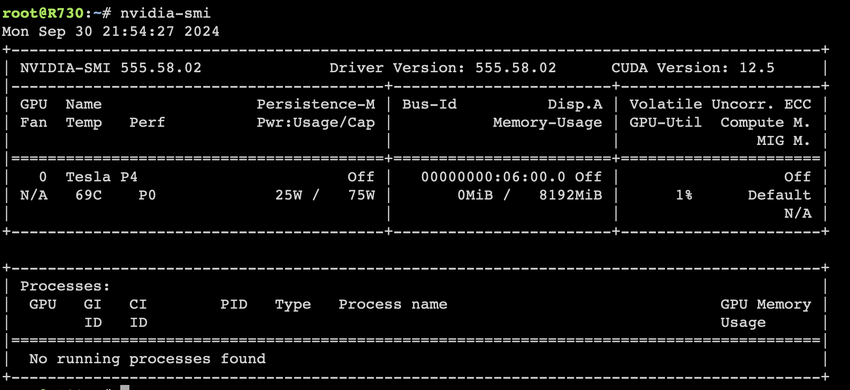

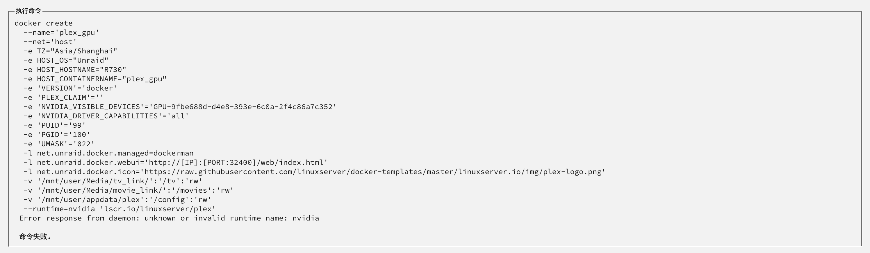

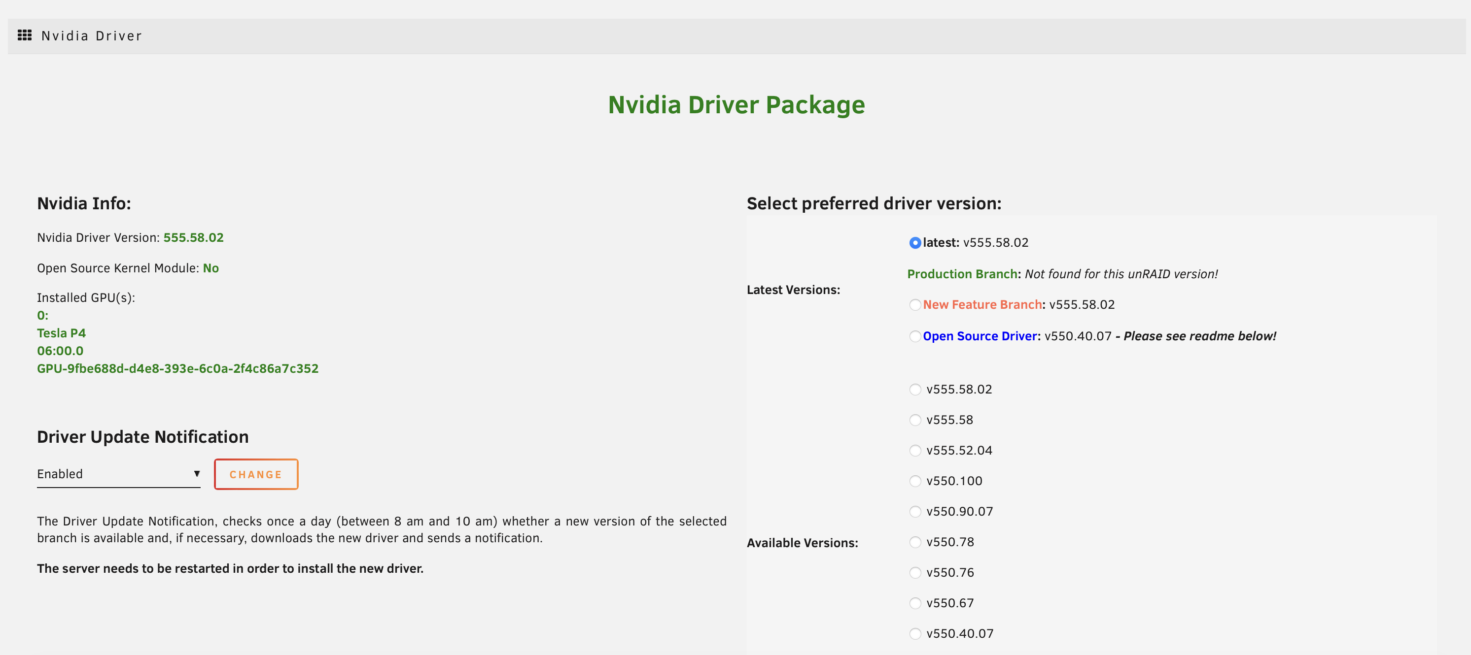

I initially installed the plugin and correctly modified the container settings, and the GPU could be used properly. However, after I rebooted the Unraid server, the containers using the GPU could not be started, with the following error: 'Error response from daemon: unknown or invalid runtime name: nvidia.' (also can be seen in the screenshots below).
I tried changing 'Enable Docker' from 'Yes' to 'No' and 'No' to 'Yes,' but it still didn't work. The plugin page shows as usual, and the nvidia-smi command returns results, but containers using the GPU still cannot be started.
Thank you for your support, please let me know if you need any further information!
Please post your Diagnostics, it is really hard to troubleshoot without them.
